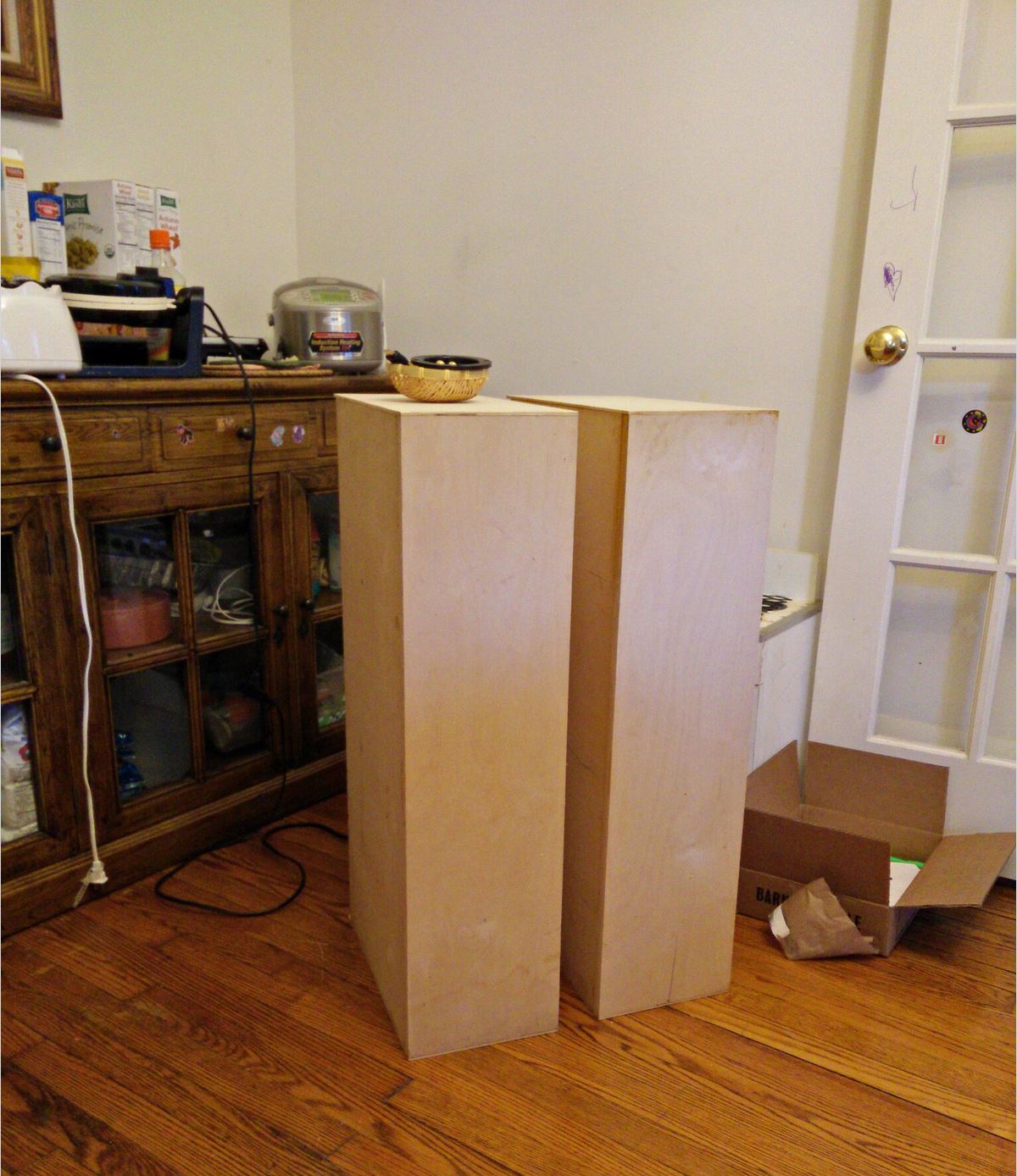

New 3-way project with dual Anarchy 6.5" woofers - in the early stages, boxes glued..
I'll be making a speaker with two 6.5" "Anarchy" woofers per enclosure.
In determining how high each is placed on the front baffle my primary concern is reduction of floor bounce cancellation, which of course, complicates things because the woofers will need to be crossover higher than ideal from a "localization" perspective, since the primary FBC node may be around 200Hz... The midrance will be located just above the dual woofer enclosure in it's own enclosure - so, say around 36" approximately.
The dimensions of the [already built] enclosures are:
33-3/8" Tall, 15-7/8" Deep, and, 8.5" Wide
The walls of the enclosure are 11/16" thick at this point, but I anticipate adding constrained layer damping inside, and, they will be well braced.
Any suggestions or comments?

With a 200Hz crossover or baffle step boost from the woofers, 17" is the quarter wave limit for C-to-C mid-to-woofers. Most commercial TMWW speakers position the upper woofer just a few inches below the midrange in order to position the lower woofer "close to" a quarter wave. In order to move the floor bounce effect down lower in frequency, the lower woofer needs to be centered ~9" and that still puts the upper woofer center ~17.5" where it will push up the floor bounce frequency to about the same level as a 24" center upper woofer. Two stacked Anarchy woofers will have one woofer high enough up on the baffle to muck up the midrange.
With an 8.5" wide baffle, rear and side wall distances can have a larger effect on SPL.

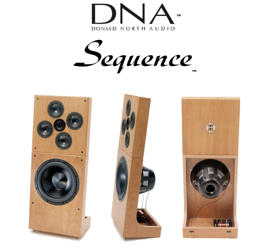

CharlieLaub, what do you make of Donald North's patented 'lazy x' array, as seen in DN Audio 'Sequence' loudspeaker? Do we have a name for this array? 'Double D'Appolito'? 'Lazy X'?
Here's the patent
from the patent:
"The geometric relationship between the woofers as shown in the embodiment 300 of FIG. 3 results in a sound field which maximizes the energy lobes directed toward the listener and minimizes the severity of the energy lobes directed towards reflecting surfaces and room boundaries. The embodiment reduces the severity of the magnitude of the side lobes through an advantageous arrangement of transducers, which minimizes the alignment of transducers along horizontal or vertical axes. Alignment of transducers along an axis results in severe standing wave interference of the sound waves from the transducers in alignment. As previously mentioned, a feature of the embodiment of 300 is that no two centers of the woofers align either horizontally or vertically."
