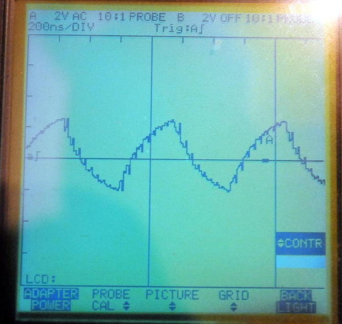

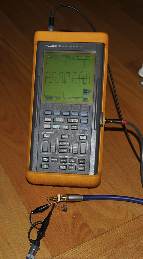

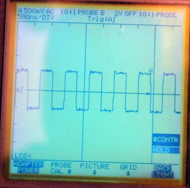

Yes, the Lampizator testing setup was faulty, as he measured the output unloaded. I did this mod on my CEC TL0 and preferred the original sound. When loaded, the output is also picture perfect.
I don't see any reason to change the motor there, as we know, looks can be deceiving😉
Perhaps Romy the Cat best described Lampizator methology: http://www.goodsoundclub.com/Forums/ShowPost.aspx?postID=2134
Attached are the pics of TL0 original output, spdif direct as per Lampizator mod) and original output loaded.

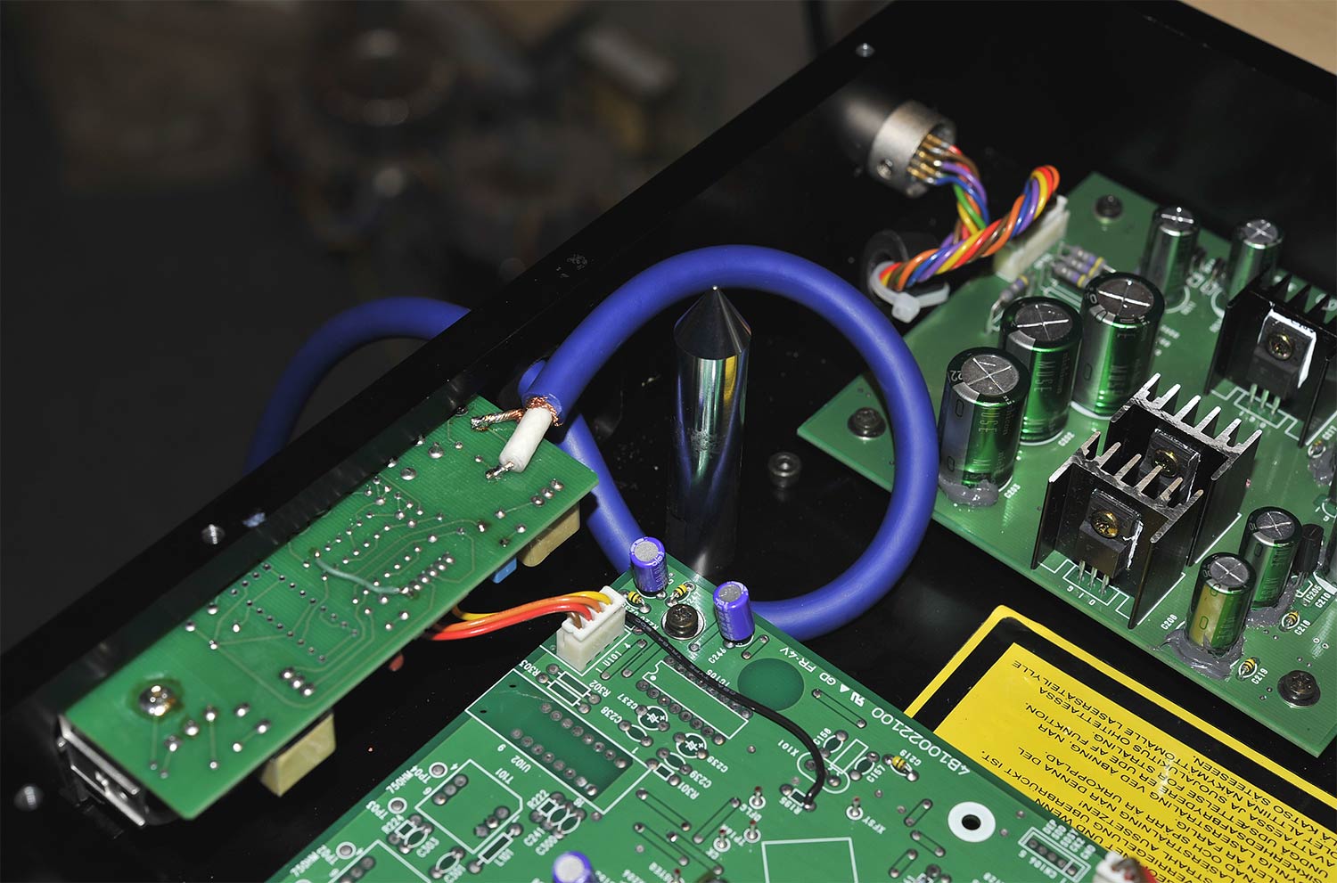

As posted in a previous link, the modded transport was a "bit annoying and thin sounding” and the default configuration “produced sounds that are better defined in space". With a mod, the transparency and ambience seemed to be improved, however, at the cost of other performance aspects.
I was looking inside the transport for last 3 days, even did the mod described on Russian site were laser and decoder are powered from separate supplies which supposed to improve discs reading, but it didn't produce expected results: http://translate.google.com/transla...rade/CEC_TL0.html&rurl=translate.google.com#9
If the tranport sounds good, and mine does, I would be very hesitant to swap any parts. IIRC, Romy was trying to replace diodes and didn't find any improvement, same for the dedicated clock.
Both TL1 and TL0 seem to have same main boards, just slightly different grade of parts. The main difference seem to be in mechanical construction.
As to my transport, in the end I only removed output RCA and connected Belkin Synapse interconnect directly to output board (bypassing the output coupling cap). This improved transparency a bit, but overall sound character remained the same.
