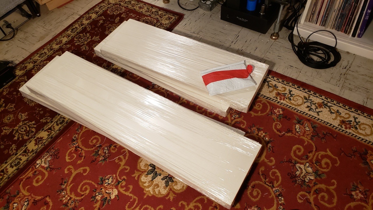

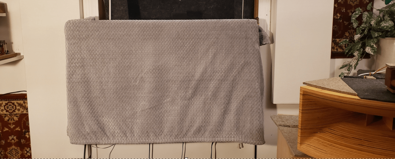

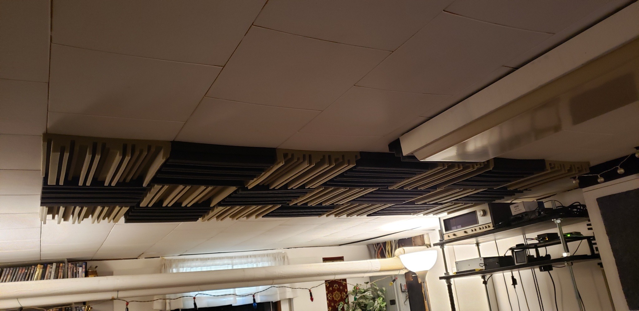

I had these guys build me a bunch of acoustic absorber panels and I have ceiling treatment as well. These are economical and quite effective. I have mostly 2 inch but a few 1 inch as well.
https://www.acoustimac.com
They are both acoustically effective and a bargain compared to almost anything else I have looked at. You can get them direct, and made to order or generic on Amazon with pretty quick shipping.
My man cave is a combination of listening space, electronics lab bench and small machine shop in an ancient basement room. A lot going on. Acoustics were OK until I upgraded to Yuichi A-290 horns which have wider dispersion than the horns they replaced. All of the treatments were installed as a result of that upgrade. I will take some pix and share.
The room, like yours, is my retreat from the world.
