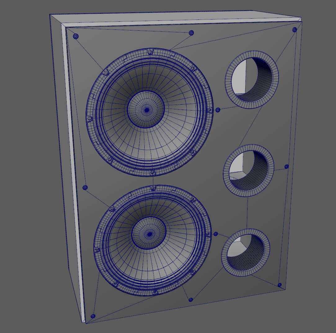

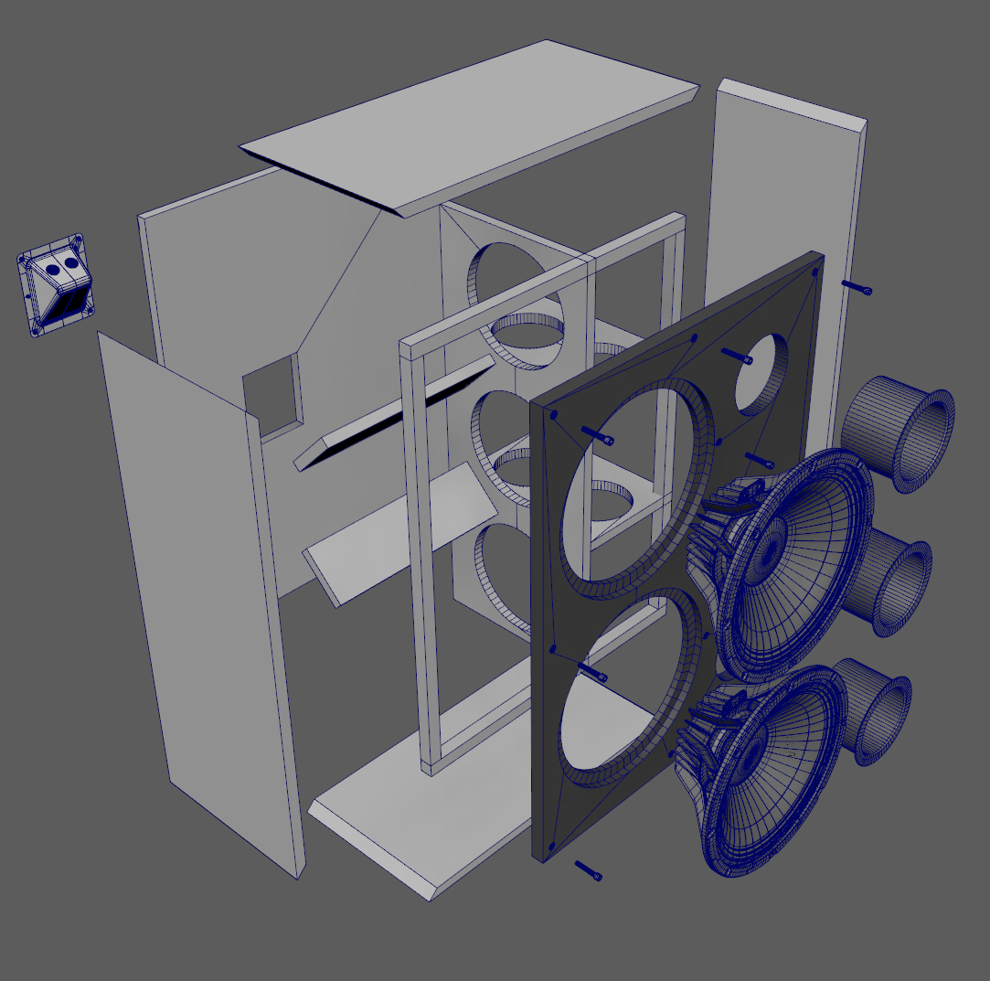

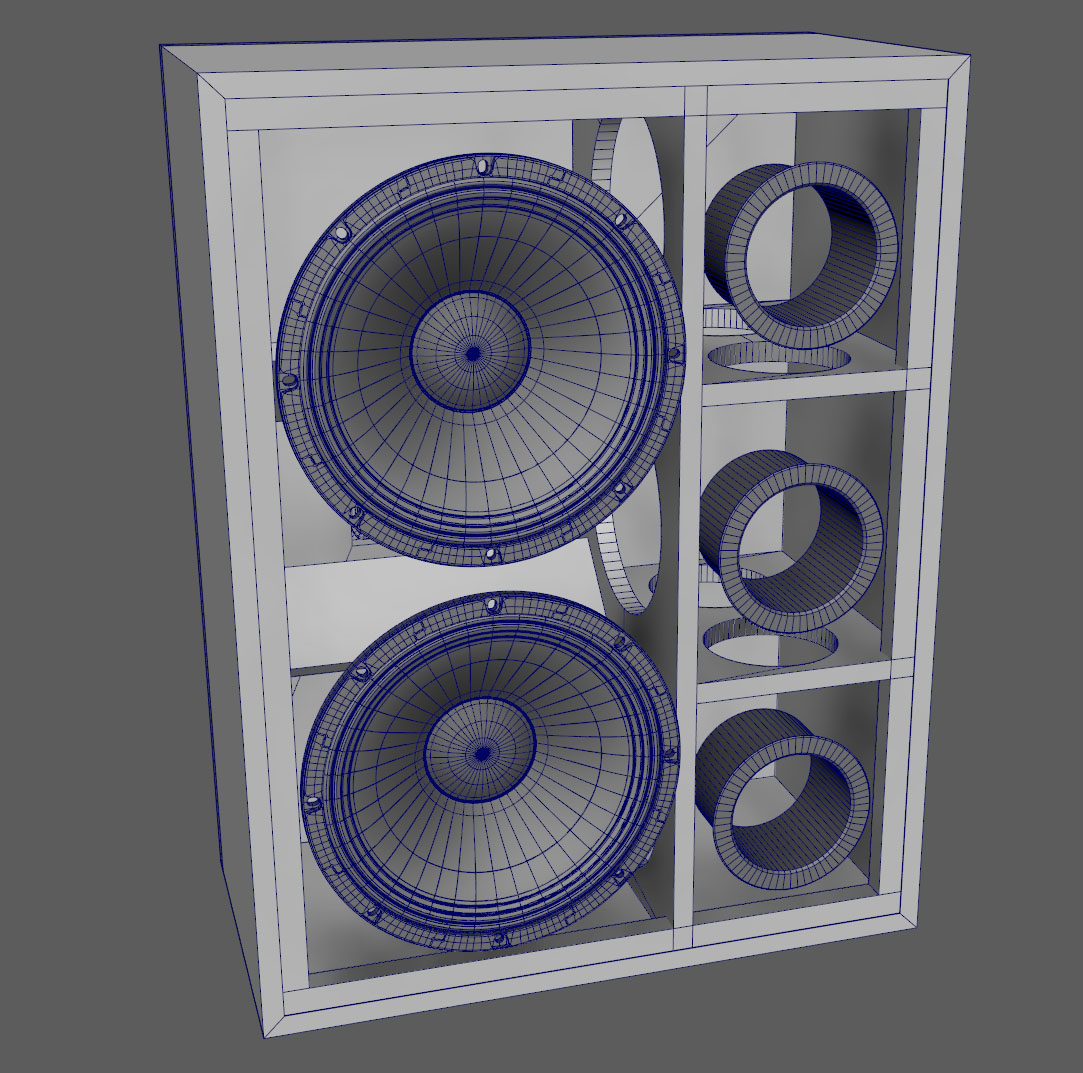

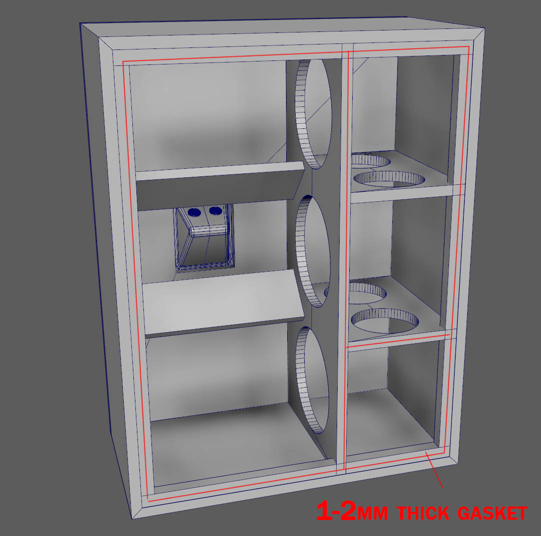

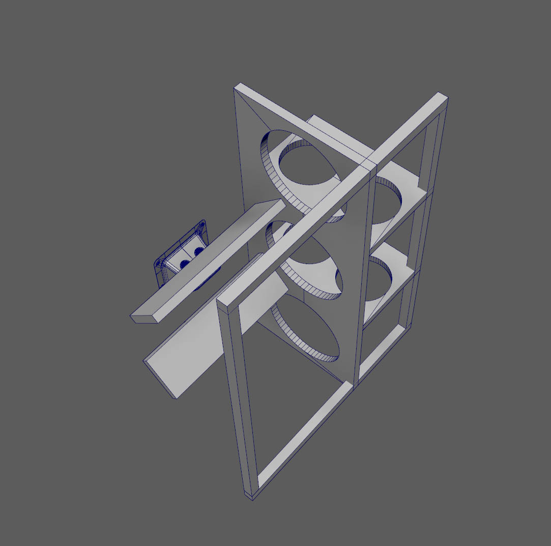

Hello. I have two faital 120pr300 8 ohm drivers. I'm going to make some custom cabinet 212. I need to help from you! I allready have some plans for construction. That will be my first custom cabinet.
I'm attaching some plans. (preffer nice look over mobility)
I have done some calculations in WinISD.
Volume 100l
Tuning freq: 55,05hz

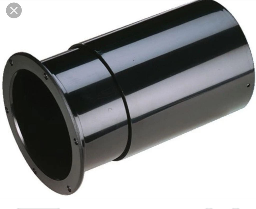

Vents: 3 vents, diameter 11.00 cm vent length 20.1 cm
at System input power 300W air velocity 50hz: 16 m/s
Wonder also about:
110l
3 vents: 11.00 diameter 17,53 lengths
I'm doing it right?

Seem to, though based on published specs the classic 110 L tuned to Fs would be my choice.
Re [3] vents. For 50 Hz Fb, Hornresp calculates a 19 m/sec vent mach at only 150 W with a single 8"/20.31 cm i.d. pipe [324.66 cm^2] x 7.44"/18.9 cm, so question WinISD's 16 m/sec @ 300 W with less total area [3x 11 cm dia. = 285.1 cm^2] AND shorter since multiples of the same area as a single pipe will need to be longer.
