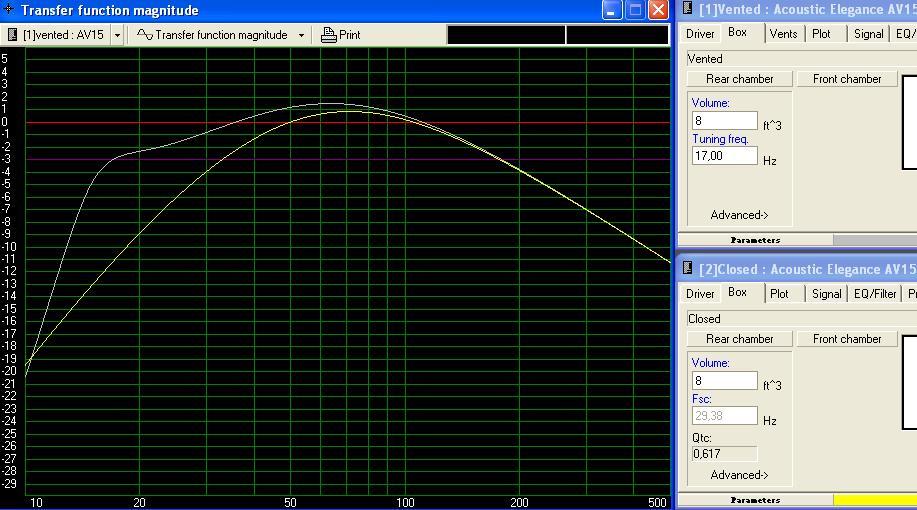

You picked a nice tuning point, but your box is too large, that's why you see a peak in the frequency response.
Here's how you could avoid it, I show you two AV15, one sealed and one ported, in the same size enclosure (8 cu.ft) :
