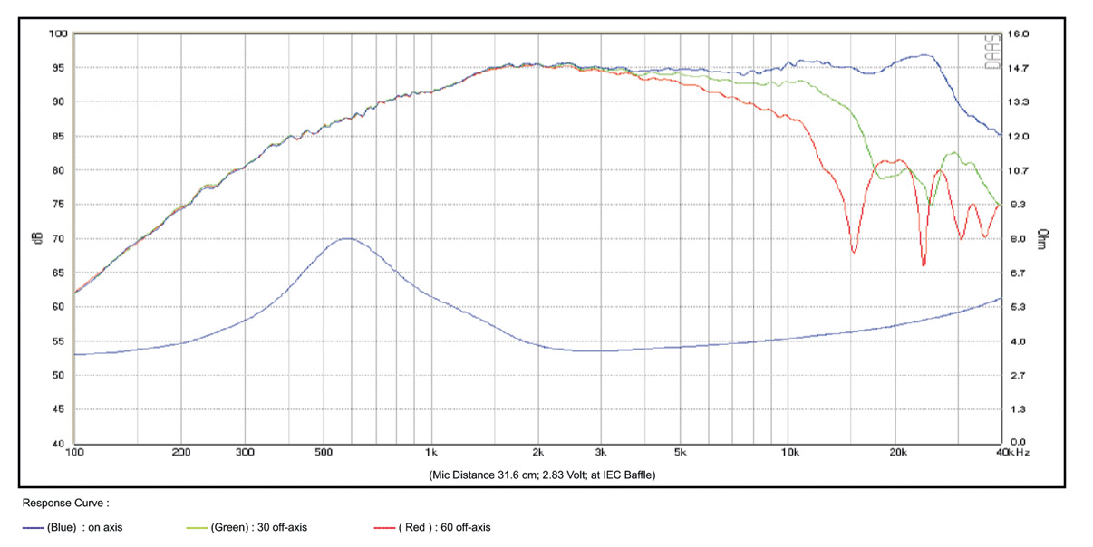

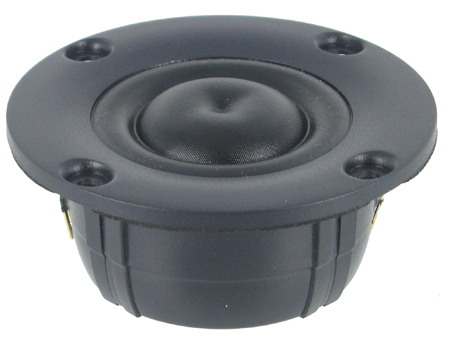

The SB29RDCN-C004 is a small 94 db/watt tweeter that I use with my butchered W8-1808 on a sealed speaker crossed LR4 at 1400 Hz. I also use a DIY dipole ribbon that is 0.7" wide and 4" long, also crossed LR4 at 1400Hz, with the W8 plus two Lambda TD15 dipole woofers in an H-frame.
For your current design, the Fountek JP3.0 ribbon mentioned earliler would be a good choice for a 12K+ Hz crossover point. Ribbons add a nice level of fast, light high frequency detail. At 8K+ Hz, I favor ribbons over small domes. I would not use a horn super tweeter like the Fostex unless you had a horn tweeter.
