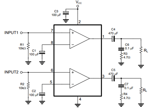

I built this circuit with a TDA2822M, without connecting anything to the input. and with the volume at minimum (pulldown to GND) and connecting the headphones white noise is heard.
Can you show us the exact setup used, with the PCB layout?? 9V battery?
Entirely to be expected given the DS specs for the TDA. You don't need that 39dB of gain in this application, given the output of the AD9833 is about 200mV and the HPs need about 1V max. Hence 14dB gain is quite sufficient but even with an optimal gain structure, the bottleneck is the -60dB quantization noise of the AD9833.I built this circuit with a TDA2822M, without connecting anything to the input. and with the volume at minimum (pulldown to GND) and connecting the headphones white noise is heard.

Sure, I understand that the gain is a lot.Entirely to be expected given the DS specs for the TDA. You don't need that 39dB of gain in this application, given the output of the AD9833 is about 200mV and the HPs need about 1V max. Hence 14dB gain is quite sufficient but even with an optimal gain structure, the bottleneck is the -60dB quantization noise of the AD9833.
but first I would like to understand and solve the problem of the noise in the amplifier, before continuing with the rest.
and that the amplifier reaches 110db spl @32R
I need to connect the headphones to the amplifier circuit and not hear anything when it is in standby.
in all three circuits, with different ICs (TDA2822, TDA7052, PAM8403), I hear the same noise, like when a power amp is at maximum volume and you hear that noise like a wind.
in my tests I have only tested the amplifier circuit, without connecting the AD9833.
maybe I'm missing something. but I always build the circuit according to the data sheet of each one.

First off you'll need an amp that has less than the normal amount of gain (26dB would be typical), you want 14dB. This precludes use of pretty much any chipamp as their gain (and by extension, their noise) is too high. There are some chipamps which are configurable via software for lower gain but I would guess that complexity is something you'd wish to avoid.
So you're left with building an amp from chips which are going to support lower gain - the opamps which have already been mentioned (OPA1622, OPA1656) will work fine at 14dB as will TPA6120 and AD815 (which hasn't been mentioned). Or if you prefer to stick with a 'ready-rolled' chipamp with too high gain, you could use an output transformer to reduce the gain and the noise.

For hearing-loss? Audiometers "usually" generate tone at high level, then a calibrated passive pad to reduce to headphone level. The reasons are also historical. But you should not need and do not want ANY gain to measure hearing thresholds.I'm designing a portable audiometer
TDA2822 (and similar) run about 2uV and gain about 40dB or 1:100, making 200uV hiss at the output.
1mW in 32r= 0.18V=102dB SPL
200uV hiss
I get output hiss OTOO 43dB SPL?? (Somebody check that please.)
An undamaged young ear will hear 43dB SPL fairly easily even without a quiet room. (I'm sitting here about 30dB SPL but it is after midnight a mile out in the woods and there is a foot of snow all around which makes a real difference.) In many typical screening situation the ambient noise (traffic, blowers, etc) will exceed 43dB, perhaps by a lot. I don't think I hear 43dB SPL above 2kHz any more; my threshold rises past 50dB SPL.
If you are screening for hearing loss, 43dB SPL self-hiss is not a serious defect. (Audiologists don't reference SPL but the older HL scale.)

I was thinking just to knock up a super quick breadboard version or quick prototype using 'anything'... LM4562, even a TL071/2 Just try it and get a reference of how quiet you can can get with the phones connected. There is no point getting special devices and making a board for them if you are not going to achieve what you want.
