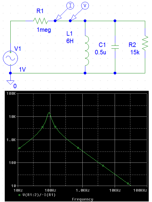

I have a small head amp that I have been testing, which currently uses a relatively large 30VA toroid as OPT.
The approximate reflected Z is about 15k, using 300R load to the secondary.
Primary volts swing is about 30V RMS, using the toroid (240:30V) - primary L= 6H and lossy capacitance is a whopping 0.5uF!
Turns ratio comes out to something like 6.7:1

PRR,
You may be correct, I recalled 0.5uF, but it may well have been 50nF, I was using a auto ranging handheld LCR meter I'm not all that familiar with. Will double check.
There is significant degradation in the THD with increasing frequency though, which I suppose is prompting my looking for a 'proper' OPT. It seems to load well up to a point, and my THD measures at 1kHz and 100Hz have been encouraging. It's just the 10kHz :D
I should make a spreadsheet to plot the transformer Impedance,
but "Reflected Z" I quote is based on the turns ratio, assuming I have calculated correctly.
What does surprise me is that I need such a small blocking capacitor, and have a good LF response.
Using a Agilent U173 LCR meter, incorrectly....
Hopefully now a little more sense...

PRR
Joined 2003
> much like the quality of responses like these.
Your data is bogus. Do not attack when this is pointed-out.
> I should really go and do that groundwork, but I'm lazy
Your life, your choice.
> I am not aware of an easy way to measure a transformer, without a £££s network analyser
Signal generator. Resistor. Audio voltmeter.
