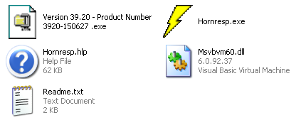

Setup.exe is a self-extracting zip file. It should not be necessary to have WinZip or similar installed.

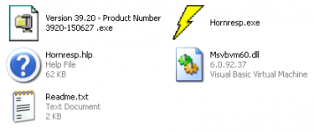

1. Double-click on the Setup.exe filename in Windows Explorer.
2. Click the Unzip button when the attached form is displayed.
Files Hornresp.exe, Hornresp.hlp, Msvbvm60.dll and Readme.txt should be saved to the C:\Hornresp folder.
I strongly recommend that the default C:\Hornresp folder be used, and that existing files are allowed to be overwritten. There is no reason to keep earlier versions of Hornresp.

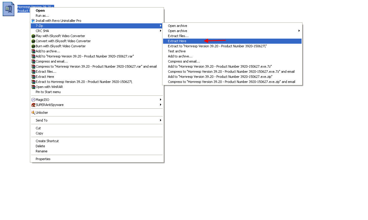

opened 7zip and extracted setup into the same folder
ran setup. .
Yet again it says winzip self extractor, but this time it extracted correctly.

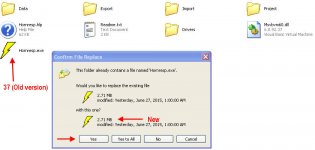

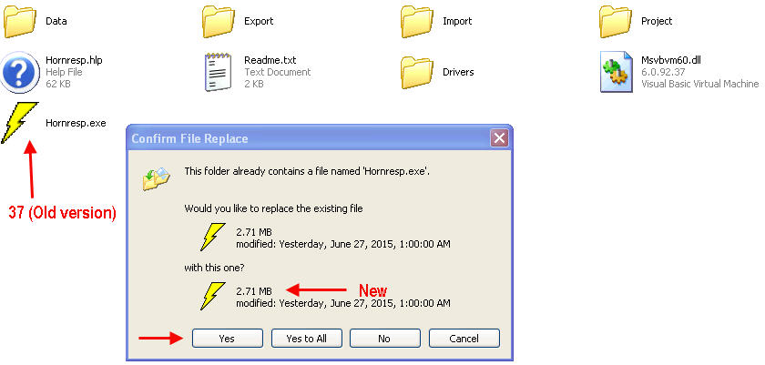

Is there any chance that you are perhaps trying to install the updated version of Hornresp while your existing version is running?
If so, then you will get the attached message when the WinZip Self-Extractor Unzip button is clicked.
