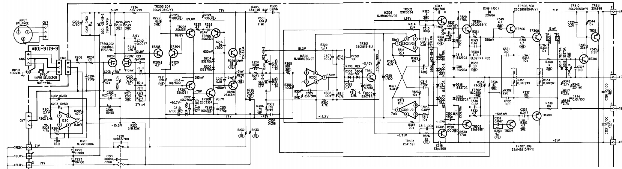

I'm attaching a scan of the circuit diagram of my power amp.
I'm looking for some improvments to more sonic / warmth sound (suggestions / tips and Comments welcome).
E.g. what would be happend if remove IC301 and IC302 ? Sound ? Risk ?
BTW I know not a lot about amp designs 😱

Dear Marcus,
I assume that you will have no risk removing the IC301, IC302 chips but I am confident the amp will not work any more until you put them back in.
Not knowing the amp in question (model and manufacturer might make more interest in your post), I cant say its worth it, as excellent amplifiers exist very cheap on the second hand market.
This said, if your amp is old (say greater than 5-10 years), replacing all the electrolytic capacitors is almost always a good move. I would start with the biggest ones, and any that are bulging. Look for low ESR ones if the amp is a quality high end item, but cheap capacitors will be fine for most amps. I have done this with Quad 303 amps, which where last serviced in the 1970's and the effect is most noticeably better.
Electrolytic capacitors age poorly, and simply replacing them with slightly larger values, in maximum voltage is a good place to start, For power supplies I often also increase the capacitance also (some times I even double it) but stick with the old values if you don't understand what the capacitor is doing to the rest of the circuit. Also please note the polarity of the electrolytic capacitor you replace, as you can expect things to break if you get this the wrong way around.
In general I would not modify any commercial amplifier design by much. I defiantly would not do big changes like removing components. Substitution is usually the most I would do as amplifiers are a system, and designed with all parts, and usually the minimum needed to make the system work.
Some people do op amp upgrades (the chips you pointed out look like op amps) but you will have to understand what your doing as their are many possible ways this can go wrong, typically high frequency instability, most often above the limit of hearing, and this should not be done without suitable test equipment and knowledge in my opinion. I am sure some op amp "upgrades" published on the internet are actually making things worse.
Stick to good amps from good brands, and typically all you need/should do is replace all the electrolytic capacitors unless your an engineer, or better still an electrical engineer.
In priciple you're on the right track, in that I would expect an amp with so convoluted a signal path to lose a lot of sound clarity. What comes out of an analog stage cannot be better than what went in -but it can of course be worse- and when so many stages of amplification are involved in the power amp alone..
If you want to try some mods like removing apparently-redundant stages, follow the basic principle of doing all first-line tests on current-limited supplies, and with no speakers, or attenuated speakers. Otherwise, any mistake is inviting a blow-up.
Though if it was me I'd pick something simpler for a first attempt at modding. I suspect this will not be an easy project, not even for an experienced modder.

Many thanks for suggestions and given an idea what could be done.
Up to now i replace all capacitors including big PS caps and change the OP's to OP128 and AD712, replace cables, relais and connectors, remove volume pot's ..
.. at least it sounds more sonic at all..
