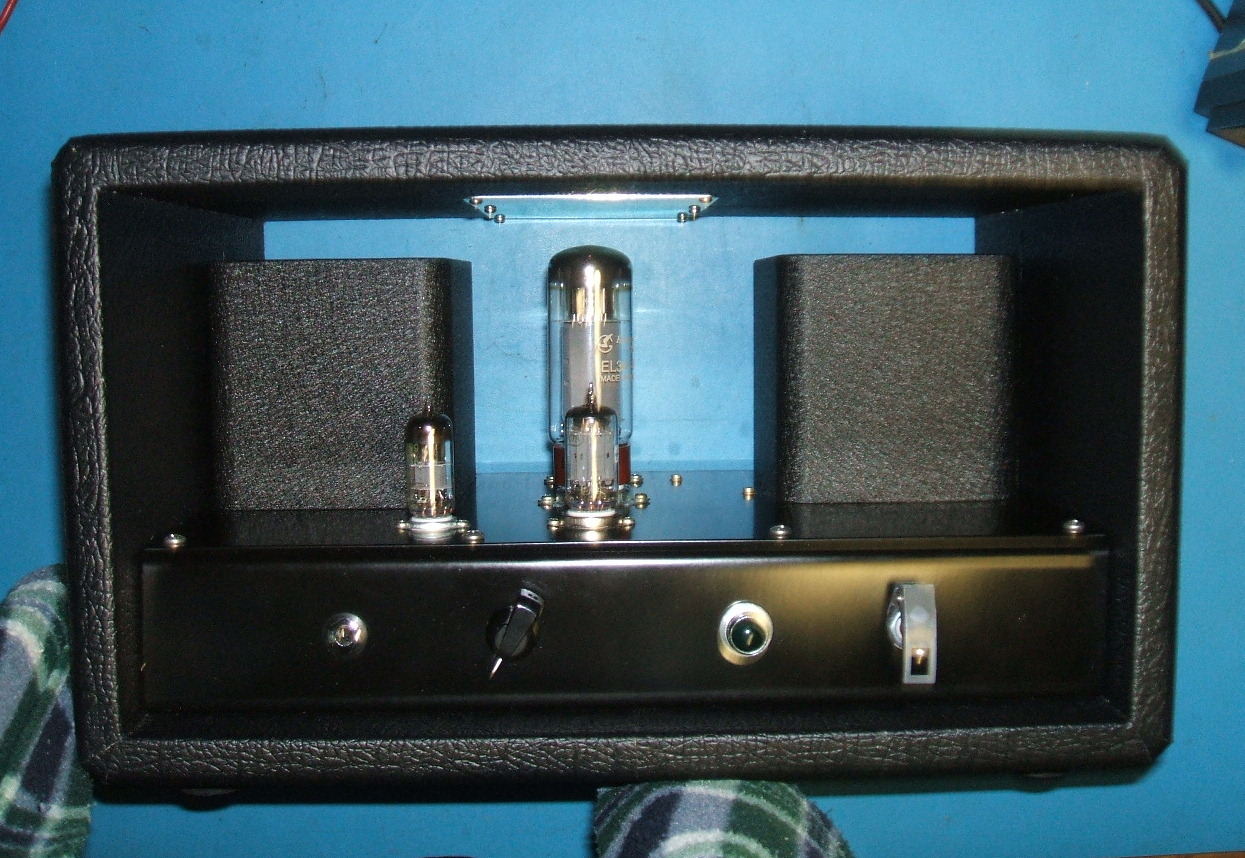

You mean something like this then? I built this for my niece, she plays acoustic. EL34 PP with 6GK5 input stage and 12AU7 phase splitter.
Yeah, that is cute! I'll bet it sounds nice too. The 6GK5 is the input tube? Nice. High impedance enough for a piezo (or similar) pickup straight in? Have you ever tried the amp with a standard electric guitar? If so, how did that sound?
It sounds good with electric guitar, its basically a mono hifi amp with a bit more gain. It surprised me that I don't miss the tone controls. It just works, just like a hifi amp does with no tone controls. Topology is input>6GK5>vol control>12AU7 gain>12AU7 cathodyne>EL34 PP. There's a short thread on it somewhere here. Maybe it would make a good jazz amp. At first I had a 12AT7 instead of the 12AU7 and that gave it some really sweet non-linear characteristics when driven 🙂
Did you use global negative feedback around the OPT, EL34's, 12AU7? If so, about how much?

No feedback, its very linear as is, no need. There is local feedback since there are no cathode bypass caps.
