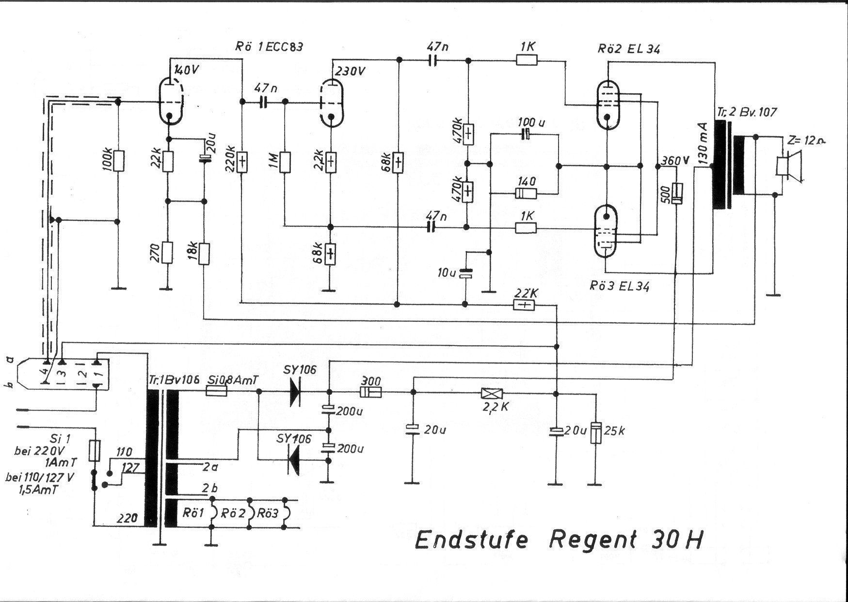

I would suggest to search for German Regent-30H schematic.
Thanks Wavebourn, is this schematic:

Could you post schematic cascode-connected E88CC at low current?
Yes!
