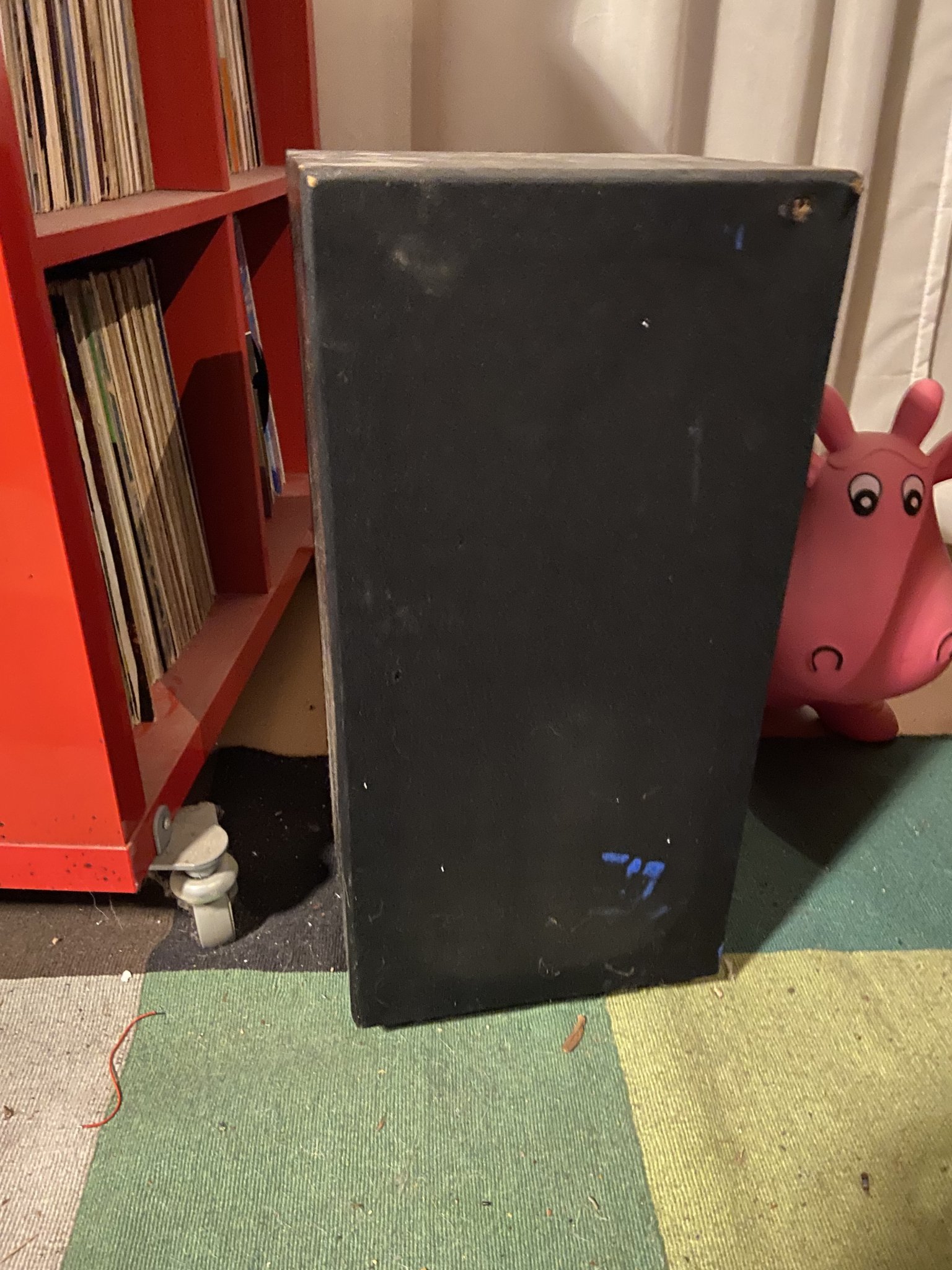

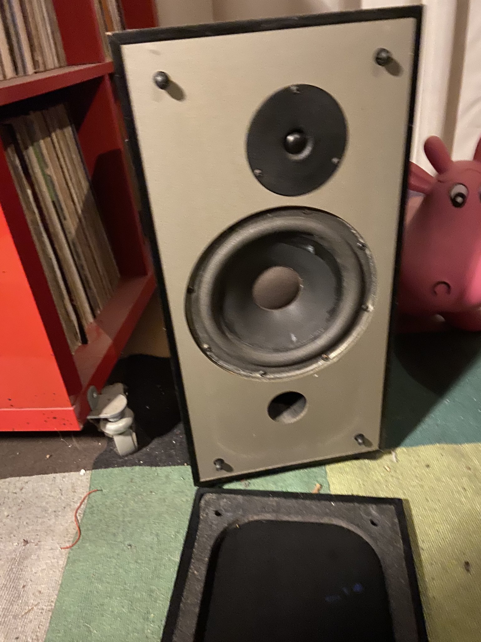

I bought the speakers 30 years ago and they don`t have any factory label anymore. All i can remember is they where manufactured by a canadian brand with three letters and are 8 Ohms. I do not have to turn my 35 Watt transistor amp up much get high volume, i would guess they are rather efficient. In fact when listening from the record player three is plenty loud, i can`t remeber going to four even when having a party. They have a tweeter, a 7" ( i guess, measures 17 cm) and a bass reflex tube in 52 cm * 25 cm * 22 cm housing.
PSB?

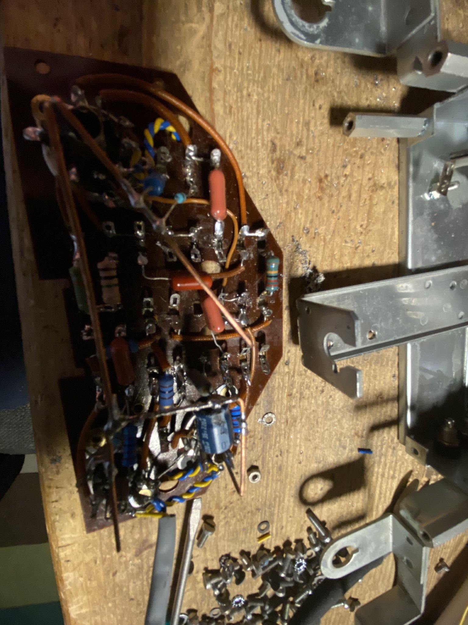

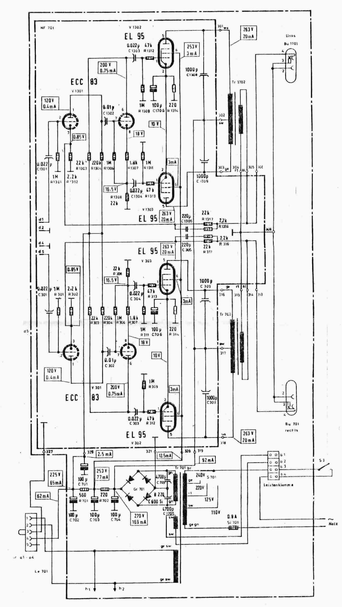

Thanks for all the suggestions so far. Where i am at now is i want to stick to KISS but i want to use what i already have, too. I do not have UL OT`s but a bunch of EL95 and EL84 output transformers. So as a first start i am building one output channel using two EL95s in push-pull pentode on a prototype board. The circuit i have chosen to try first is from telefunken, maybe i could do better for "hifi" but i have also been wondering how this output stage acts as a guitar amplifier. Will post a picture of my speakers, too. Maybe the brand is ESM and it is not canadian? I am curious what happens if i use one of them whith the attached circuit.

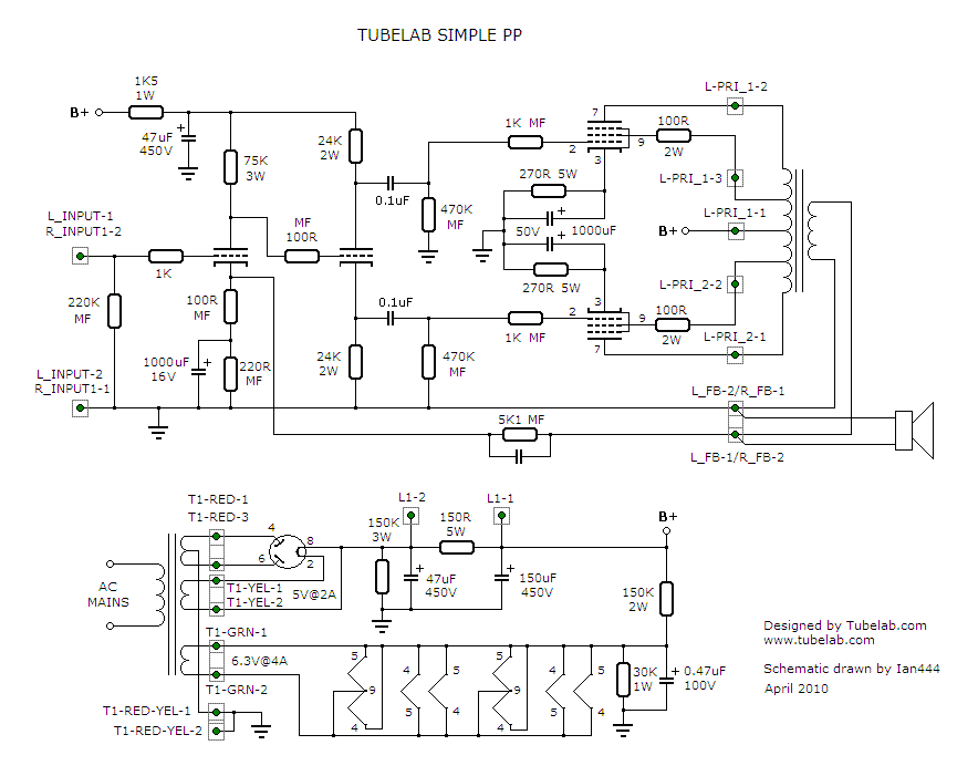

An EL95 P-P amp will only likely give you about 5 watts per channel. I agree with what others have said: an EL84 is a great way to go. The Tubelab Simple Push-Pull (EL84) is a great little amp. Several build threads on the forum. Build it on a PCB, if they are still available, but the schematic is readily available if you fancy a point to point, or turret board build. By the time you have invested all of the work and expense on an EL95 amp you might as well build an EL84.

I apprecciate your suggestions and i do not mean any disrespect. I have built single ended EL95 amps for guitar and i like them very much but at home they are way too loud. i turn the speaker attenuator to -20 dB and it is still plenty loud. Of course this is guitar-world and not "hifi" but i am willing to try EL95 push-pull anyway even if it is only good enough for guitar. Just to see how it drives my music-reproduction speakers. Begging to stand corrected but wanted to try this anyway, thinking 5E3 with EL95. I can do this on breadboard equipment and will not ruin the precious stuff i would like to house my record-playback amp in.
Thanks again, general advice is strongly suggesting EL84 push-pull pentode and EL84 push-pull ultralinear. I get that and i have suitable UL output transformers on my shopping list. I am going EL95 push-pull pentode because i have been wondering about this output stage for guitar and because i already have the parts and if it is not working for hifi i will apppreciate EL84s even more. I have been searching the forum and i am thinking i found the schematic for the Tubelab Simple Push-Pull (EL84).
That's it. In my builds of the SPP, I substituted a 1.5H choke for the 150R 5W resistor in the power supply. It eliminated the last bit of hum. Depending on your B+ voltage it might be better to replace the 270 ohm, EL84 cathode resistors with 300 ohm ones. The voltage gain/phase splitter tube is a 12AT7/ECC81.

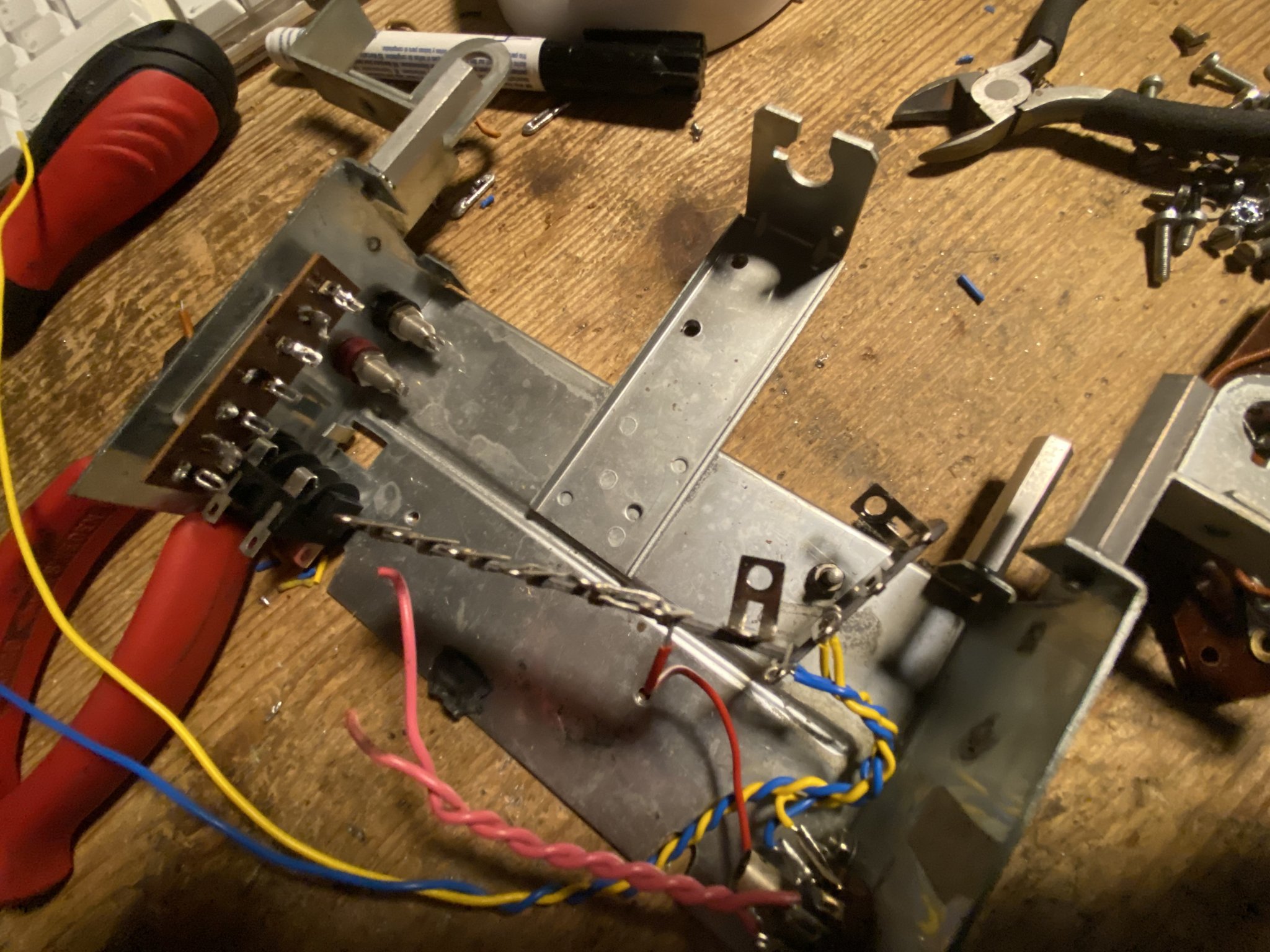

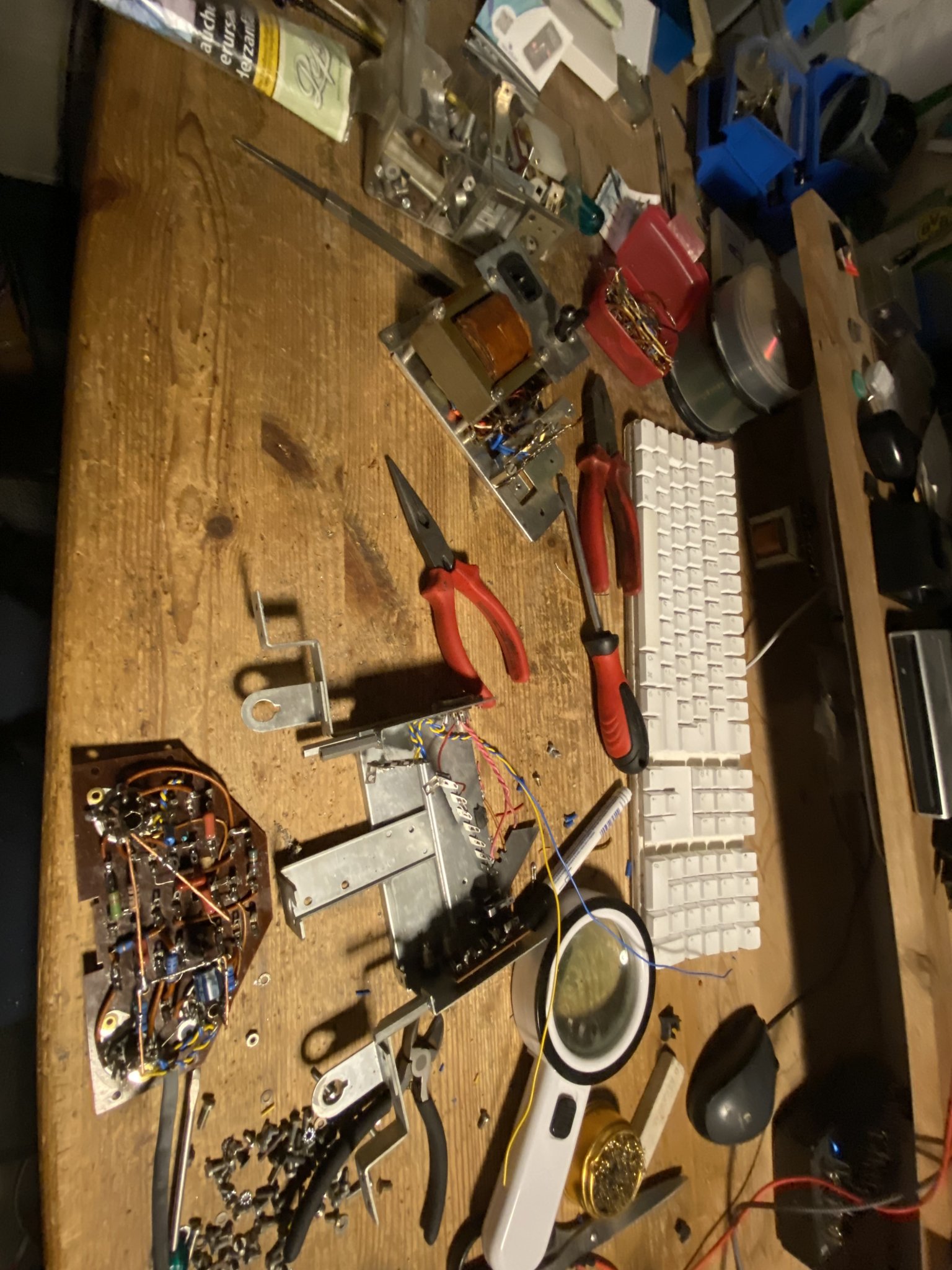

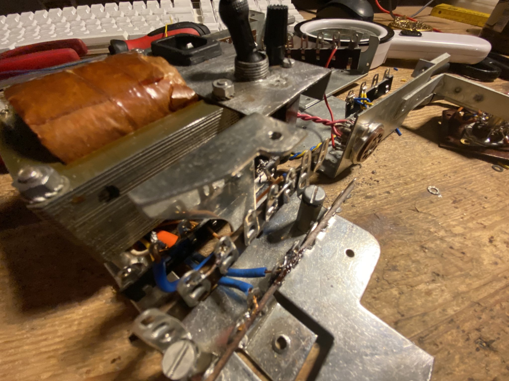

Once again, thank you all very much for your kind consideration. To whom it may concern this is what I am knocking meself out with right now. Nothing has been plugged in, yet. Modular built and breadboarding is key. Where will EL95s in push-pull take my wonder. Also my speakers. Please excuse the dirty floor. Also power transformer and output transformer are small, this will change when going high-fidelity.
