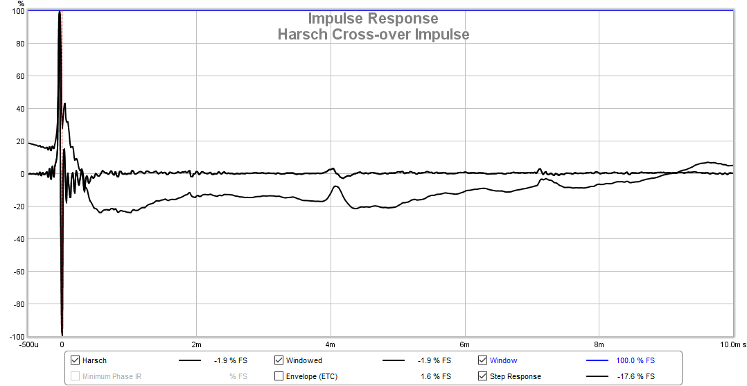

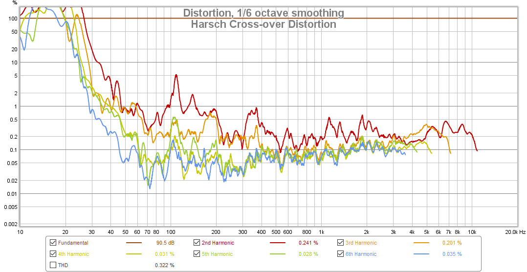

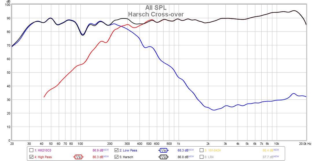

BTW here are some graphs of what I took to LSAF in Dallas. It is a work in progress and the cabinet (the Audax) needs some work. But....
Bob

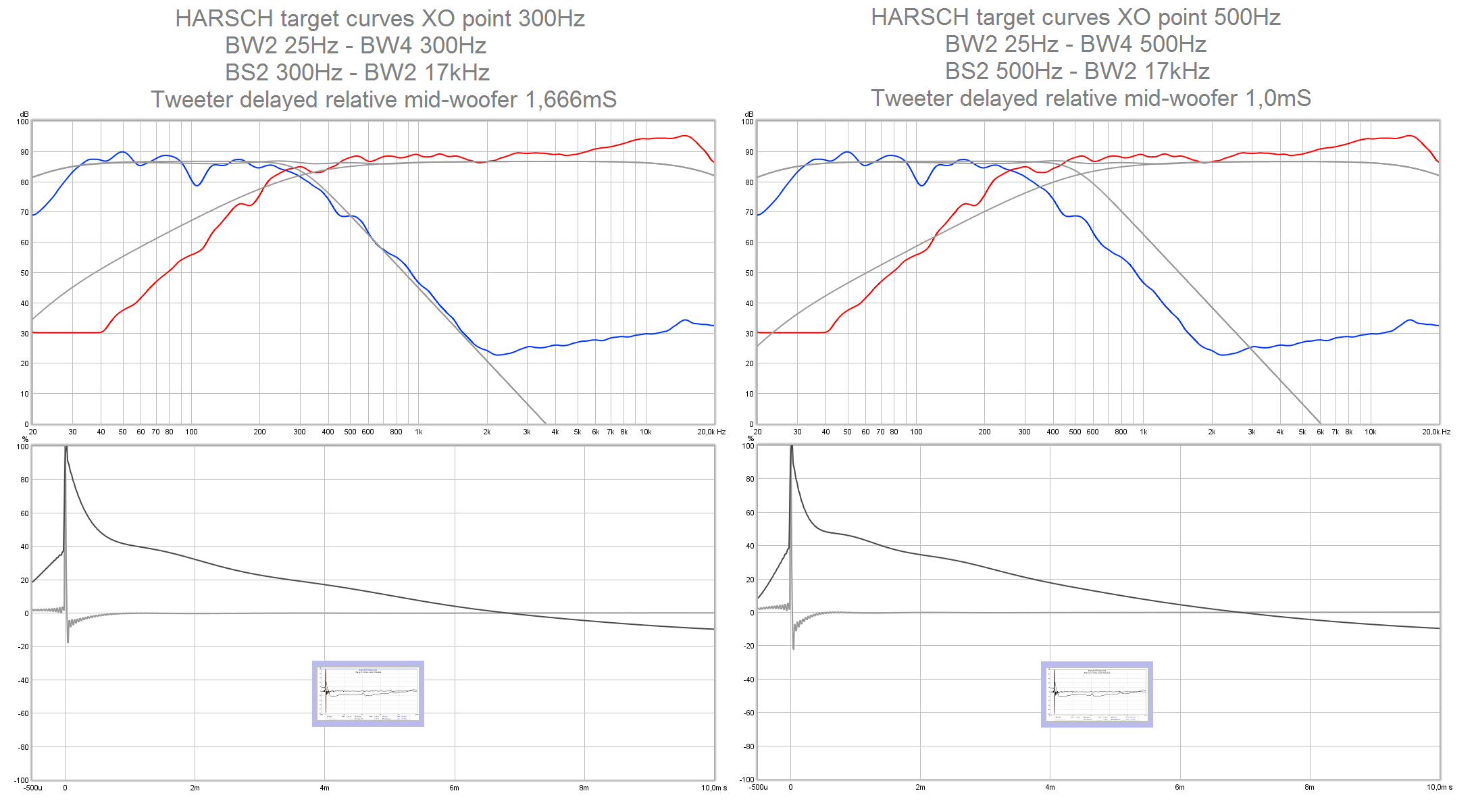

Have noticed its a work in progress 🙂 but at IR/SR plot it looks there is mismatch somewhere in device chain for polarity MW verse MT, if target is a Harsch XO as mentioned in post 12 slope for MT looks off in it show more as a BW4 than BS2 slope. If it's a help attach a zip folder with target slopes for HARSH at either 300Hz or 500Hz, its IR-wav files that is easy import into REW for use in "Overlays" or "All SPL" window and then offset SPL to real speakers live measurement sensitivity. After some learning over at Rephase thread and confirmed by some simulated studys have in target files incorporated system stop bands set as BW2 25Hz / 17kHz, it makes a change in phase per pass-band target but also visible in frq domain as a light knee around 30Hz area for MT slope.

....slope for MT looks off in it show more as a BW4 than BS2 slope.
Ah, well, er....
What's happening is that I really can't cross the 10F that low. The roll-off starts at BS2, but it quickly catches up with the natural roll-off of the driver which is essentially loaded IB. So, the two roll-offs add up to 4th order. I am going to have to go up, probably to 500Hz to prevent this.
Thanks for the target files. However, I can create these by tracing the target in the nanoDIGI.
Bob
