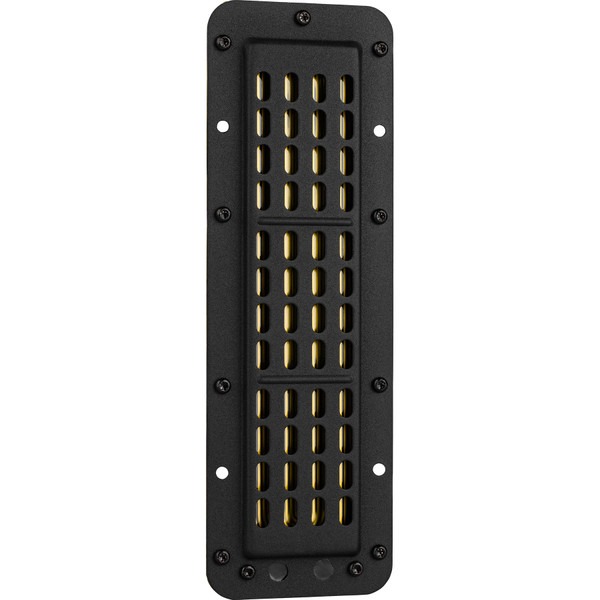

First off the ribbon will need to be dipolar… like the larger Heil.
Many ribbons (most?) are monopoles.

The biggest trouble your going to have is the wild disparity of the two driver sensitivity values...The typical five inch woofers running 85-90 Db, vs. the 92-95 Db values of the dipole ribbons. I simmed up the Morel five-inch CAW-538 and tweaked the numbers to reach down as far as practical. At 11.8 liters in size, I could get down to -3.08 Db @ 43.8 hertz. But that pesky poor sensitivity running at only 86 Db will have you dialing way way back any dipole ribbon.

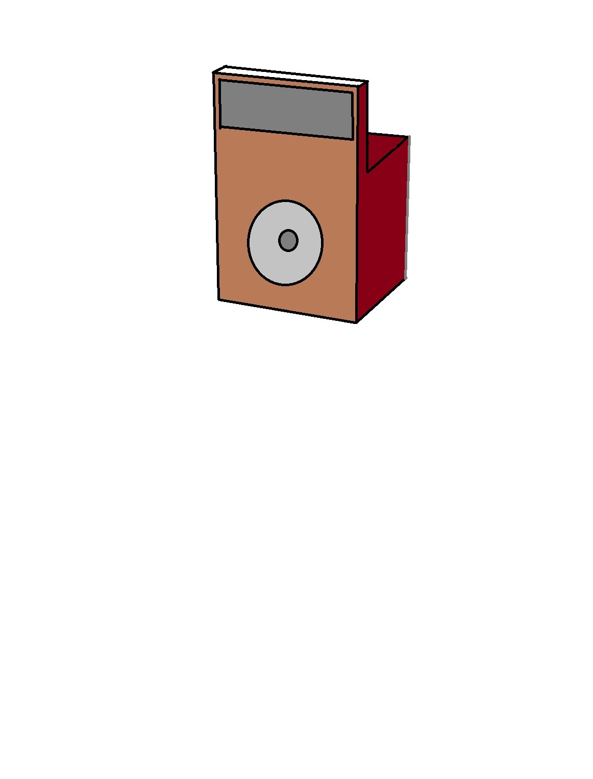

This is what I had in mind for you, the five-inch I described & the GRS ribbon atop, the ribbon in dipole configuration...say 210 mm wide, 280 mm tall, 180 mm deep...or thereabouts.

Considering the desktop scenario for which this is designed, the pair would likely be a bit toed-in...and the listener is likely tied to their "computer-chair". As such, the horizontal variance AND the vertical variance would be severely limited.
I tried to find some lobing graphs for ribbons....I am aware of the problems with ribbons, the phasing when one listens to "one end" of the ribbon...and listening to the other end...the distance differences from one end to the other depending how much you are off axis. Kinda makes the nearly infinity point source (depending on the VC diameter?) of the full-range driver rather cool huh?
