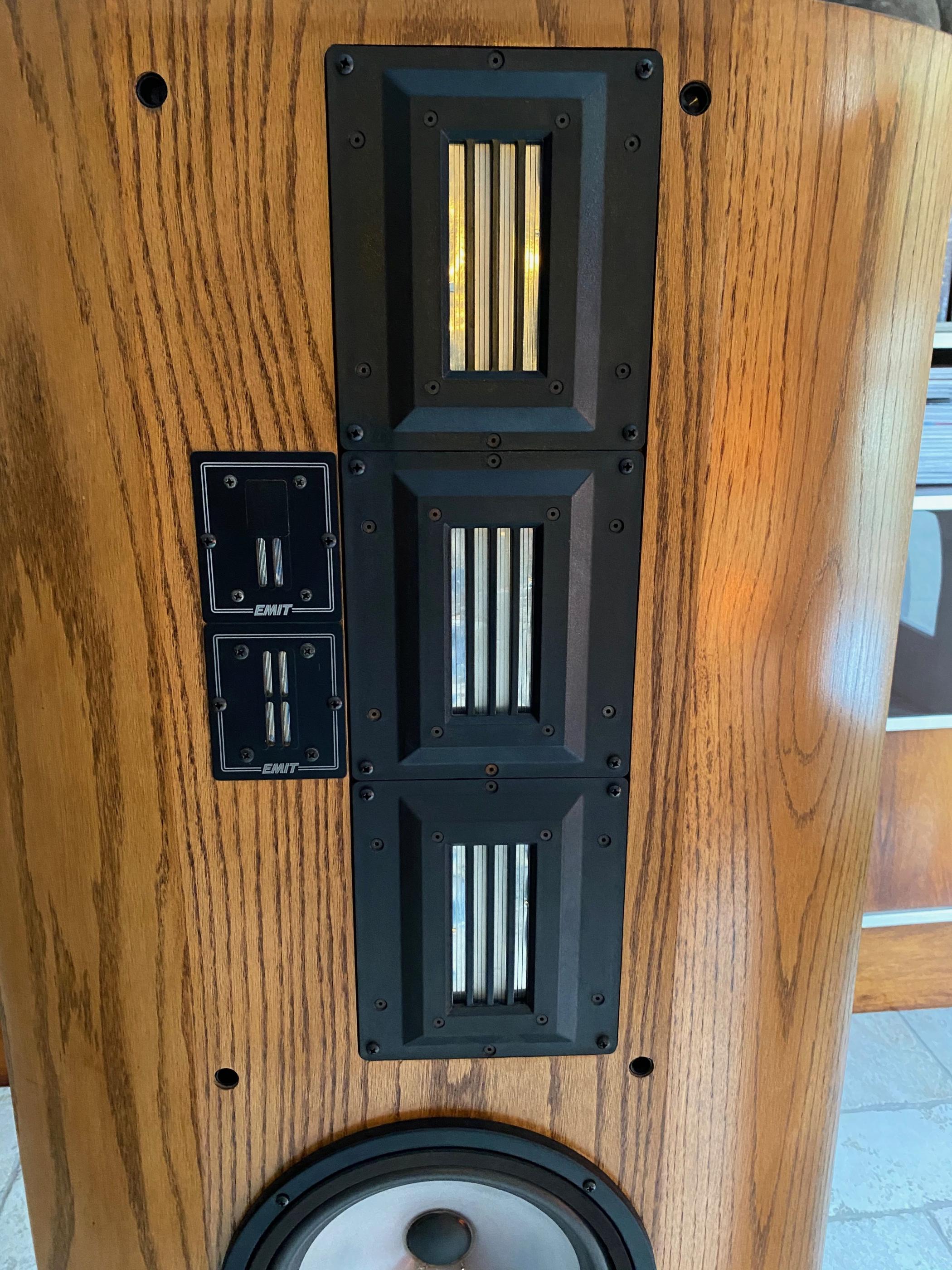

Suggestions for AMT tweeter placement in modified MTM
I see, post #5...
There was quite a lot of Infinity speakers with similar arrangement, seem to work fine.

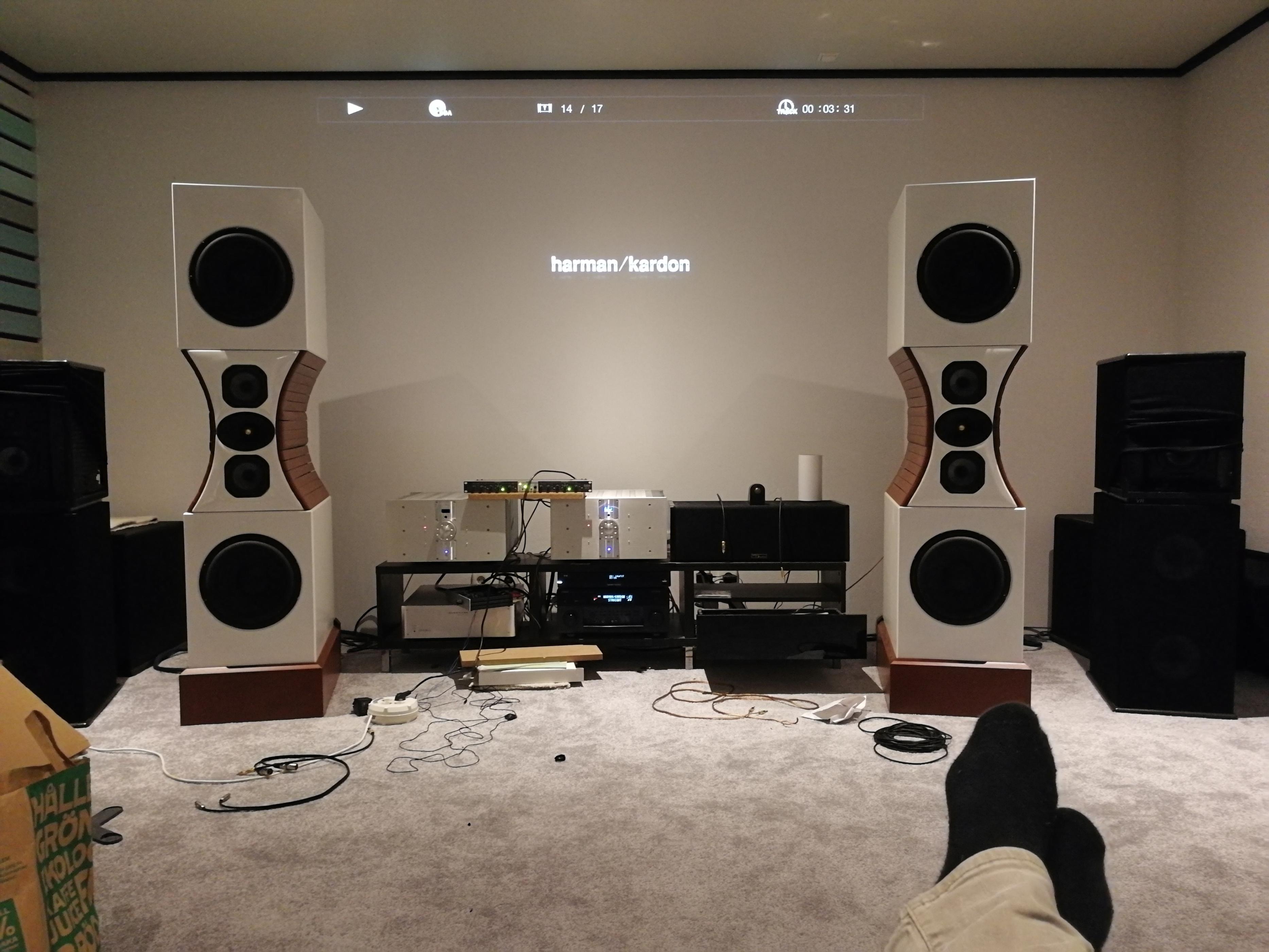

Adason:
Love the INFINITY REFERENCE STANDARD RS II and II-B!
It was with old Infinityspeakers my love for hifi starts !
My sister had a Infinity Column II that she bought back in 1974, with Sansui preamp and amp etc.
Around 1989 a bought the Column´s from my sister and renovate the speakers, and around 2000 i bought a par of Infinity IRS Sigma.
Had trubble with getting the Sigma´s play "out", and tested at least 15 different amp´s until i test a Pass Labs x-350 "and the door´s opened".
My most expensive audioequipment at the time was a Harman Kardon AVR 8500, and the used Pass Labs was 3 times more expensive.
From that time my hifi interest grow, and with 7 disc herniation and a titanbrick at 3 levels in my neck i found high level music much better painkiller than pill´s.
So i rather drive a trash-car and spend money on my hifi, because i don´t give a **** about impress the neighbors 🙂
That Vifa midrange was real impressive :-o
/John

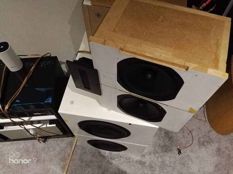

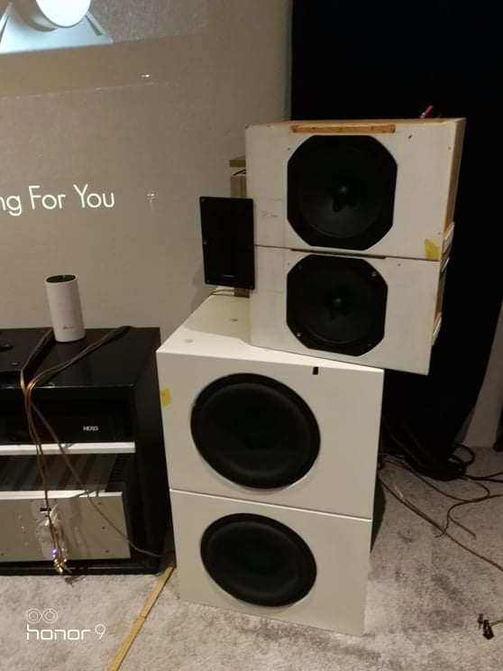

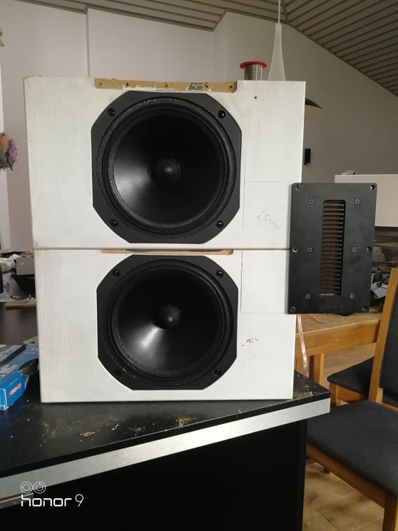

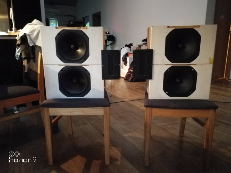

Okey, so i have modified the MTM for a first try out.
I have prepered to move the tweeter in about 7 cm, but that includes "sabotage" of the midrangecabinett and steal maby 1 liter.
/John

I kind of think that time alignment might be your biggest enemy here.
It would be interesting to see you place the amt in front of the twin mids ... but you'd need to delay the amt response. Since you're doing that section passively, that is going to be a challenge.
From the photos that looks like the Mundorf AMT29CM1.1-R Air Motion Tweeter, that is one nice driver and out of my price range. Nothing to do with your problem but in my opinion you are cutting over a little low if it is that tweeter. The spec sheet recommends 2000 hz @ 12dB and with an Fs of 1500 hz I would be crossing closer to 3000 hz.

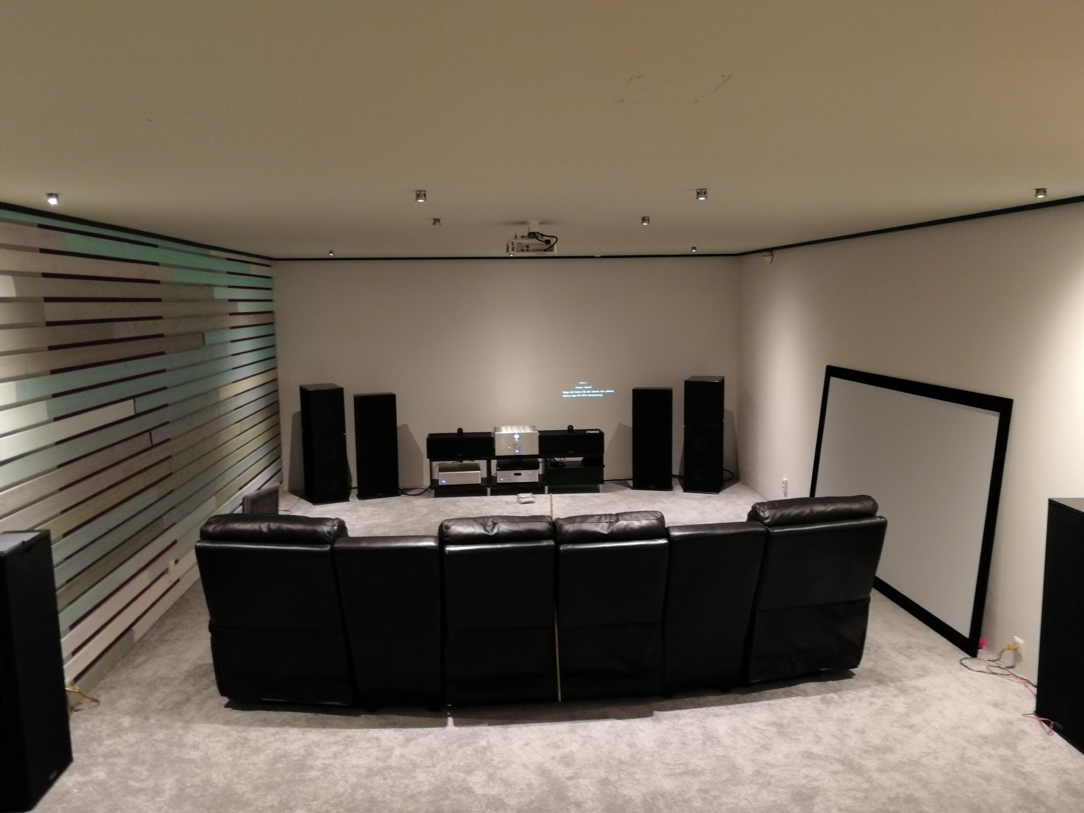

Is it just me, or is that the worst looking room I have ever seen for overly-lively acoustics?
No rugs, no carpets, not much stuffed furniture....
Must be full of sharp echoes! 😱

The midrange is allready about 4-5 cm behind the AMT (coil-wise), and my "first-build" MTM was good in time alignment ...Regret that i saw it apart, but beer does that sometimes hahaha.
Have ĺistening alot with the re-built one now, and try to get "the best of it", placering it in 25 different way's with different toe-in and wide/deep.
I got around 85-90% of hi end, and it plays BIG like hell...but still miss the last 10-15%.
But aren't sure that the last 7 cm (by putting the tweeter closer) is going to get that....and sabotage the midrange-kabinett is a "NO return ".
Hmmm
/John

Yes its that Mundorf tweeter, but i xover at 1850hz 18dB, and it works perfect!
Cant stand Beaming and at about 2050 hz a 8 inch midrange beaming, so i keeping me 200 hz under that number.

My room have 15mm rugs on the floor, 10 sound-eating carpets AND aucustic regulated treatment in the walls.
So i don't know what rum you talkning about?
/John

And system7:
This is my room and the "first" fullrange speaker, MTM with 2 x 5,35 inch Audax HM130Z0 and Audax TW025A28 and a waveguide from Pellegrene.
Burn 3 midrange coils after 3 week´s, so moved on to more SPL MTM
/John

LewinskiH01 :
No i mean to use the Mundorf AMT , but have it between the midranges ( as usual MTM´s)
Yea i saw the Goebel Divins after my build, and it´s the "same body" but mine are more feminin in shape and Goebelá are more "spacelike/matcho"
Hard to get good tweeter´s that work down to 18-1900 Hz (exept compressed driver), the Audax TW025A28 in a waveguide sounded supergood but need around 3000hz i think.
Also have a fantastic SRT-7 sealed ribbon tweeter from Viawave, but it can´t handle much power if you use it from 18-2000 hz....about 17 watt RMS power handling and 40 in peak´s.
Everyting in hifi is compromises
And i have re-build the MTM´s, so maby can try it out agian tomorrow 🙂

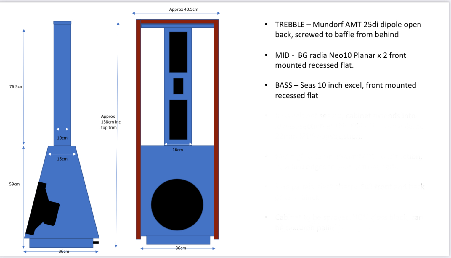

Help on wiring

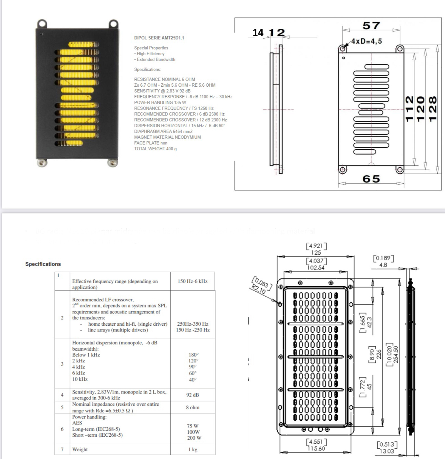

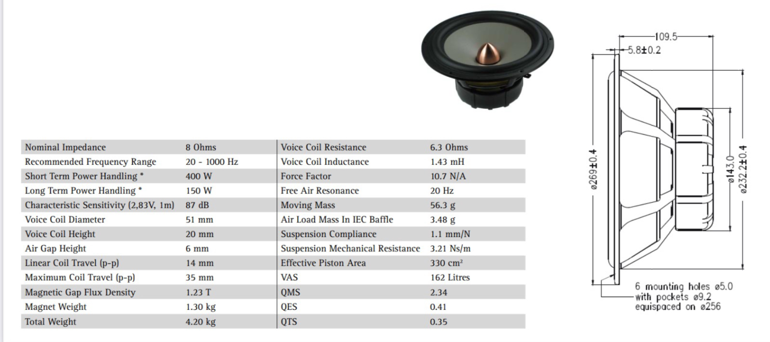

Hi all, @jawen I was interested by your thread, I am using similar tweeter but planar mids in MTM but I am not sure about wiring because of the impedance differences of having 2 mids 1 tweeter. You talked about your wiring to get back to 8 ohms but could you explain a little more please?
These are the measured impedance of all my drivers: and the spec sheets in images along with a graphic of the build.
Bass is 6.20hm matched pair
Mids matched pair is 7.9ohm (2xmids)
Mids matched pair is 8.2ohm (2xmids)
Tweeters matched pair is 5.2ohm
I have a standard test crossover Drayton audio 3 way crossing at 375 and 3000 while I learn how to produce a proper custom crossover but how to match the driver impedance by wiring the 2 mids per channel like you have.
Comments from others welcome, hope ok to add this to your thread but seems you know on this specific topic.
Dan
Ah I think I got how you did it
“2x8 Ohm´s coils connected in serie at the bobbin for 16 Ohm, and parallelconnected outside so 8 Ohm”
2 voice coils per driver. The bg radia Neo10 only have one connection (coil - although planar so not really a coil). So all the matching needs to be done in the crossover design.
Am I right that the tweeter and single mid are 92dB sensitive? Connecting 2 mids in series will maintain that sensitivity. However if you will use the MTM configuration to manage lobing, parallel may be preferred.
