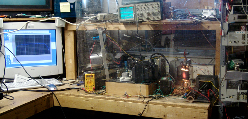

I bought about 200 surplus OPT's from an Ebay seller when the ADA plant burned ans ADA subsequently closed down. These were in the delivery pipeline indicating thar ADA was looking at making some medium power push pull tube guitar amps.
I have used over 100 of those OPT's over about 15 years. This is the second one I have killed, and it still may be possible to degauss it. I have done that successfully with a variac, but not with a transformer this bad. There could also be some internal damage from the lightning bolt that tried to eat it, but it still has the correct DC resistance. I had the amplifier up and running with some of the biggest TV sweep tubes I have in it. I was getting about 160 watts per channel on 600 volts of B+ when I decided to turn the power supply up a bit more......BOOM......PSST, silence, smoke.
The other one? "and the OPT is now a fireball."
Nearly 15 years ago I decided to wire a pair of the same big TV sweep tubes up to one of my new OPT's and feed it with a big industrial control transformer. The 600 volt transformer made about 750 VDC once rectified and filtered. This time it was a guitar amp, the biggest tube based guitar amp I had tried up to this point. I had checked all the details, powered things up with a variac, and was somewhere north of 600 volts of B+ with over 150 watts flowing out when my 50 watt load resistor (a missed detail) blew leaving the amp without a load. The OPT instantly tried to eat all that power, but couldn't digest it all, turning some into FIRE!!!!! The resulting fireball was extinguished when the 20 amp circuit breaker that fed the whole room tripped.
That OH SH!T moment prompted me to get a fire extinguisher, add a 15 amp breaker and a kill switch to the workbench power feed, and buy a pair of 8 ohm 500 watt resistors.
Uber crazy experiments also prompt a 1/4 inch thick sheet of polycarbonate plastic between me and the amp under test......

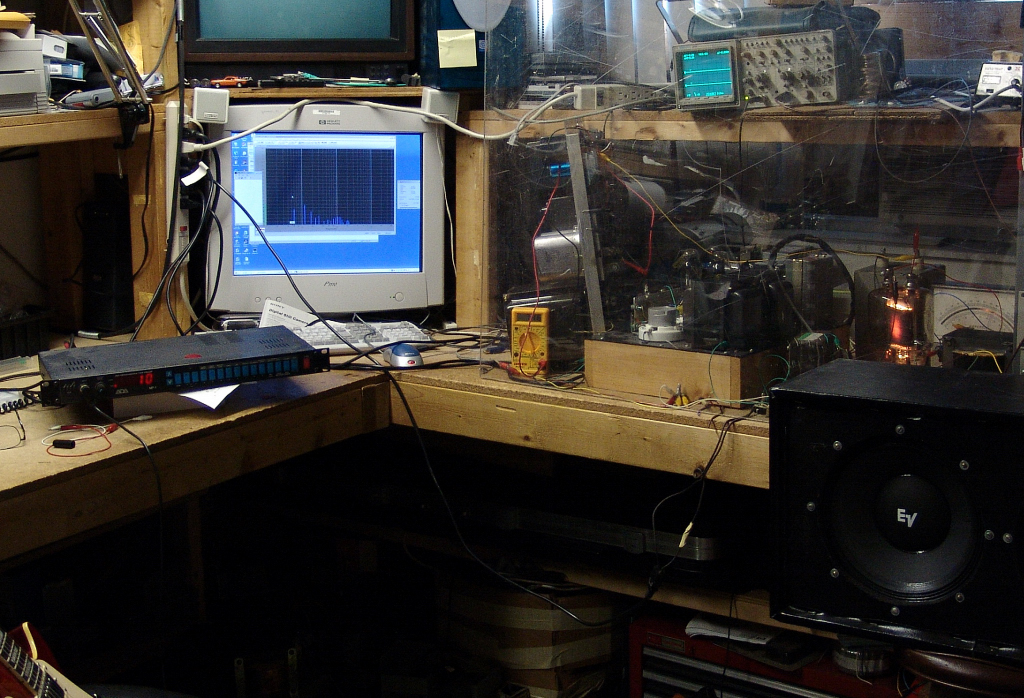

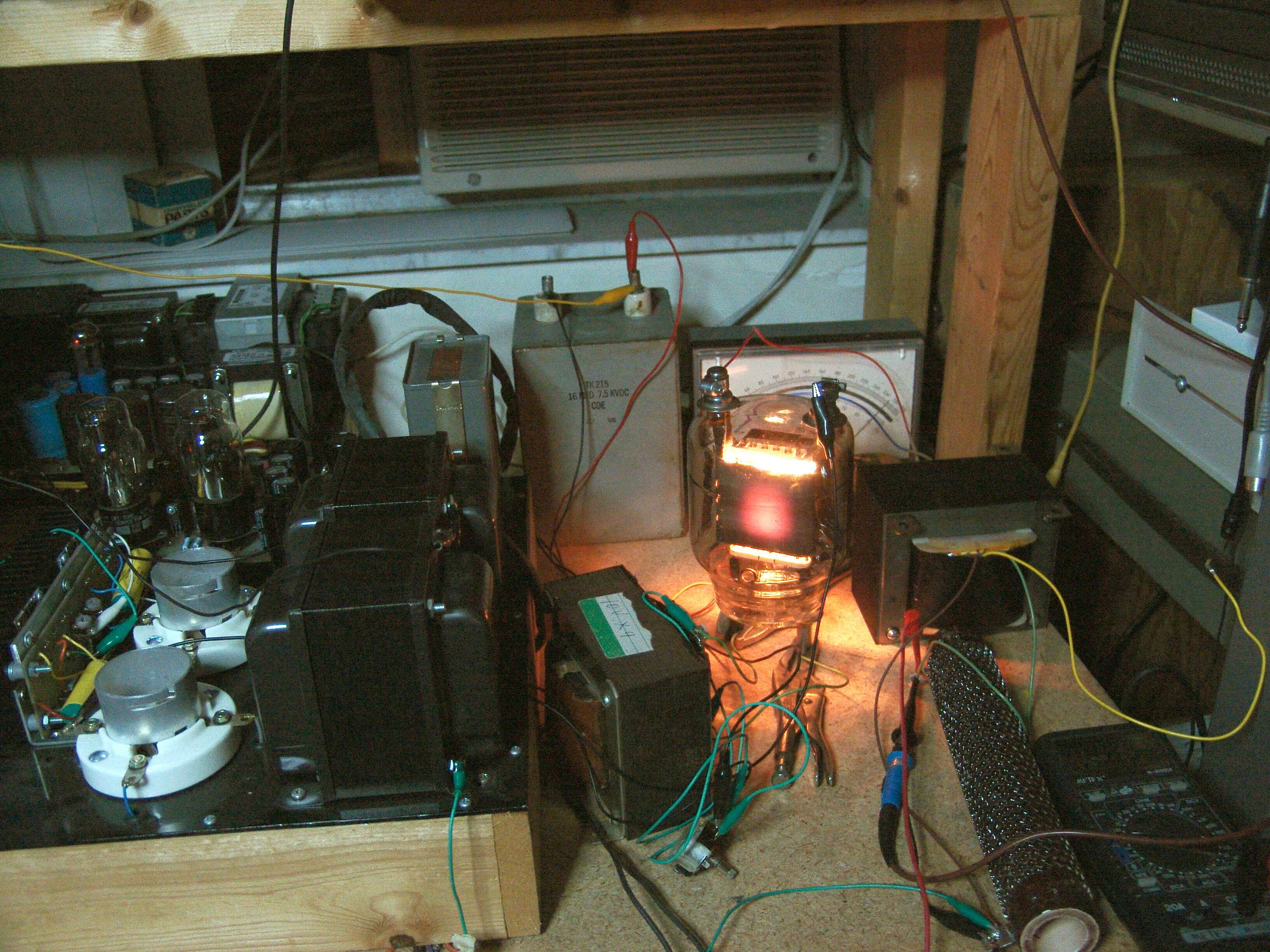

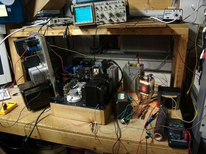

Uber crazy experiment? Take one transmitting tube removed from a 500 watt AM radio station (glowing!), with vice grips and hose clamps for a socket, add a 1500 volt 1/2 amp power supply from a Motorola VHF base station fire department transmitter (standing on end, 70 pound power transformer behind the yellow meter), wire these up to one channel of a HiFi amp that I had built, drive it with the output of an ADA MP-1 tube guitar preamp, connect the output of this mess up to a DIY cabinet containing a pair of Electro Voice guitar speakers, and set the MP-1 on program 10, a patch that I just called "JIMI." Result, lots of loud coming from a single ended triode amp that made over 200 watts! This one didn't blow up and sounded good too.
There are some pictures with the "blast shield" removed for clarity. I'm nowhere near this thing with a guitar for those pictures. The 500 watt resistor is in front of the OPT next to the grey meter. There is a 16 uF 7500 volt capacitor behind the tube. Power (1500 volts) flows to the cap through a Radio Shack clip lead (yellow). Don't try this at home!
I saved all the big parts so I could build one of these amps, but do I need a 200 watt Champ? Maybe someday.......
