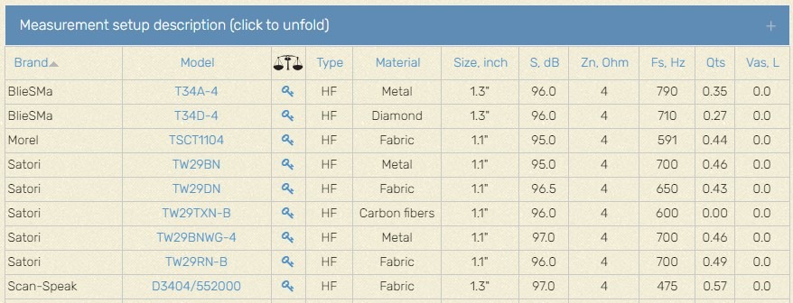

Im making a speaker for some outdoor concerts, and Im struggling a bit. I need a tweeter. I find it hard to find something in the realm of 95 dB sensitivity, and was wondering if you had any suggestions. It would be fine, if it was some waveguide or something that did the trick. As long as I land on something, where I don’t have to lower the sensitivity on my woofer. (As it is an outdoor build on batteries. I want it to play as loud as possible)

I've never listened to it because I've never needed anything with that kind of efficiency, but if I did I would definitely try it. There are several respected designs with it I think (or the older Peerless/Vifa versions) and the Heissman test is pretty positive as well (https://heissmann-acoustics.de/test-scan-speak-discovery-h2606-920000/).
The off-axis performance seems to be pretty much what you trade off for the WG-assisted increase in sensitvity, but whether it is a real problem depends on your specific application I think.
https://www.morelhifi.com/en/products/raw-drivers/classic-advanced-37/cat-378-419
This is nominally 93 dB, but it might work... I've used it once in a large WWMT 3-way and it sounds great, very "Morel smooth". It depends on how the FaitalPro's FR was measured: if it's an IEC baffle (likely), once in a box you will have some diffraction loss to compensate for, so the Morel might work just fine. Or you may be OK with a slightly tilted downwards FR, à la Troels.

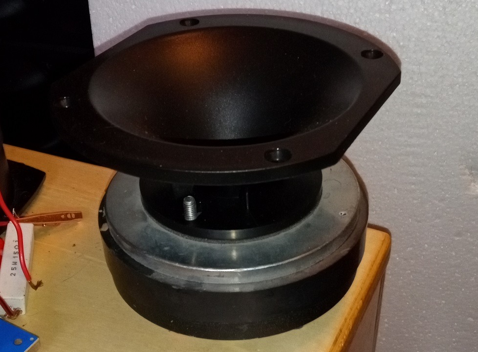

The problem is hi fi dome tweeters are too inefficient. Yeah, you can get one that will match the sensitivity of a 95dB pro woofer. But it will need to run at full power to keep up - little or no padding. Then it’s only good for 6 watts, maybe 10 of average power at high frequency, and when playing loud you will simply burn them up. Compare that to a compression driver which handles 25 W of power and needs a conservative 6 dB of pad. It takes 100W above the crossover frequency to do any harm. Playing off batteries, you are probably going to be running a small-ish amplifier hard. Everybody knows it’s easier to burn tweeters up that way in general - and inviting it seems like a bad plan.
-6 dB 45 degrees off axis all the way to 20 kHz simply isn’t required for any kind of outdoor PA. If you can get that to say 12 KHz (with no hole in the midrange) you’re doing fine.
Large ribbons can handle more SPL before damage than 1-1/8 inch domes, that’s for sure. The $400 AC 7” ribbons can make plenty of racket before fusing, but they will fuse if you overdo it. Are the AMTs as easy to replace diaphragms in?
The most AMTs diaphragms are in a small plastic frame, so they are one of the easiest to switch. They have a completely flat impedance, which makes it very easy to implement a precise limiter setting or build a passive high pass filter for them.
PRVs HF stuff is on the cheap side, and may or may not be “hi fi enough”. If I wanted relatively hi-fi, work with a 10”, and not break the bank I’d go straight to the B&C DE250. Use the PRV stuff for DJing because you will need to replace diaphragms eventually (or all the time, depending on your habits).
