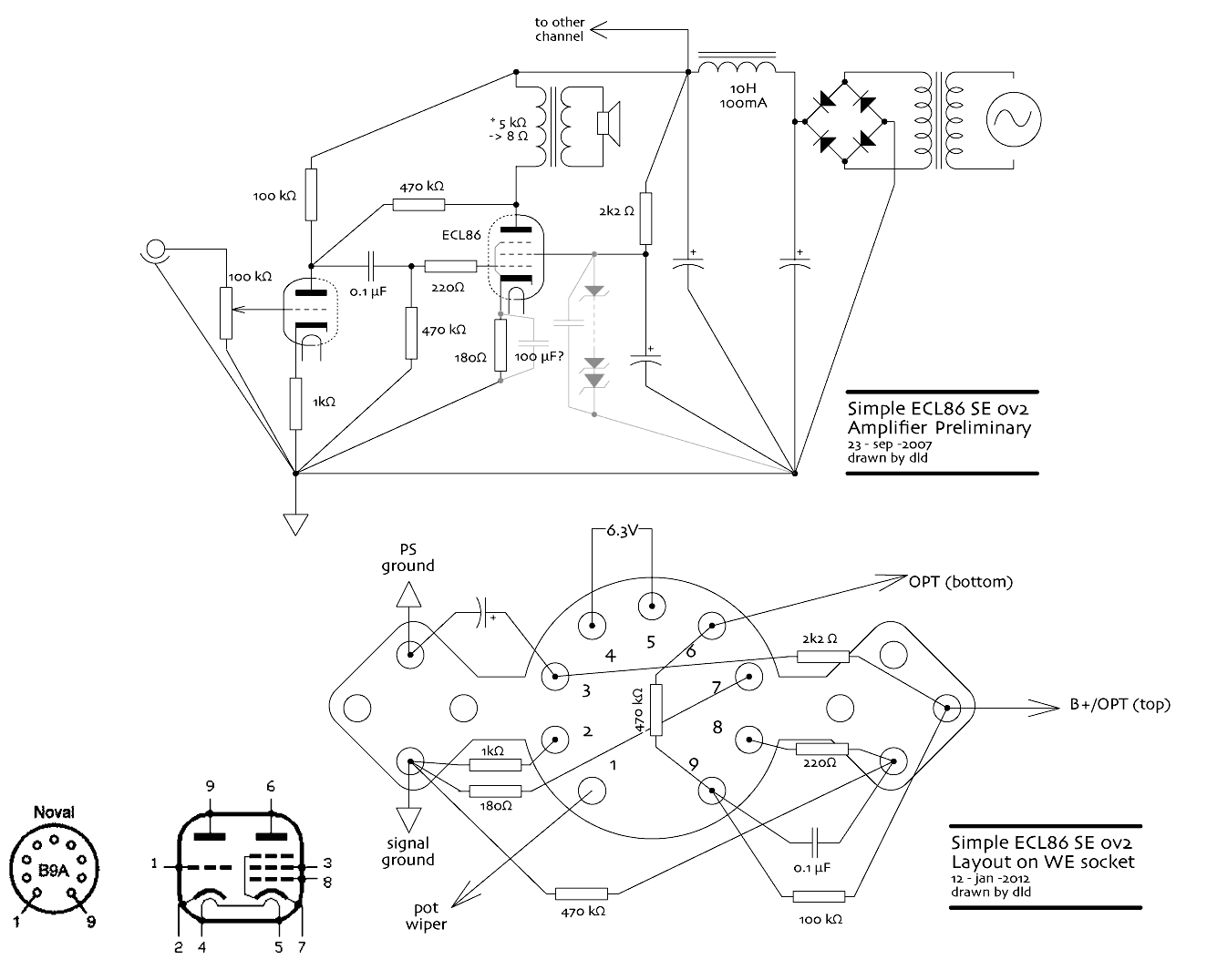

From the map i drew that andrew just posted came an RH variation using the (supposedly rare -- i have lots) ECL86.
attachment.php
I plan to go ahead with this build, the layout below the scema is for some WE sockets i have that come with attached "tag strip". I haven't had it vetted yet,
Of the greyed out bits, the bypass cap on the output tube is probably a good idea, the screen grid regulation is optional
dave

Note that Morse's amp is SE Pentodewith no feedback so is going to be a current amplifier so care needs to be taken that the loudspeakers you use are happy with current drive. <snip>
Hello !!
Do you have pictures of the build of this schematic and the parts list. i would like to try this ECL86 schematic . the last schematic i tried gave me lot oscillation and possible grounding issues. ictures will help me run the wires properly and layout.
