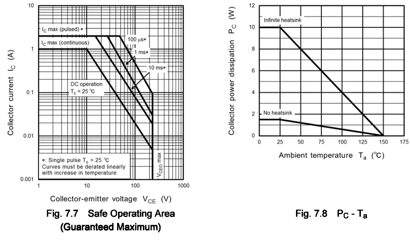

In a project I'm working on I need a source follower supplied with +40 and -140V, with a cascode of two BJT as CCS set at 6 mA.
The bottom BJT will be a 2N5551, while I'm open to suggestion for the top BJT.
Requirements are:
  1. Being able to dissipate up to 900mW on peaks (it will swing up to +10V), 450mW as average (it will be set around -55V at idle), so I would say we need to exclude TO92;
  2. Vce of at least 200V (I'd consider at least 230V for safety due to voltage fluctuations on the 180V we have as nominal);
  3. Fit a classic TO92 pcb connection (1=b 2=c 3=e) because this is how the pcb has been done;
  4. A good Hfe to improve the CCS impedance.
I've checked on mouser, and I've found some options:
  1. KSC2752Y : https://www.mouser.it/datasheet/2/308/1/KSC2752_D-1810664.pdf
    TO126, Vce 300V, Hfe 40-80, pinout fits, 0.61 €/each;
  2. TTC011B : https://www.mouser.it/datasheet/2/408/TTC011B_datasheet_en_20160209-1649840.pdf
    TO126, Vce 200V, Hfe 100-320, pinout fits, 0.64 €/each;
  3. TTC008 : https://www.mouser.it/datasheet/2/408/TTC008_datasheet_en_20140403-1916100.pdf
    New PW-Mold2, Vce 200V, Hfe 80-250, pinout fits, 0.87 €/each;
  4. TTD1409B : https://www.mouser.it/datasheet/2/408/TTD1409B_datasheet_en_20150806-1915948.pdf
    TO126, Vce 400V, Hfe 600, pinout fits, 1.62 €/each.
TTD1409B seems the best choice, do you have other suggestions?

The TTC011B : https://www.mouser.it/datasheet/2/408/TTC011B_datasheet_en_20160209-1649840.pdf
after a light bending of the pins, seems the best option at the moment.
What do you think? Has anyone ever used it for this purpose?
