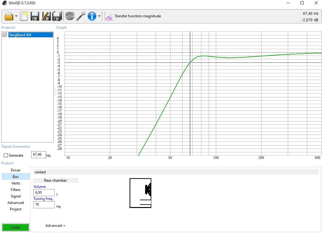

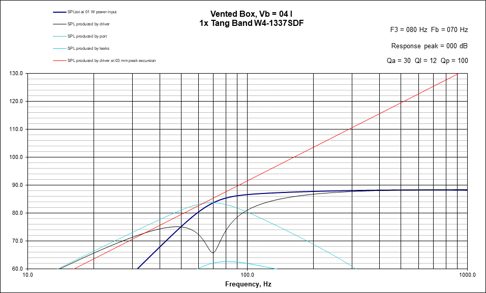

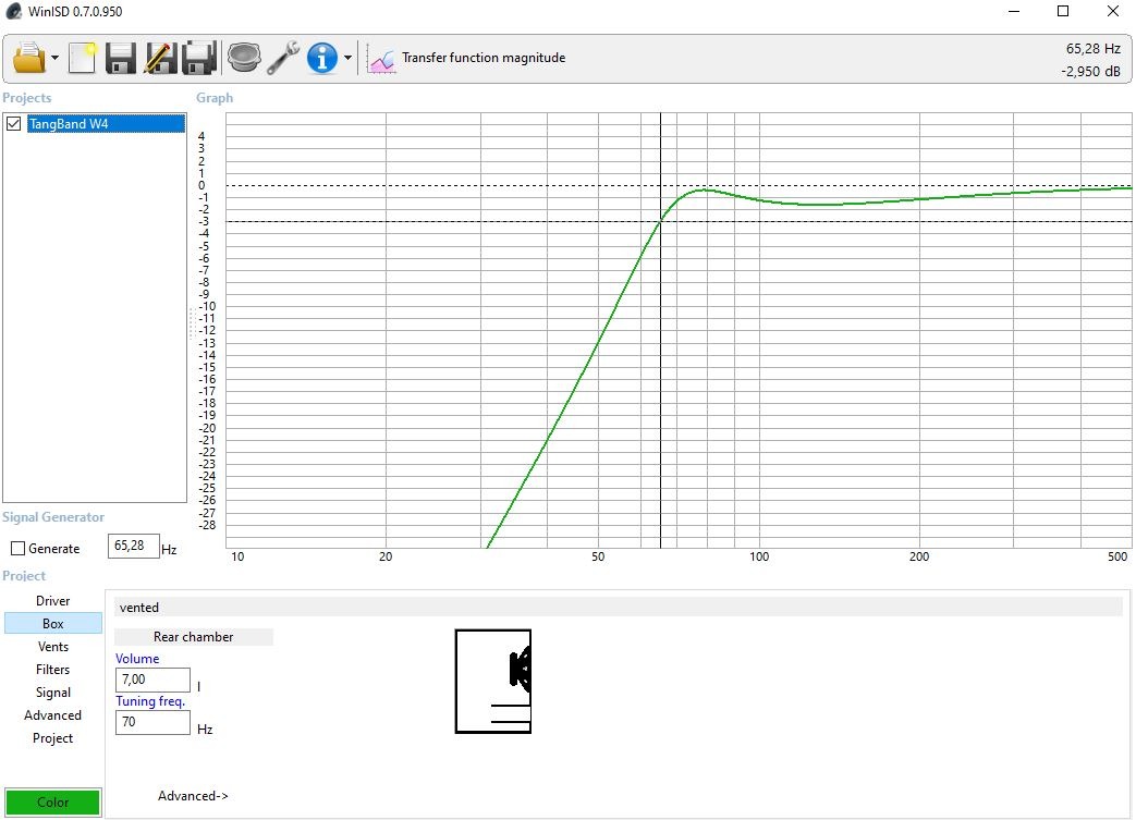

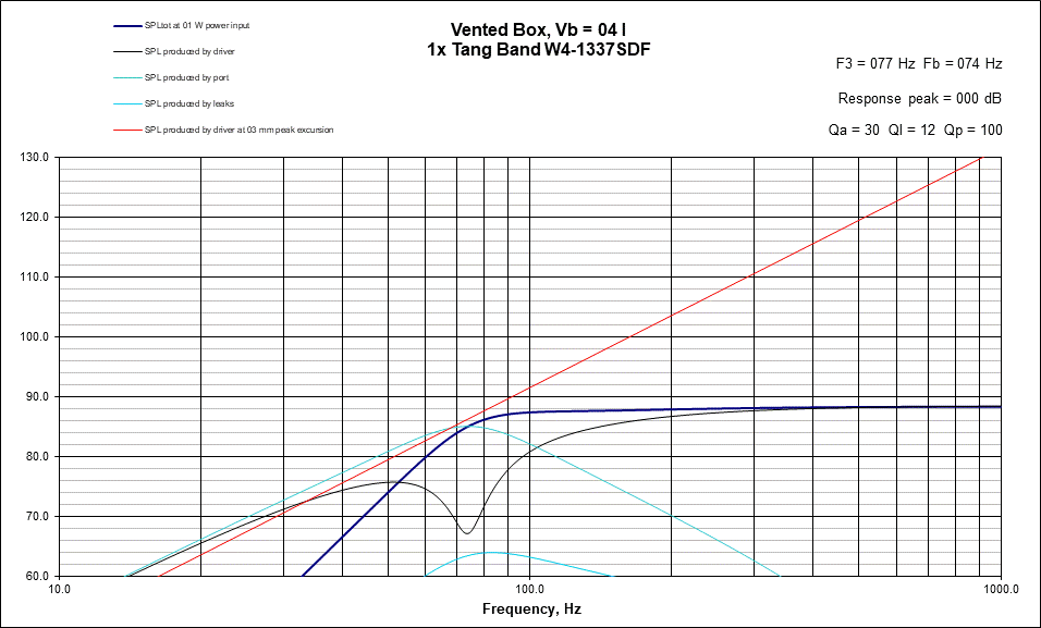

Yeah, I should wear my glasses when I look at graphs now.Looks like F6 at 50Hz in TABAQ to me?![]()
F3 more like 55~58Hz.
That's why I liked LATL, the graphs were more spaced out and easier to read. I need to find how to spread the frequency axis in HornResp.

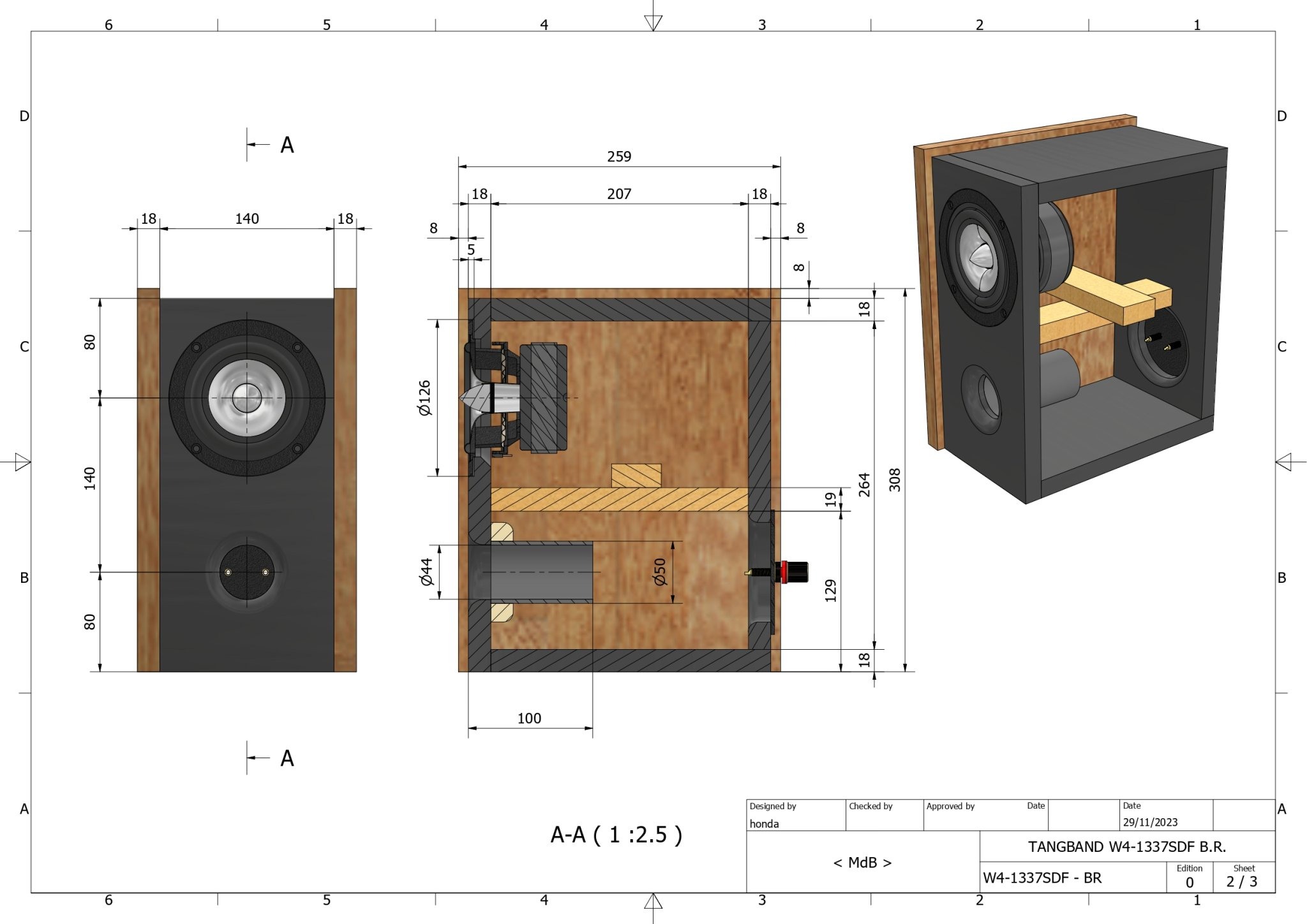

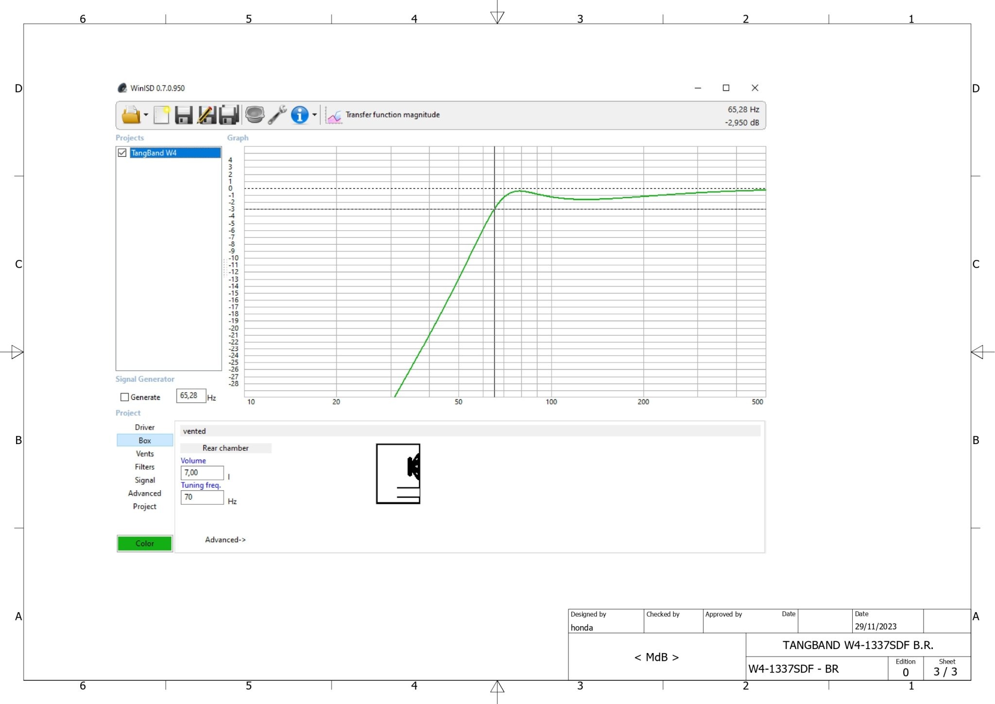

Updated with the standard HP35 BR ports which I have here on stock.
