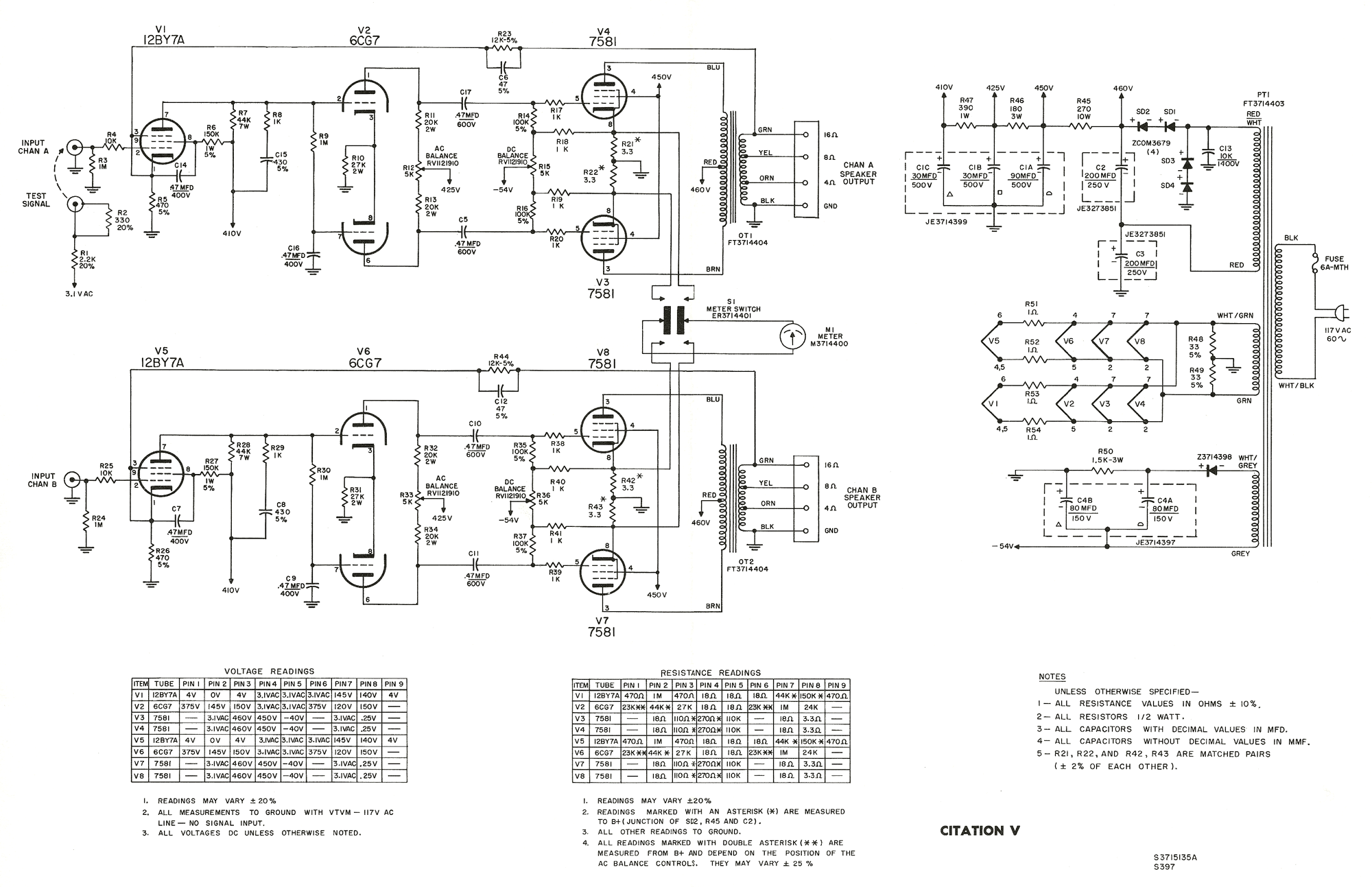

What does the speakers' impedance look like. Speaker manufacturers "spin" their spec's. If the nominal impedance is 8 Ω and the curve is reasonably dip free, the 87.5 dB. sensitivity can be regarded as true. OTOH, if the nominal impedance is 4 Ω and substantial dips are part of the curve, forget tubed power amplification.
The common "falsehood" is specifying sensitivity with 2.83 V. of drive. That's 1 W. when working into 8 Ω, but 2 W. working into 4 Ω. Derate the claimed sensitivity by 3 dB., in the 2nd instance.
Paul Joppa has provided us with a rule for matching amps and speakers. Joppa's Rule states that for "typical" listening spaces an amp/speaker combo should be capable of a 102 dB. SPL at a 1 M. distance. If the 97.5 dB. number is accurate, you need upwards of 32 WPC.
The 6Π3C-E (6p3s-e) in a PP configuration will get you that power. I suggest you build along the lines of the Harman-Kardon Citation V, which is a superior implementation of Mullard style circuitry. The 7581 shown in the schematic is a somewhat more powerful 6L6 family member than the Russian 5881 equivalent.
