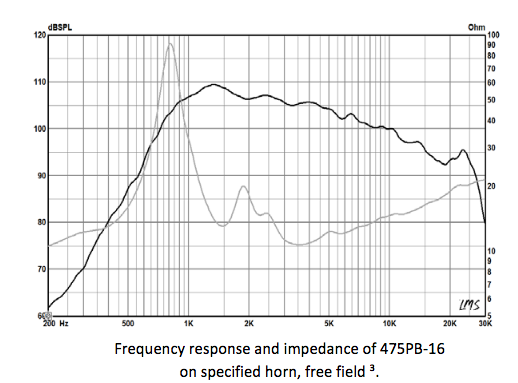

Have you tested the 475PB on your 511b?
On the little horn Radian uses for testing, it is only -3dB around 800 Hz- output in that range should be quite a bit more with your 500 Hz horn.
Riley, the 475PB uses a Mylar surround, it's not "all metal".
It also has more extended HF response than the Altec 808b.

FWIW, if you want to use them as basically WGs [~bypass the expo flare], then XO ~1200 Hz/811 and 900 Hz /511.
Decades old Danley 511 measurement [Radian IIRC]:

But isn't 800 too low for the 475pb?
I also have a buttcheek JBL. Gonna dig it out and look at the model.
Big E,
Any HF driver will have two limiting factors- excursion and power.
Excursion on any HF driver is limited to a bit under 1mm before the diaphragm contacts the phase plug, which sounds horrible, and will crack aluminum diaphragms after a fairly short period.
800Hz could be "too low" on a horn that does not provide loading below 800Hz, but just fine on a horn like the 511B that does.
In the "olden days" of horns that provided loading down to 500Hz, drivers would often have two power ratings, lower power at a lower frequency, double that at a higher frequency. Those ratings have mostly been eliminated, since they are horn dependent- the driver might be able to take 25 watts at 500 Hz before the diaphragm hammers the phase plug on the 511B, but only several watts on the JBL 2342.
Art
