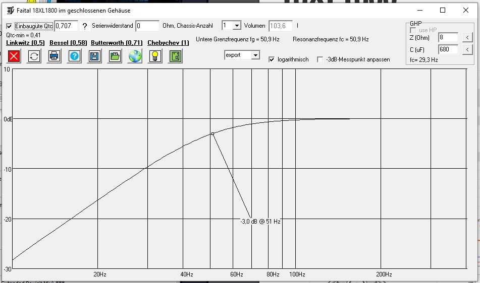

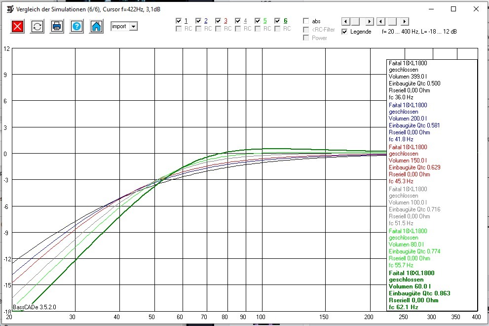

Suggested capacity box BMS 18N862
Yes, it is.
You can get a simple simulation program here.
