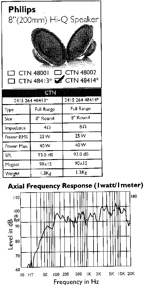

It would be ideal of course to have one driver provide the full midrange spectrum and a bit beyond ..say 100 Hz to 10 Khz. There are many ( single) wide range drivers ,but do they do it very well ? Any recommendations ? Would the Hemp FR8C fit the bill ?
My OB with an Alpha6A and APT80 sounds very good but mid range is smoother on my Mission 701's. Maybe the crossover on my OB needs to be checked too. It does measure reasonably flat as it is. The bass unit is a 12 inch Peerless 831857 driven via an active crossover. Overall sound is better than the Mission.
We get a Philips 8 inch dual cone driver in th elocal market that does 100 to 10 Khz and a bit more. It is OK for background music but it does not have a nice midrange as might be expected from the rough frequency response. And it costs about US$5 .
