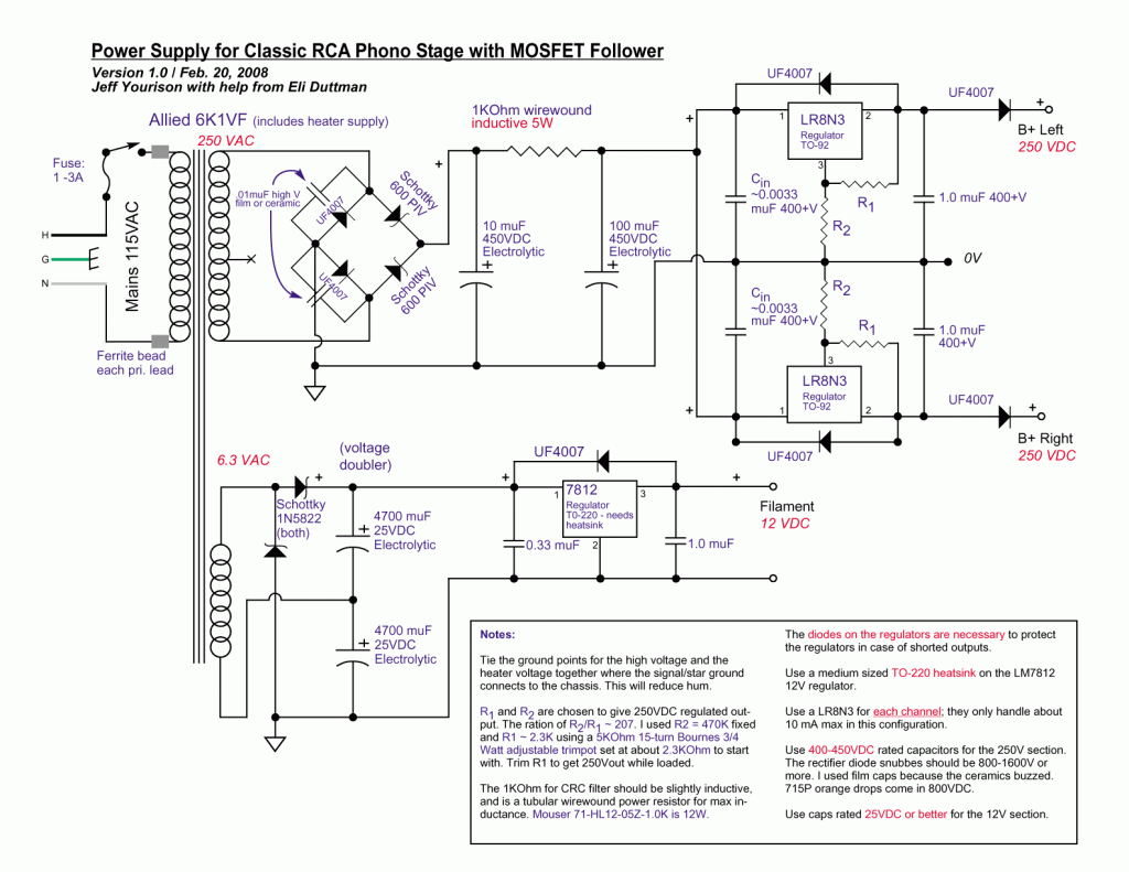

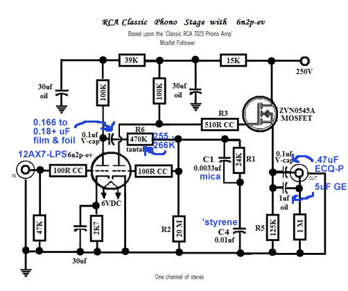

As a starter I'm thinking of building Eli Duttmans' version of the RCA phono schematic.
A phono preamp is not a simple project. Definitely look before you leap.
JMO, the tweaked RCA setup is good, without being highly complicated. Those folks who've built the setup are happy. 😉 I've uploaded a graphic for a cost effective PSU that's quite suitable.
Contact member Jeff Yourison to obtain the benefit of his construction experience.
