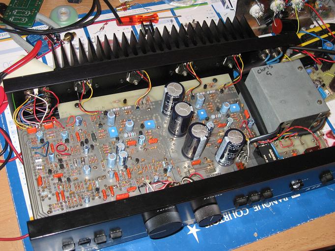

So sorry, I forgot....
I think that's an old version (mkI ?) with radiator on the back.
Michel, I sent you a mail with hires pictures.
Forum is limiting the size of the picture, so I include only lowres picture here.
The relay is sitting just near the phones plug, I can hear it's click a few seconds after power on, I suppose it to be a mute, perhaps a protection relay.....
Thanks for the help
Thierry
Thanks for the help
Thierry
Apologies Lee,
The post, with accompanying image, from mgm31 gave my memory, a needed jolt!
The A28 (heatsink in the back) does have a speaker relay.
I don't know how I could have forgotten that since there is a recurrent problem with this relay, or not exactly the relay...
If you look closely at the image, you see two twisted wires (red and brown) beside the power transformer that are going to the main pcb. Right between where the wires are soldered, there is a small electrolytic capacitor. If you look closely, you will see that this capacitor is not the same color as the other ones, or should I say, not the same color anymore!! Too much heat as that effect on capacitors external jackets. They usually get a darker "tan" and sometimes "grow" short pants! This particular one has waaay too much on its plate. It is used in the circuit that operates the speaker relay and when it is not working properly, this is the first place where you should look. Always replace it with a capacitor of the highest voltage rating possible, as space permits. 105º C is mandatory!
The specifications for the BC639/640 and BD139/140, as destroyer X writes, are indeed very similar. You could easily replace the two drivers and bias transistors of each channel with them. It is made even easier by the fact that they have the same pinout.
I usually never do that kind of switch as I have a lot of respect for the choice of parts the designers made to build their products. Especially if the part is in the signal path!! I usually request their approval to do it and I will only do it if I can no longer find the original part or in the case of a part that is breaking too frequently. You have to understand that I do that because I feel I am professionally bound to the manufacturers the company I work for represents. I believe that even a technician working in a repair shop should follow that "code" when repairing a customer's defective unit, but that's another story...
Best regards all,
Michel
