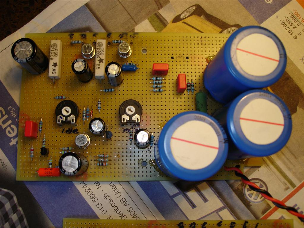

vero boards revived ...
Looking back at this thread: most reactions say that nothing wrong with veroboard vis-a-vis pcb. As you can see I have both (own designed) pcb's ánd clumsy veroboards. Maybe the clumsiness of the veroboards give the old-fashioned design (and sound ...?) more credits, blabla. In the end I returned to veroboard, mainly because they are great for experimenting and fiddling around (for me, that's big part of the hobby, gave up about building an amp and never touching it again just to listen to it).
So here a few pictures rounding up the discussion (and so you believe I actually tried some things).

Please permit me my foibles (is this correct english?). I Have Built it (almost) all. Hiraga, linsley hood, several Pass amps, class a, class b, class d, Push pull, single ended, tubes, triode, pentode, otl. And stlll I like my sugdens. Not so Bad a Tree to Bark at.
happy marriage between sugden A21 and musical fidelity A1?
Here in summer heatcase temperature became too high. So I peeked around in my attic and found half of a musical fidelity top. So now this helps cooling down the temperature with 5-10 degrees.
This now is some groundplane for me to experiment with small single ended class A amplifiers. I have JLH-mini lying around that could fit the bill and the pass amp camp amp. All these can work allright with V+ of around 24V and all have roughly the same range of idle currents and dissipation.
BTW: I listened shortly to the Sugden through a 24V laptop power supply (a beefy one, around 6 Amps). But to my ears this is a few notches back for my listening pleasure. I came to the same conclusion a few years back when I had the ACA (amp camp amp) in operation (at that time I started with the laptop supplies as the ACA was designed with just that as one of the starting points).

Thanks James for the reply.
I can confirm all of your remarks.
When I saw the temperature rise to uncomfortable high levels (I measured around 60-65 degrees C at the fins when the environment had around 30 degrees), I firstly got down the idle current from around 800ma to 500mA. Problem solved, total dissipation for both channels down from 40 Wats to less than 30 Watts, 10 degrees down. Still hot at 55 degrees, but doable.
After some hours of listening I got the idea that the sound had changed somewhat (not to the better side of things). These things are tricky and I cannot say for sure if it's in my head only. But had the wish to go back to around 800mA to be sure.
Then I took an old 12 cm fan from a former PC and slowed down the RPM to less than 1.000. Almost silent (only to be heard with your ears next to the fan itself). I put it to blow alongside the heatsink. The temperature now stabilizes at around 40-45 degrees. I can now experiment with still higher currents (the amp camp amp and JLH go even higher to 1-1.3 Amps because they are single-ended and therefor less efficient).
Now I returned to greater heat-sink area, this also works allright, stabilising temperature at around 50 degrees C (remember the temps are extreme here now, so expect 10 degrees lower during normal times). So I can experiment with 1 Amp now without problems.
See picture for the fan that I used. The 'power supply' was salvaged from a ladyshave (12V DC). Well, that's real old fashioned mixing all kinds of rubbish from the wastebin! I think I remember that Nelson Pass once said it's this kind of flic-a-flac diy electronics he likes most.
