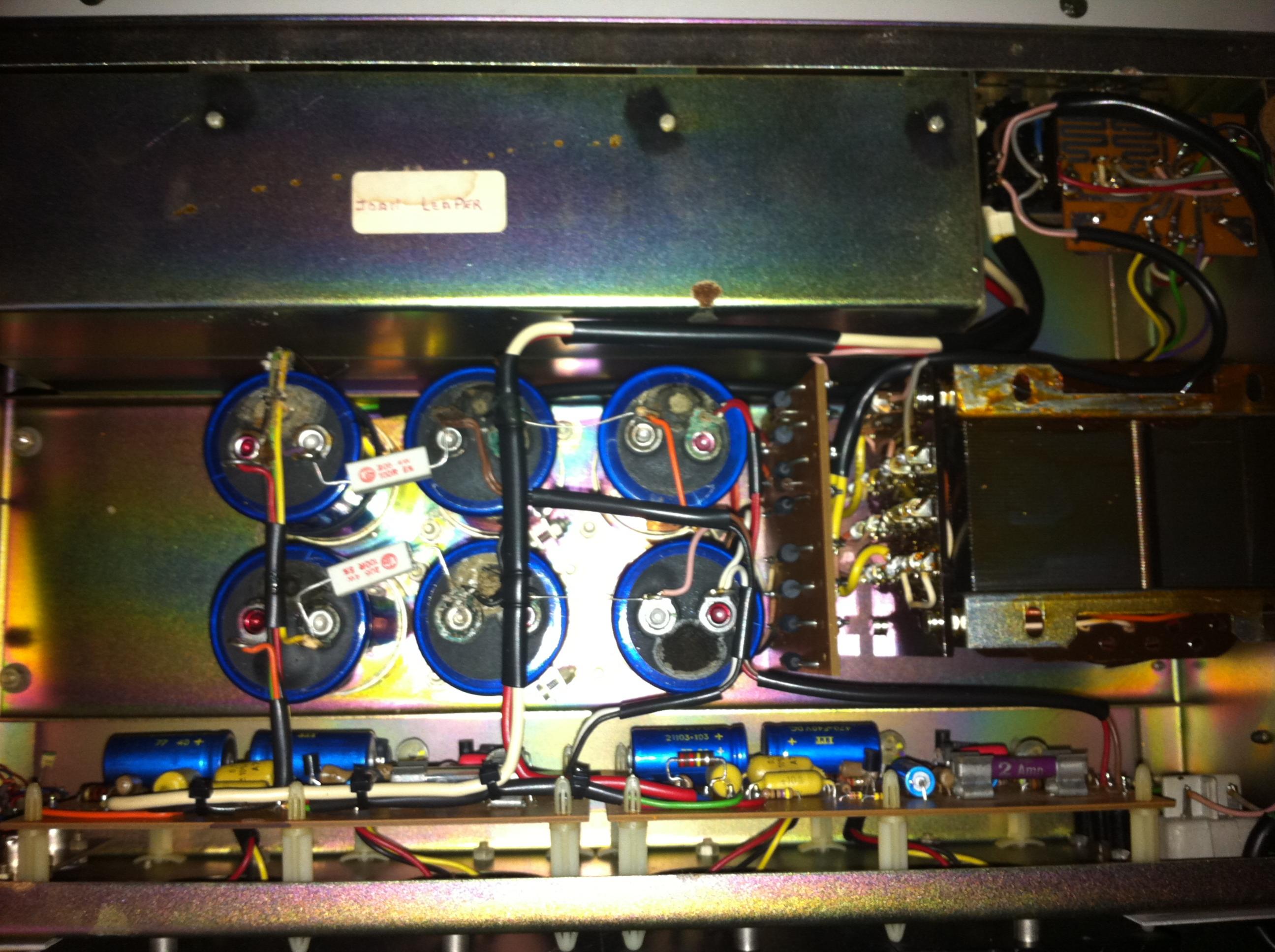

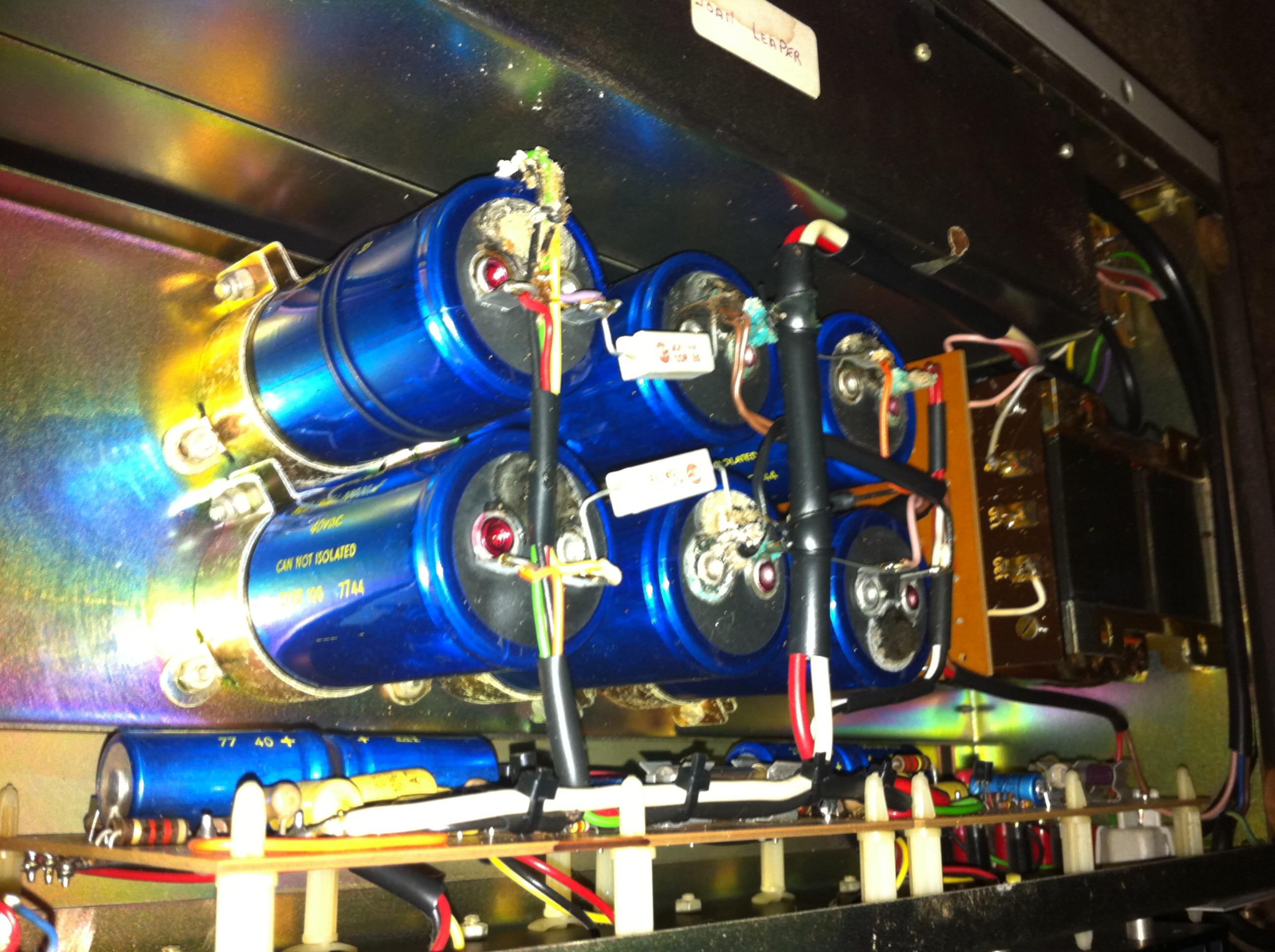

Sugden A-48 Inside photos
Hi Andrew
Thanks for your information. Here are a couple of photos of inside of the A-48. It has a single PSU. I think I do have the original manual with schematic diagrams somewhere. I will find it and upload them here too.
I will wait for more of your information prior to ordering the caps. I am trying to get the best ones for the reliability, compatibility and performance.
Thanks & regards
Dan

The second pic shows two bridge rectifiers.
I seem to remember that the A48 is a capacitor coupled output and uses a single polarity supply for the amplifier.
If that is the case then you have 4 PSUs in there.
1pr of 10mF for channel A output stage
1pr of 10mF for channel B output stage
1 off 10mF + 100r for Channel A input stage
1 off 10mF + 100r for channel B input stage.
Measure the voltage from chassis to all 12 pins on the caps. Keep the black probe on the chassis for all the measurements.
You have a bit of strange thinking here with an A48
The transformer has two secondaries 1 for each channel its a kind of halfway house in between single or dual power supply it shares a common primary this will give improved channel seperation
To complicate things further each supply is split into two not as in a normal split supply amplifier but as a method of voltage sharing between the supply capacitors
That acounts for 4 of the large capacitors
The other 2 are output capacitors the amplifier is not! dc coupled to the loudspeaker
Please remember when the amplifier was built capacitors were not as good as modern units
As mentioned earlier modern units with a higher capacitance and voltage can be fitted with advantage
When I mentioned by passing the supply capacitors with a 0,1uf this is in order to improve the high frequency response /stabilty of the amplifier all it is is connected the smaller capacitance in parrallel with the largs 1
regards Trev
