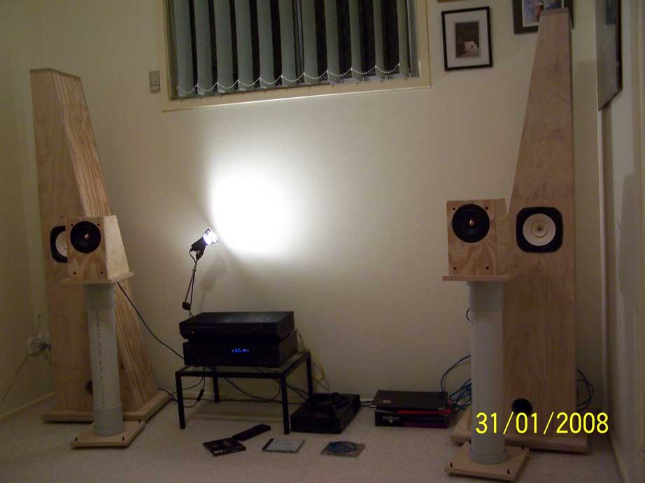

I build a pair of Dave’s Aperiodic speakers (CSS FR125) the other week and after playing in the shed and main living room, really wasn’t to struck on them. Have just plugged them in to the office system – ha – 100% better in a small room. In this environment these little guys far out play their size.
Just playing Modern Times while typing this and Bob and the band are in the room with me. These’d make a great small room system or superior computer audio. However the CSS driver are not as efficient as something like Fostex drivers, so wouldn’t think a T-amp would drive them enough.
I had access to WR125s a while back as I built a set of HT8’s for a commission but think I prefer the FR’s as a single driver.

And in that room those 206 or 207s must be mighty powerful. Knowing the size of the drivers those cabinets must be huge.
You really, really, must stick some phase plugs in them, you won't regret it.

IMO, the Fostex and FR125's hit completely different targets. Fostex's seem to be purpose built to work with tubes; the 125's seem happiest with mid-power SS.
My FR125's live in BIB's in the corners of my bedroom, hooked up to an old Yamaha receiver tuned to the local NPR classical or jazz stations. They work very well in that setting. The SS amp takes control of the bass and makes efficiency a non-issue, and the BIB makes plenty of bass and does a surprisingly good job of controlling excursion. I don't feel a need for a tweeter, but my HF hearing is kind of shot (tinnitus), so YMMV there. I've not tried them with my SE tube amp, but I don't think it would be a good match.

With any SE amp (SS or tubed any size) the FR125 are going to sound bad. But if you have a typical HT receiver (or typical low damping factor amplifier), you are going to be much happier with the FR125 than the Fostex.
With the Fostex that HT receiver is working right where the notch distortion is the worst... it sounds crappy. That the FRs have lower efficiency pushes the HT receiver to a place where it is much happier and better sounding.
You cannot judge a speaker independent of the amplifier(s) it will be used with.
dave

Arn't those little cabs that he built for the FR125's the aperiodic cab he's talkin about? The ones in the pic on the first post?. If not, my mistake, I just assumed they were... Also great work on both those cabs, they look really nice...
BTW, I didn't mean it as a slam against the FR125, just that for the same price you can get a 127 or 126 Fostex, and I'd still prefer to have the Fostex even with a HT amp, but that is just me.. Dave🙂
Actually now that I look at them closer their not the Fonken, the Fonken has the slots on the front... I guess when I took a look at the size and read that he built a pair of Daves aperiodic enclosure's ,I assumed they were the Fonken., sorry bout that.. Dave 🙂
Yes, but they aren't Fonkens (a Fonken by its very name has Fostex in them Fostex-ONKEN =FONKEN 🙂) These are called 4.5 litre Aperiodic ... no-one has come up with anything more imaginative for them

I’ve only just found that I need to give the CSS FR125s enough juice to get them singing, so yes compared to the Fostex they are inefficient. Now it’s not fair to compare what you see in my original photo but the ML TQWT’s need a larger room than my little office so in that situation I prefer the aperiodics.
Yes I’d agree Dave FR125s didn’t suite my valve set up but driven with my old faithful class A Musical Fidelity A100 cranked up more than usual they sound great.
