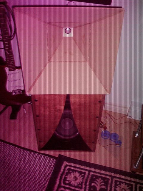

I've build such a 2-flare conical a few years back. Still not a free lunch, as all horns are bandpass devices. It was quite large, but perhaps not enough to go down to 150Hz. Using the old Fostex FF125K, which has about as much a rising response as any driver in its size class available today, I still had some loss in the upper treble and above. A 150Hz equivalent would only be worse in that regard, especially with a flatter response driver.
attachment.php

I'm running / testing multiple horns for exactly this, using a 4" pro driver. In a simple conical horn with roundover to a 60cm wide baffle, I get similar response to what x posted for his horn - a shelf of boosted output from 300-3000Hz, with lower output up to 15kHz. (i get dead flat response down low, and peakier up high, but overall very similar, and possibly mostly different due to measuring differences). A bigger horn (80cm wide and 40cm high) went lower, but not to 150Hz, so I think you might have to settle for a 300ish low end on the horn if you want something reasonably sized.
Massive equalization works well, but something else that seems promising is basic crossover on the horn and a fill / scatter tweeter. That is: an efficient tweeter firing up and backwards at the roof so that the HF fill is dispersed and delayed.
