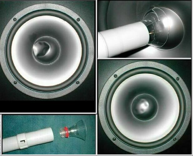

I recently "undented" the dustcap of a speaker with a vacuum cleaner. It was quit easy, like this:
1st tried to suck out the dent with nozzle only. Did not work. Then cut off the neck of a plastic bottle and put it inside nozzle. Then closed "sucktion control" fully. Dent then slowly start coming out. About 30s later it was almost 100%.

Before and after:

you may be able to get rid of the remaning smaller dents using some sellotape. It's worked well for me in the past...
Vacuums are great! I punched in the cone on my brand spanking new Audax HMs after mounting them in my enclosure. But, as I lifted the speaker (with screwdriver in hand), I noticed the the cone was popped in...F (fill in blanks). Grabbed vacuum that Mom had told me to put away hours later...and voila!
