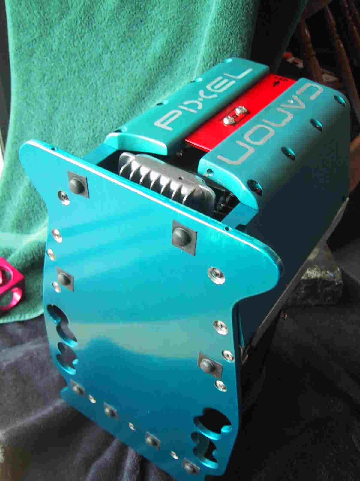

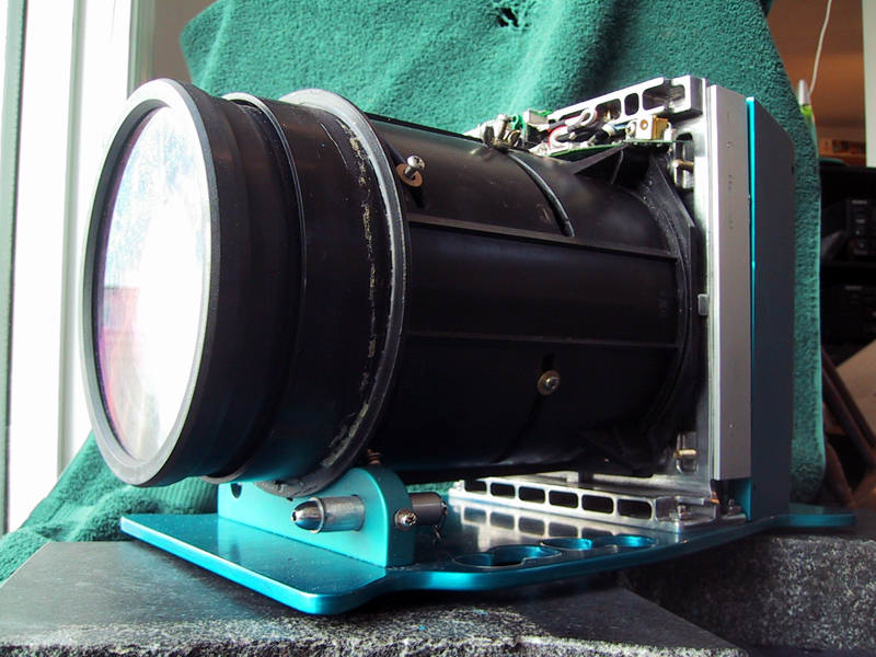

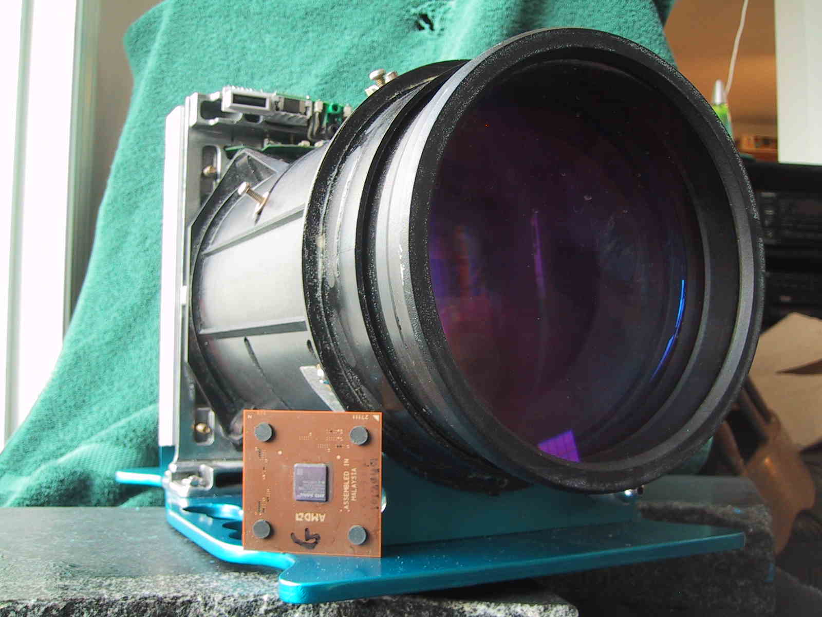

Hope you guys find this interesting. Biggest disappointment is the resolution of the PS-ONE LCD. I'd love a higher res LCD but must remain at 5" to retain the contrast/cooling benefits of the panel immersed in the liquid portion of lens. Lens is from a CRT projector.

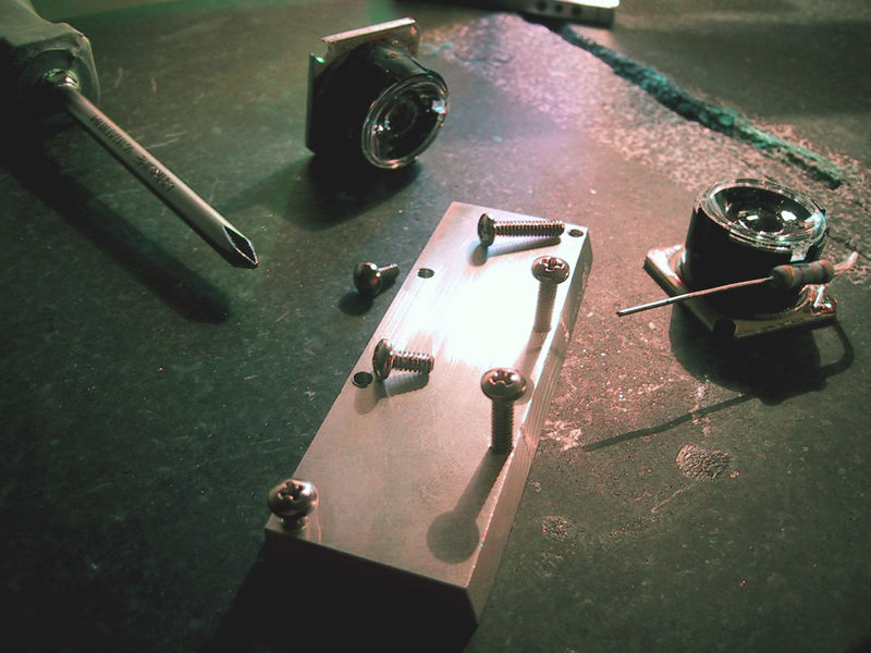

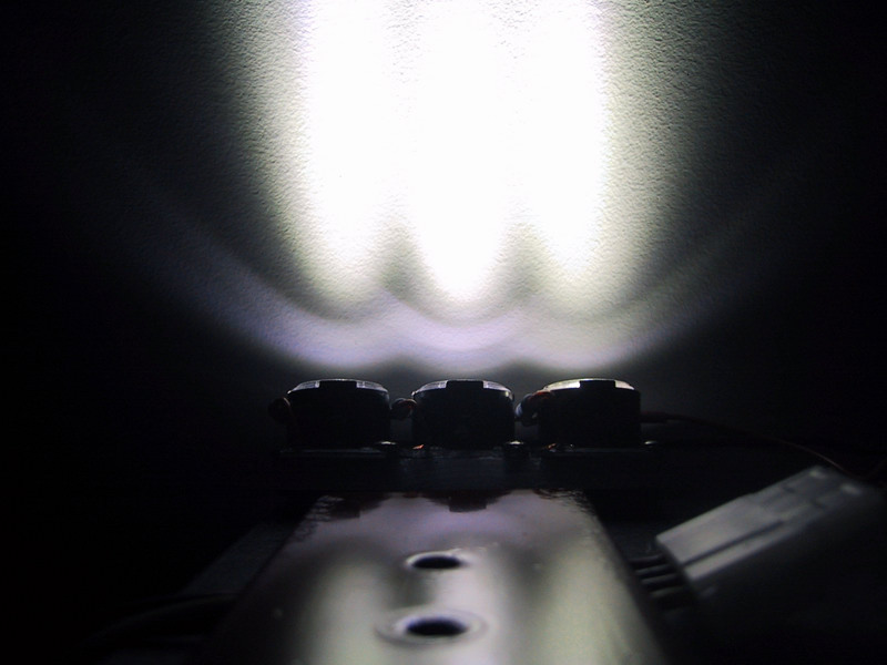

I designed the backing to be swapable from LED and common light sources. As yet, have found no need. These LED's make massive light also a big plus in my opinion is the total lack of any fan. Runs 100% silent.

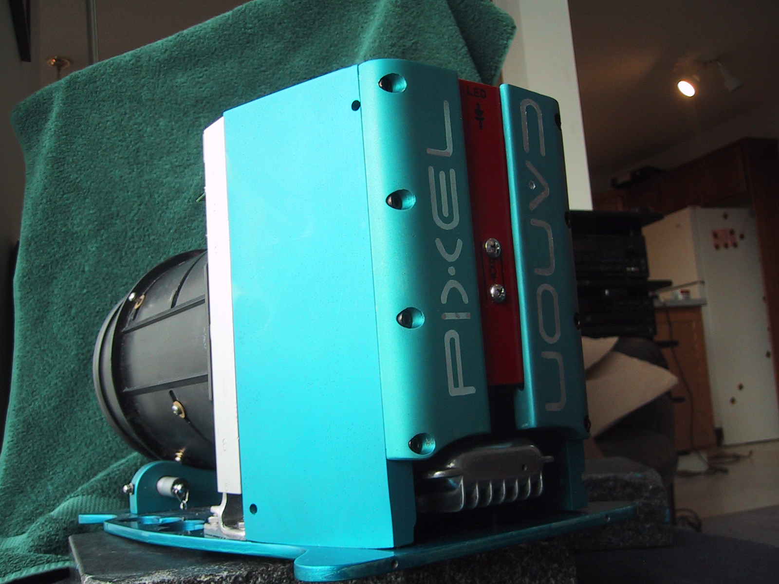

I sandblasted and then anodized my parts as well then dyed them. The significantly strengthens the parts. Not such a critical feature for this project. But also allows you to dye the aluminium metal itself making it very scratch and dent resistant. The color becomes part of the aluminium oxide layer coating the aluminium. Far better than paint or powder coating when speaking strictly of aluminium.

Yes the Lens is adjustable and focusable for different throw distances etc.

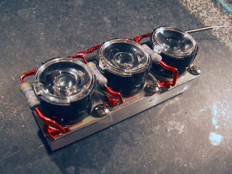

I use 21 of these LED's the called luxeon Star Batwing's they incorporate their own collimator lens within the LED itself making for a very nice and compact solution. They are too bright to look directly at and infact it is not recommended by the manufactoror that you do so at all.
www.luxeonstar.com
I was lucky enough that a local electronics shop carries them instock. Also keep an eye on these guys as I have an inside source that claims they will soon release a 5 watt per single white LED solution. Thats scarey bright for so little power and size.

They are already out and you can buy them, though they are about $50 each. The colimator ones are the ones to go for. Unfortunatley they dont have that lens adaptable for the 5w led yet but as an alternative its very easy to make your own collimator lens or to atleast source them for very few $ each.

The 5 watt has been out for a long time. Development on this product is unlikely to progress. The 5 watt white has a limited life w.r.t. light output. The best one for development is the LuxeonIII. It is sitting at 65 lumens when ran at 3W (30% down after 50,000 hours), or 80 lumens at 4W (50% down after 20,000 hours). I think you may need a new insider..... 🙂
