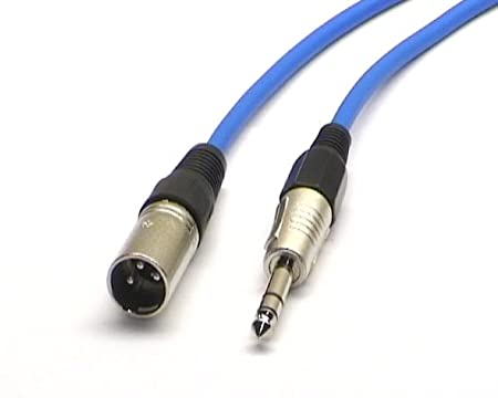

me thinks there's a pinning problem at play....and someone else needs to looks at the very first pic in those uploaded, seems to,without a better view from the pic that single ended adapters are at play????
also looks like the x-over is not engaged on the JBL and with the Mackie the output is fullrange so thru put only with no level match??
but it's not what i think the OP is using, sorry...
and depending on what the actual topology of the "balanced" out is what's happening is a crap shoot.
Well the image I posted is the cable I'd use with a mixer with TRS balanced out going to a speaker with XLR balanced in.
What would you use ?
