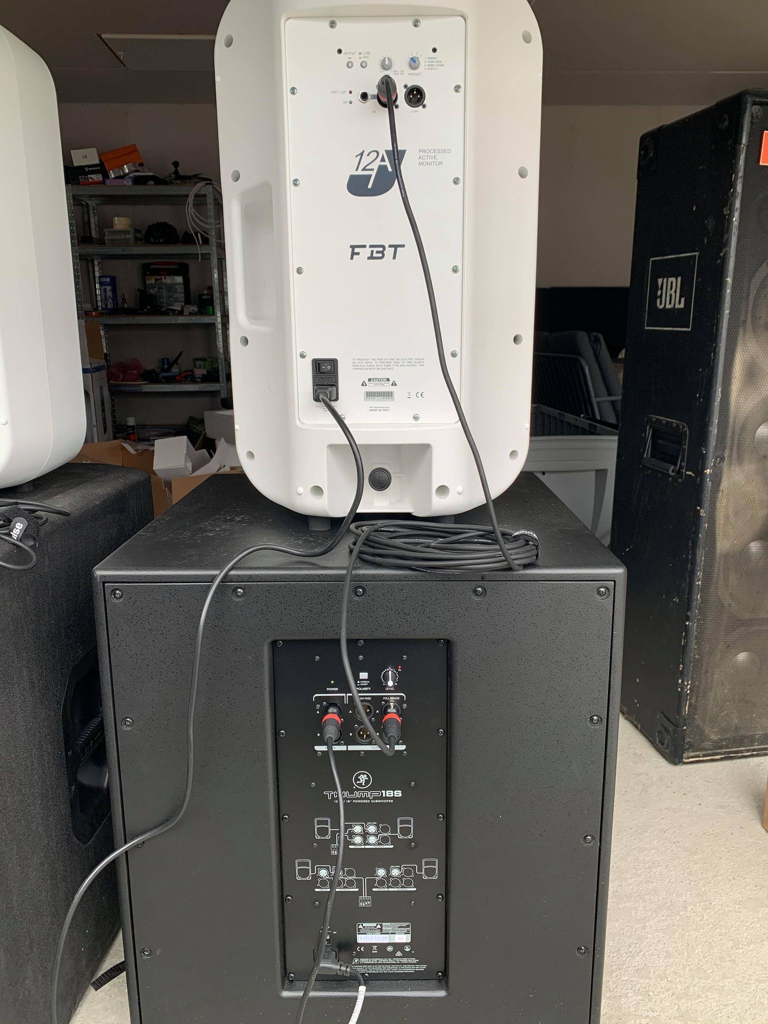

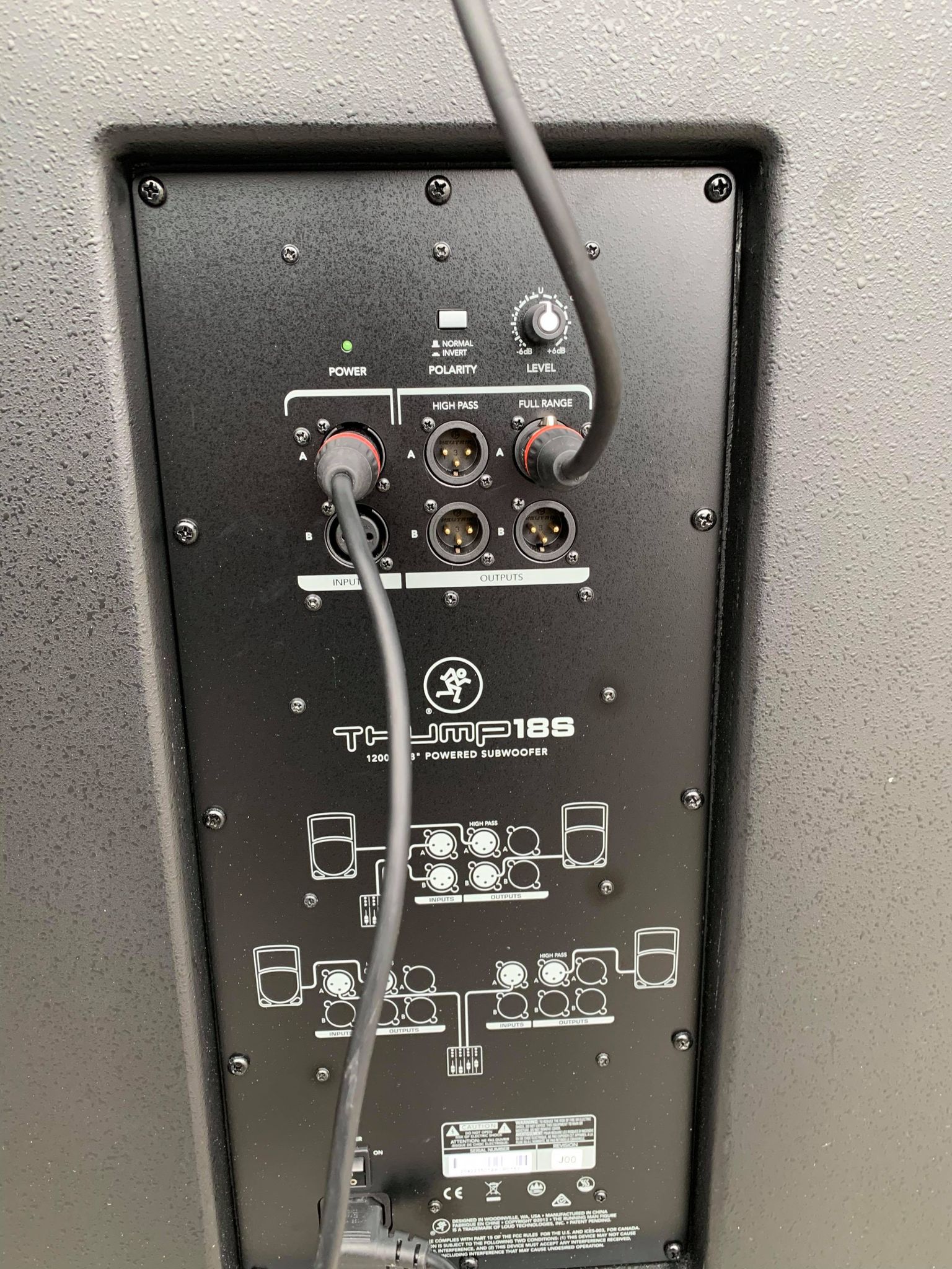

i have been trying to connect my subwoofer to my Speakers and it wont work. i tested the sub without the speakers and they worked just fine. when i turn on the speakers the subwoofer stops playing what can i do to fix it? i have a mackie thump 618s subwoofer connected to two fbt 12a speakers.
You appear to have active speakers and an active woofer. Can you show us how you have these hooked up.
i have my mains from the mixer into my subwoofers then linked them to my speakers. I have tried the other way around so from my mixer to speakers then to my subwoofer but wont work either

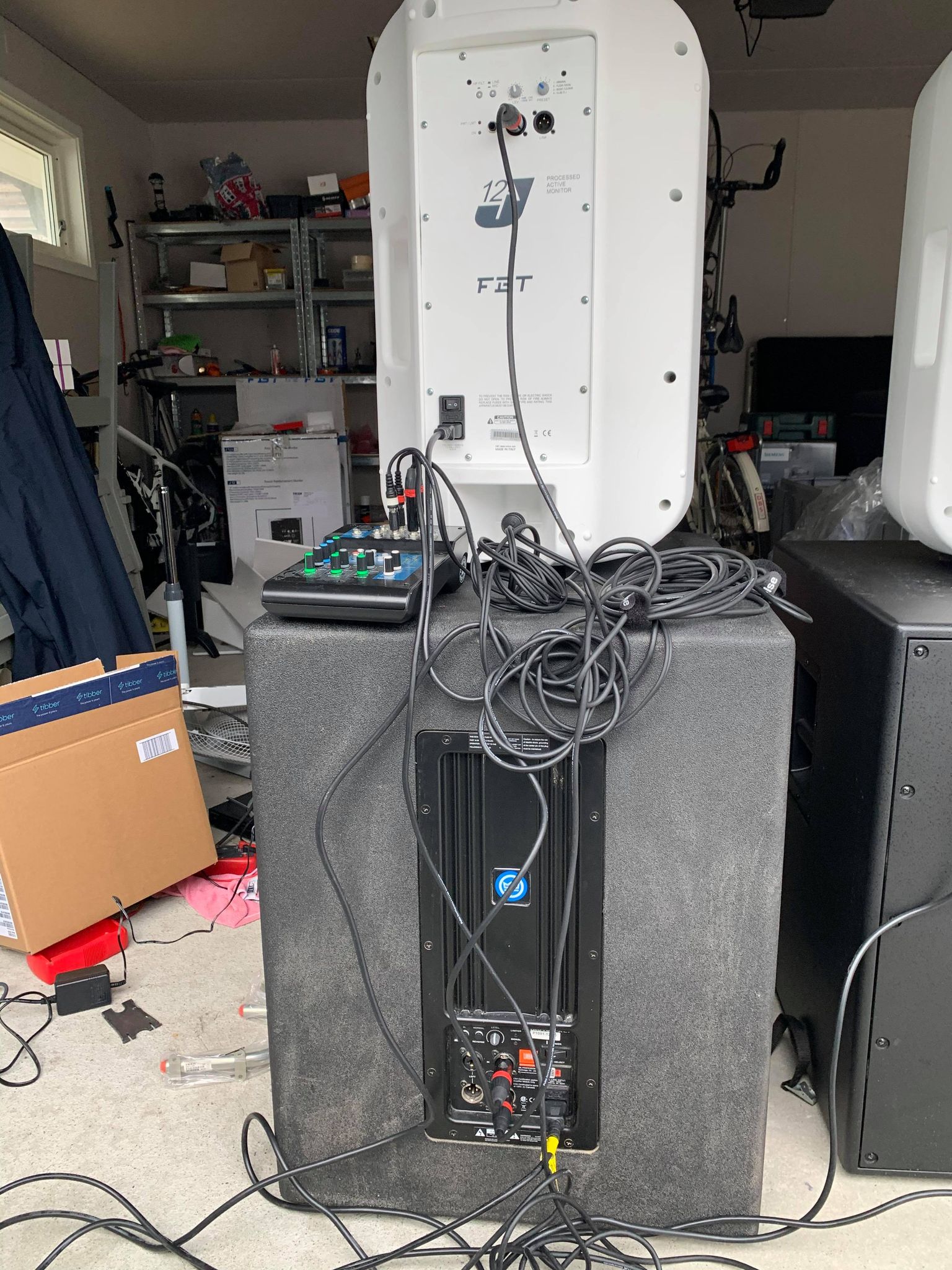

no put my ears towards the subwoofers no sound from them i have a topp pro mxi.5 mixer small thing but works.
if youre thinking about the sub with the speaker on top it doesnt work with it, but if youre thinking about the tall one in the corner its not working at all right now

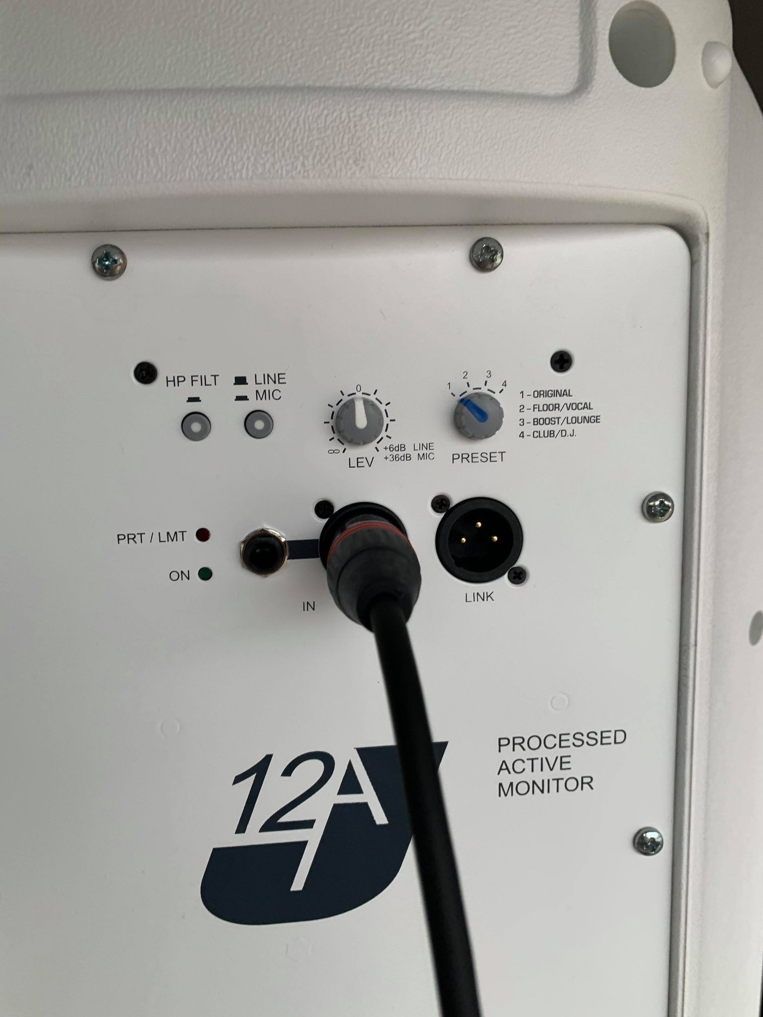

2-Make sure your LINE/MIC push-switch is set on LINE on your 12A because since both fall paralleled the impedance seen from the mixer could be too low leading to a significant drop or total cut. Remember both are active amp. so input are LINE level.

I thought it looked like the main speakers were set for mic input rather than line input too...
Make sure they are set to line in then turn the subs and tops levels down as low they can go.

Also check whether your mixer has a high pass filter option in case it isn't sending any sub bass content out to the subs.
Also make sure you are using balanced TRS connectors on the mixer outs and not mono ones.
