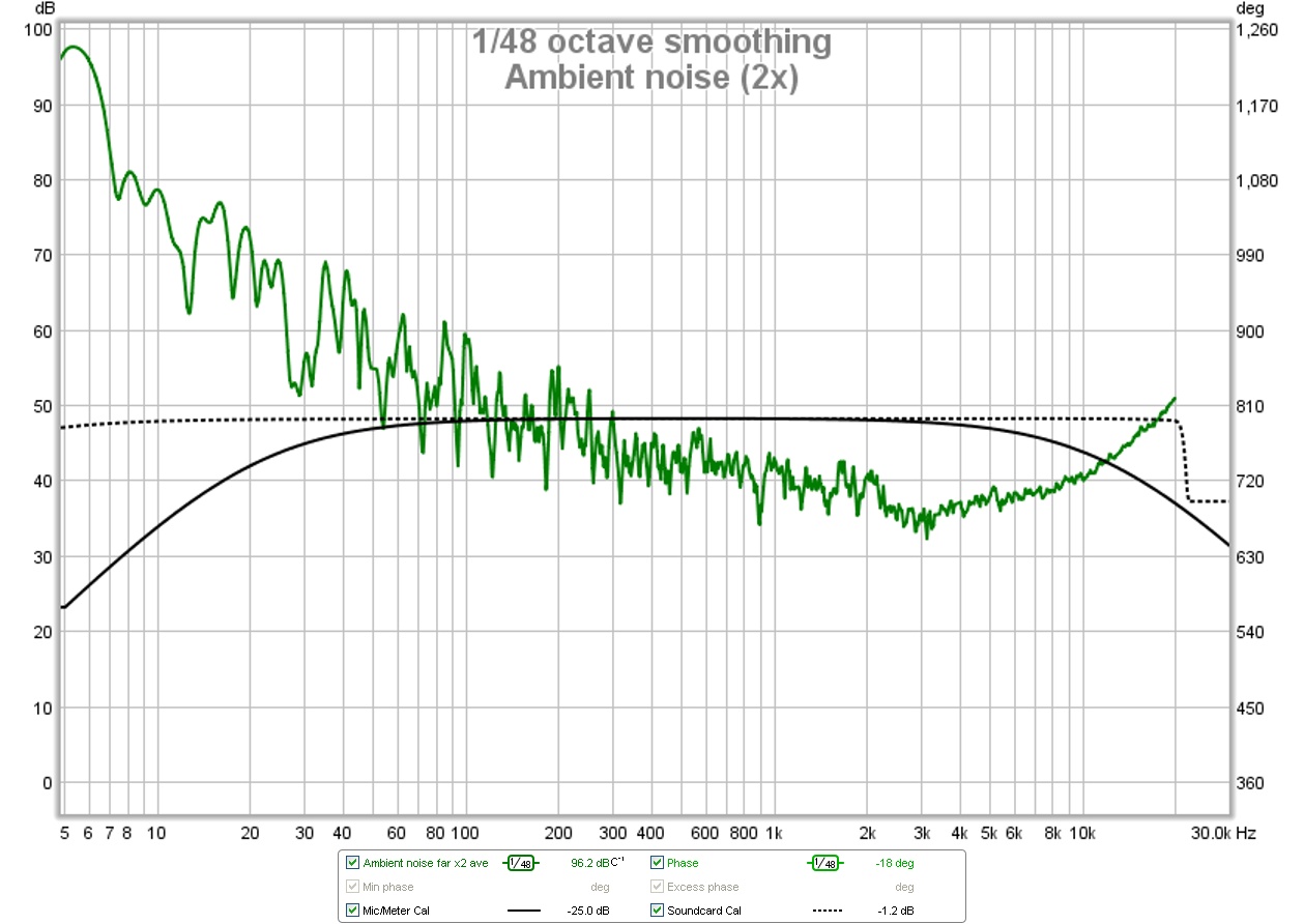

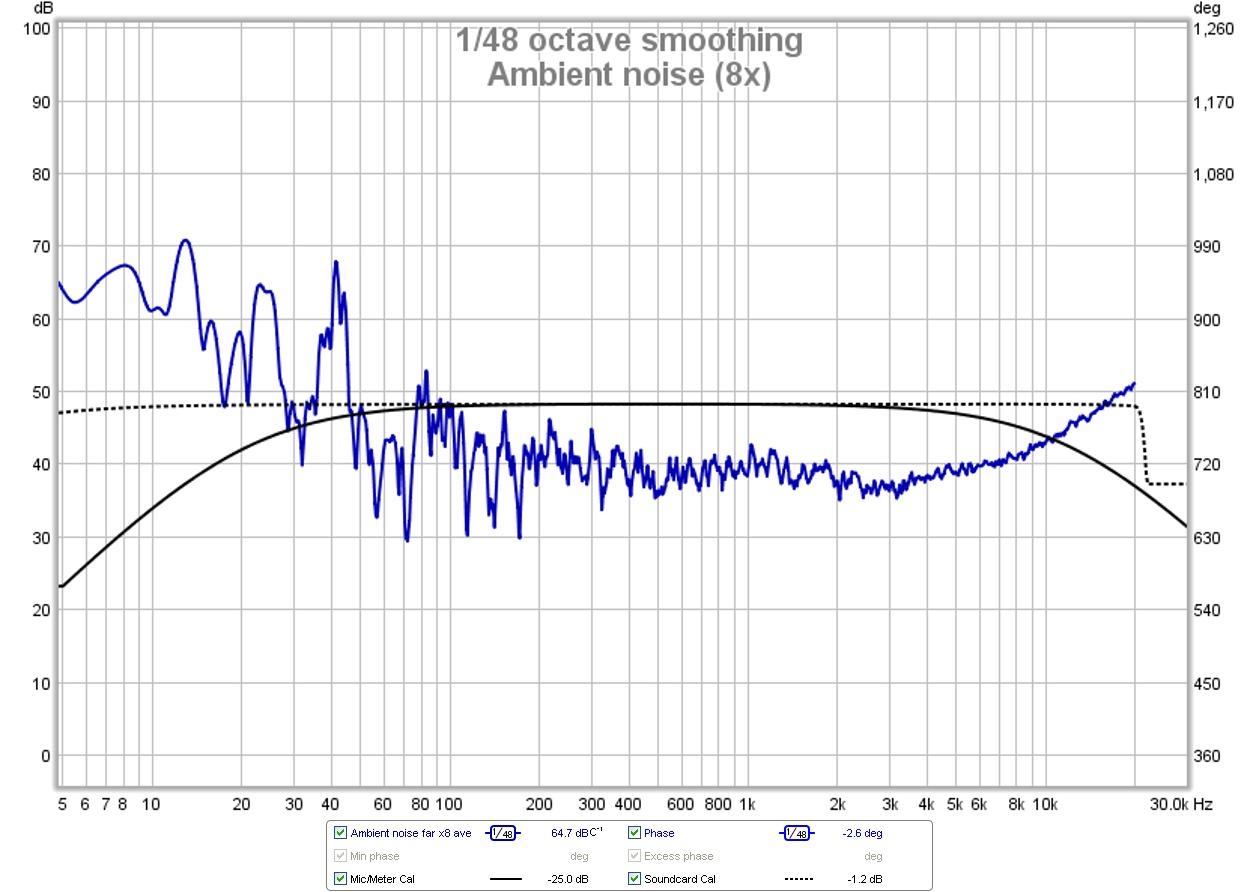

I am sure that you will be amazed of what "silence" in your room really is!
So true!
“Silence” in the middle of my living room.
First screenshot is average of two measurements, second is average of eight measurements.
Each measurement has a duration of 5.9 seconds. The mic has a “C weighted” response.
I have checked it (it seems strange but it is true).
By averaging more than 4x recordings of the ambient noise in closed space, one can have the exact signature of room modes without using frequency sweeps for excitation. (Should I apply for a patent? :) )

That's a lot of energy at 13-14 cycles, was your air handler running?

"By averaging more than 4x recordings of the ambient noise in closed space, one can have the exact signature of room modes without using frequency sweeps for excitation. (Should I apply for a patent? :) )"
Clever!

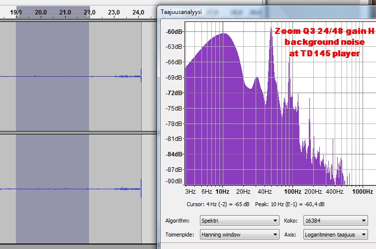

Ambient noise near my turntable, measured with Zoom Q3 and "analyzed" with Audacity. That 50Hz is my PC 1m away from the mic.

Jahazi,
Well there is the 50 and harmonics popping right up there! That is really a lot of low end energy. I would think you would sense it. Traffic? Air handler? Are you sure it is not a measurement artifact? It seems pretty broad band. FFT's can do some rather odd things.
