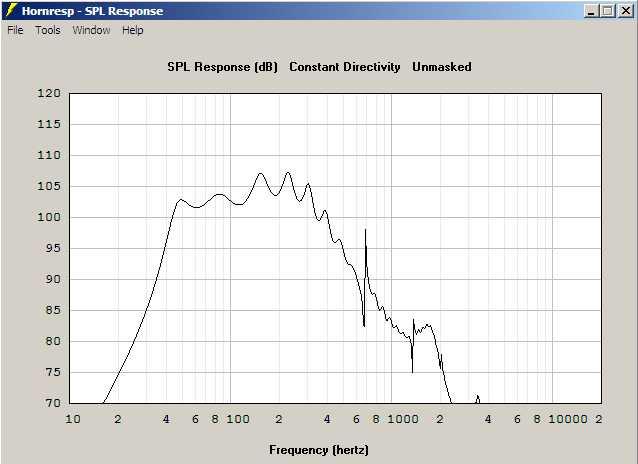

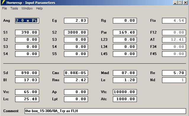

Hi Y'all,
After trying this woofer in a number of Hornresp models, the only subwoofer for the driver "the box 15-300/8A" that I kind of like is a front loaded horn (FLH) of about 362 L_net, I'll attach the Hornresp Input and SPL screens. For a suggested construction (and size comparison) see the Vitavox Thunderbolt (estimated net volume = 560 Litres) The unofficial Vitavox website- Thunderbolt. There are lots of nice 15 inch driver FLHs out there, and with Hornresp (and AkAbak) we can actually simulate their response.
