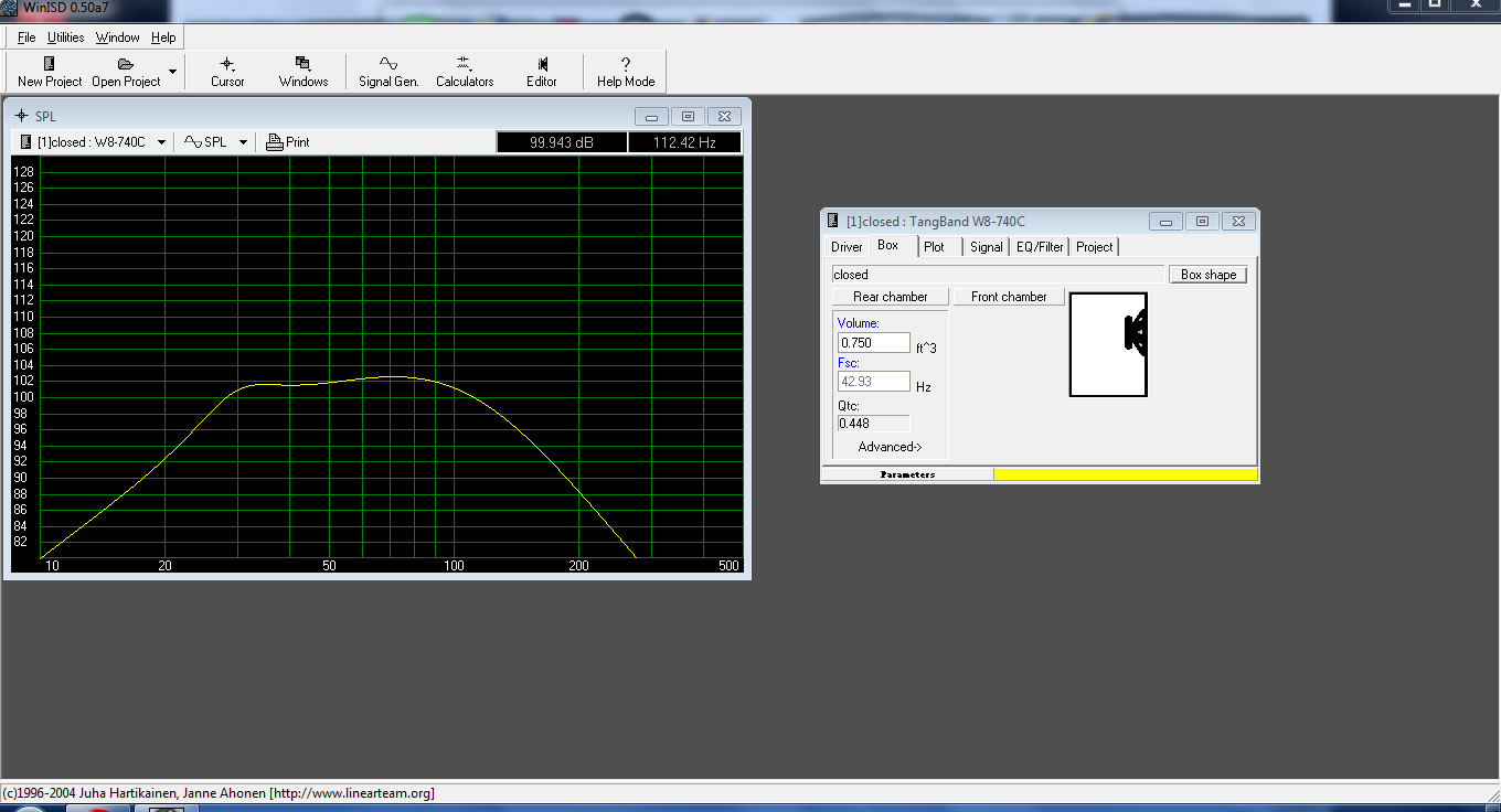

I have no experience with the w-5, but yes I would seek a driver intended for sub duty. I built some tapped horns with the 1139 that perform well. I've also been tinkering in winisd with the 740, as I bought 2 for cheap on cyber monday. Sims are promising- 0.75ft3 sealed, factoring in 6db boost @ 30hz and a lowpass @ 80. I tried simulating ported but the driver specs call for such a long port it wouldn't be possible to fit a port in a modest sized cab.
Here's the sealed response.....

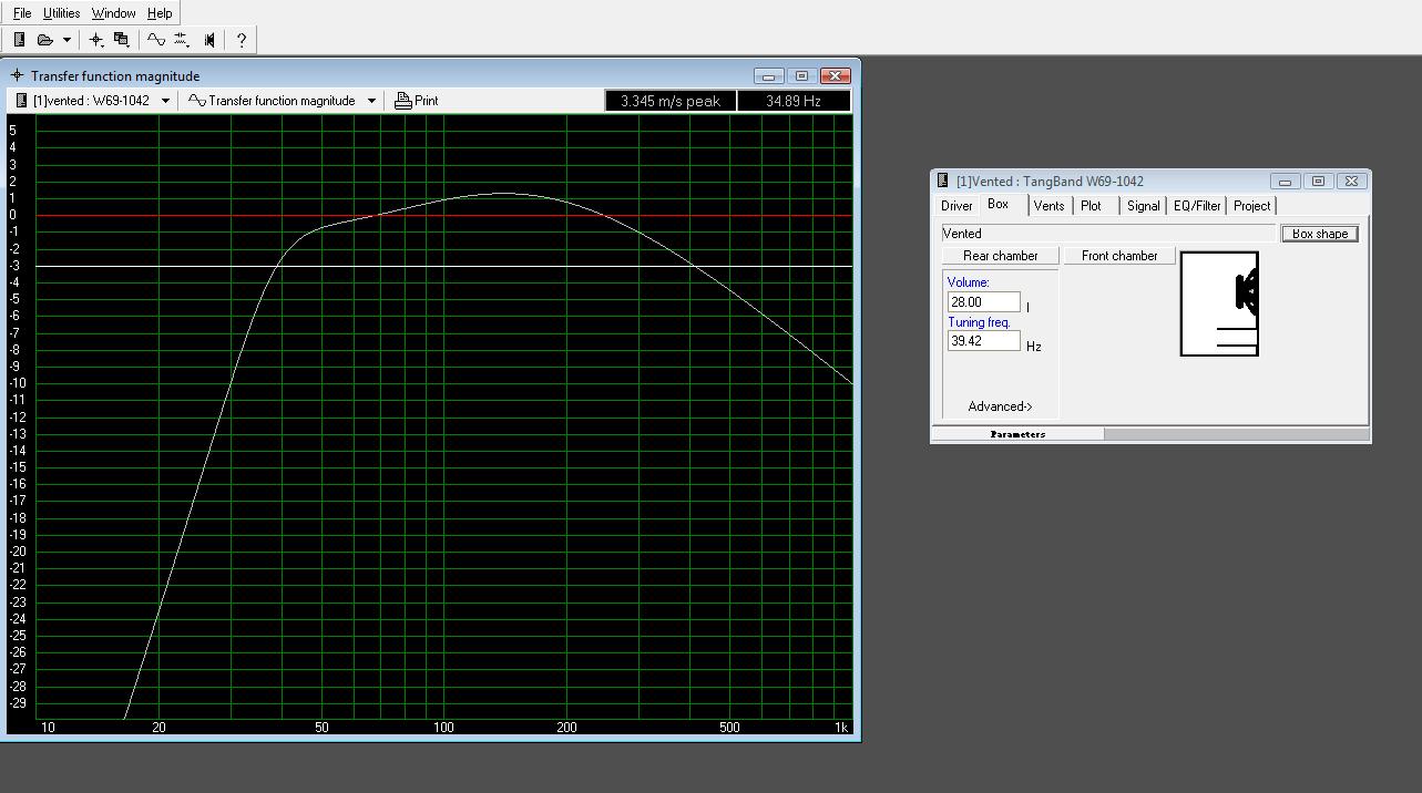

Decided to use a Tangband W69-1042 with following results:
Volume = 28,00 liters
f3 ~ 40 Hz
port length = 20.00 cm
port diameter = 6.8
both WinISD and the calculator from lautsprechershop.de gave the same results.
