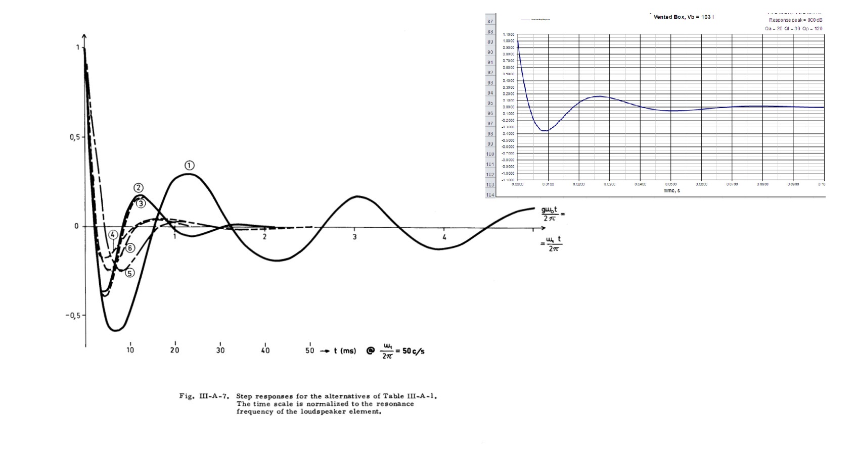

#2. Step response looks ok, but I don't know (from the top of my head what is (/yours) "minimum". Of course sealed (#6 Closed box) is better and a large BR has a nasty one (look at #1 Bass reflex Chebyshev). Your looks like a Bass reflex Butterworth or Optimal (Keibs) more like #2 or #3. You can notice a good rapport from 30/40ms, the driver is neutral and returns to it's neutral position.
Picture from pdf ""On the dimensioning of bass-reflex enclosures -- 1966_7_3_007-022""

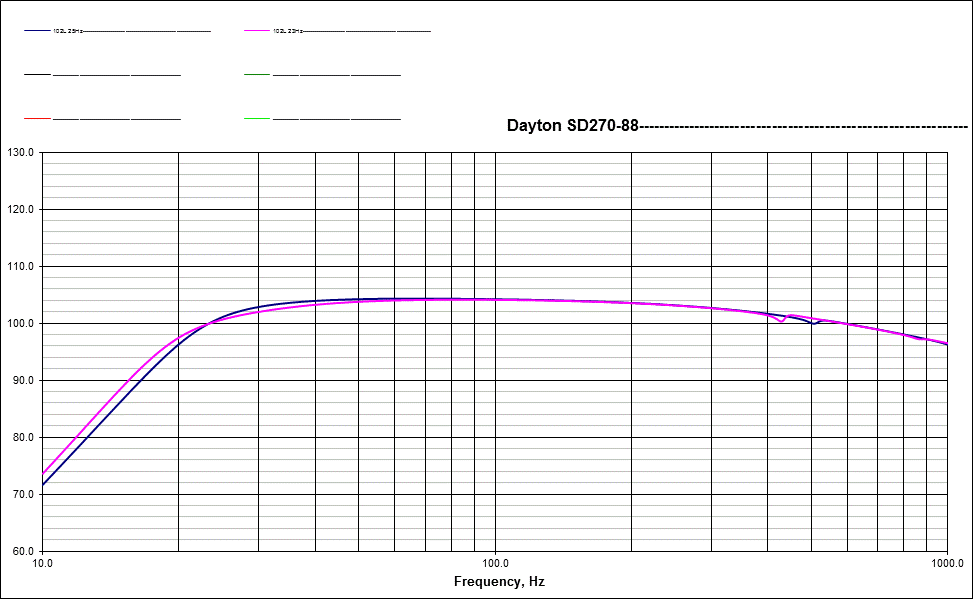

Hi Prasi, as requested I've had a look. I think what you have is a good balance. They will play low, have a nice gentle rolloff, look like they will handle your 40W target with no problem and also have a good step response for a speaker that is tuned this low.
I put your figures into unibox. I might tend to go for a slightly higher tuning freq of 25Hz (all other things remaining as you have them) but there is very little difference in reality. Slightly flatter with slightly lower F3 (but with ultimately steeper rollof) and possibly slightly better step response (though it is marginal).
The tradeoff is that the point where the driver excursion starts to increase rapidly is slightly higher.
Are you going to use the correction factor (as per Troels site) for the port length? I believe you took that into consideration with your first speaker from memory.
I've attached the spl comparison to show that there is really very little difference 🙂
Tony.
