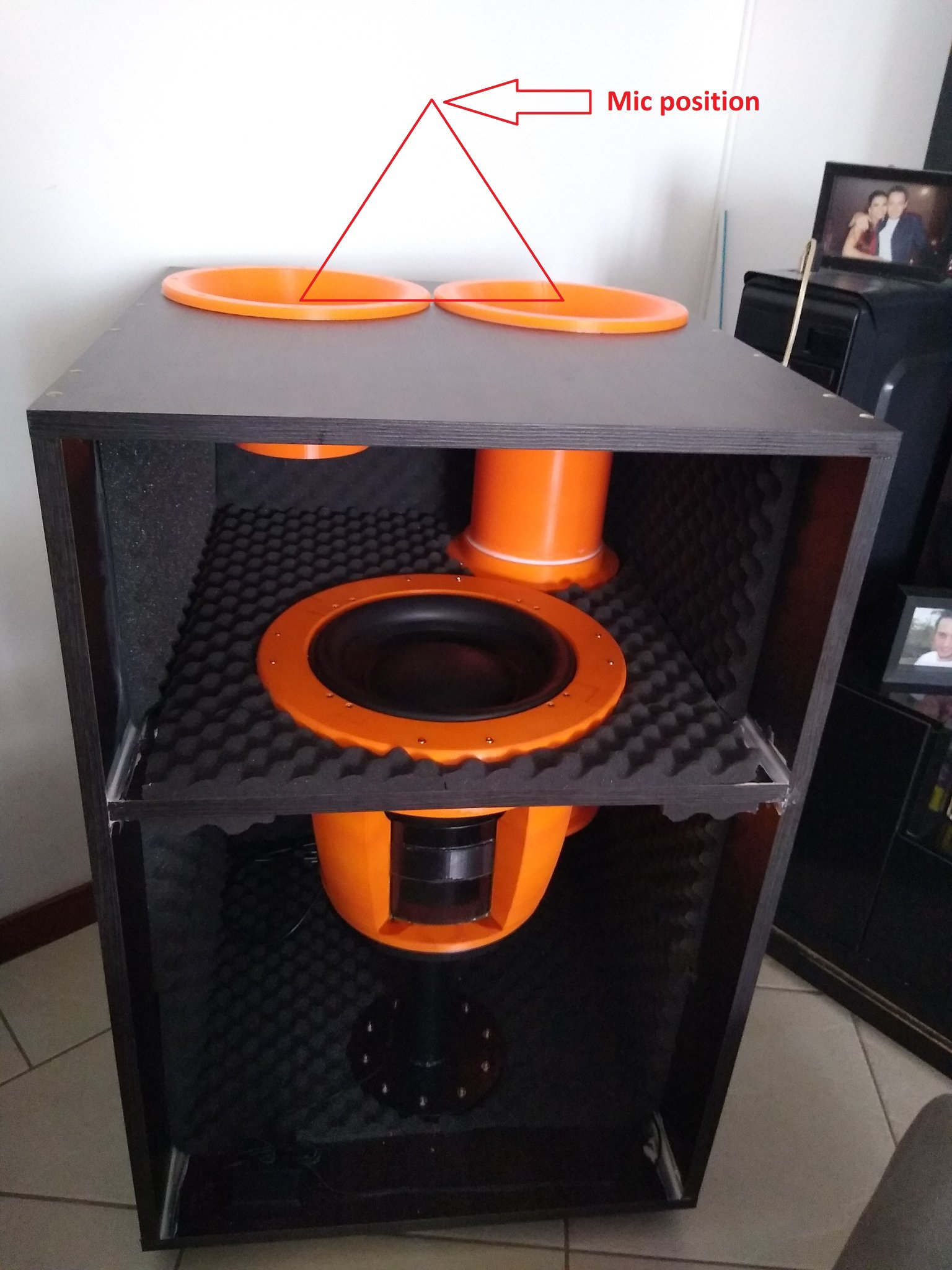

I'm here to share with you guys my latest project: A DIY NdFeB-based Subwoofer with 3D printed basket in a 6th order parallel-tuned bad pass box for my first home theater!
I'm from Brazil and my English grammar skills are not great, so be patient.
This project was made from scratch, starting with the mathematical modelling of the magnetic circuit. After the validation of the set of equations that relate the magnetic flux density in the gap and the magnetic circuit geometry, I wrote an optimization routine in Mathcad that gave me as a result all the construction parameters for the magnetic circuit, including coil diameter, wire (AWG), number of turns, number of layers, gap height, etc. as a function of the input parameters. Those parameters was the subwoofer Xmax, defined as 25mm (in one direction), coil DC resistance, etc.
The next step was to design the subwoofer itself. I used Autodesk Fusion (like Solid Works). After the mechanical design, I 3D printed the basket in a Creality Ender 3 Max, capable of printing 30x30x40cm. The magnetic circuit was made using 1020 low carbon steel, with a Zinc galvanization.
To build the coil, I started building a winder machine using a bicycle hub and my 3D printer. I made the coil using a 3D printed mold, a 0.2mm Kepton sheet and a high temperature epoxy resin.
After that, I started putting all the rest of the pieces together (dual damper system, coil, cone...).
With the subwoofer completed, I used a simple resistor-based circuit in my SPEAKER OUT and LINE IN jack of my PC sound card to obtain the Thielle-Small parameters using REW (Room EQ Wizard). This works like the DATS device from Dayton Audio, but much much cheaper.
With the subwoofer parameters, I designed a 6th order parallel-tuned band pass, from 20Hz to 100Hz using Bass Box software.
Well, some of the construction photos and the final result are shown. I also 3D printed custom ports and frames for the acrylic windows.
This is just the subwoofer, I build also 5 other speaker boxes for my 5.1 system, but this is subject for another post.
I hope you like, and if you want to see more of my projects, or more photos and videos of this particular project, follow me on instagram: @insanity_bass
If someone have any questions, I will be happy to answer.

Did you measure the performance of the built 6th order BP subwoofer, to see if it matched the predictions of the model?

The only trustable measuring that I did was the system impedance, that was pretty close to the Bass Box.
I have a UMIK-1 from MiniDSP, but my living room are too small for a measurement even in near field, so the measurement (especially for low frequencies) are a total mess. Maybe someone here can give me some tip to overcome this issue...
One thing that I was very impressed was the performance of this subwoofer in very low frequencies (like 20Hz) compared to other subwoofers that I tested before. Since it can achieve very large excursions and the box itself is very large, I can feel the bass in my chest every time I put some test tones in the range of 20Hz~30Hz. I'm truly happy with the result.

That must be a REALLY small living room, LOL.my living room are too small for a measurement even in near field
"Near-field" measurement is done with the mic only a few mm from the DUT (i.e. the speaker's cone if it's a sealed alignment).
You could always try the transfer function approach, which basically involves using a "reference" design which could be a simple sealed subwoofer EQ'd to be flat over the passband of interest (usually 20 Hz to 200 Hz), measured nearfield. Measure it at the listening position, and use the nearfield measurement and the listening position measurement to derive the "transfer function". Then, put the replace the reference subwoofer with the one you want to measure, measure it at the listening position and use REW's measurement tools to remove the transfer function. The end result should be a measurement that's a pretty close match to the theoretical nearfield measurement of the device.

Sorry, what I was trying to say is that, for me (and correct me if I'm wrong) the right way to measure the 'near field' is putting the microphone in the position described in the picture, forming a equilateral triangle with the center of all ports, since putting very close to the mouth of just one of the ports are obviously the wrong way.
When I did that, the measurements vary too much with the box position, showing (I think) that the environment contribution to the overall response is very prominent.
The idea of using a reference box is really good! Maybe I'll try it someday.
