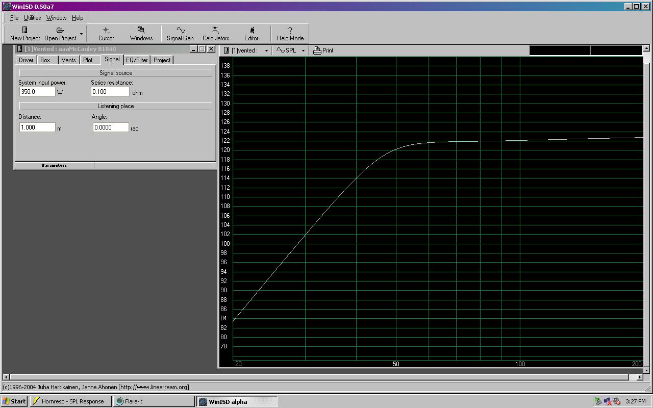

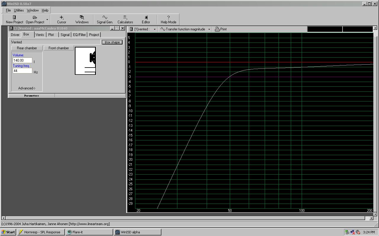

Some skecth up.
pricing is ok?
Its 160 liter box and 45hz tuning(4Hx53Wx15L,cm)

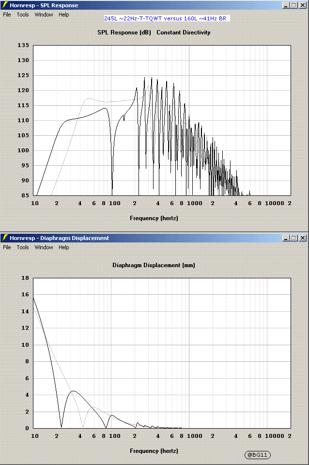

I don't know what you are after or your budget so you are the only one who can tell if the price is OK.
If for:
1. A sub for instrumental reinforcement(PA, Live)or:
2. A sub for solely music at home or:
3. A sub for HT/music.
If for HT/music use in your home: I would build a T-TQWT, of course,
but if for music at home I would brace the box way more than you show in your picture here above.
b🙂
