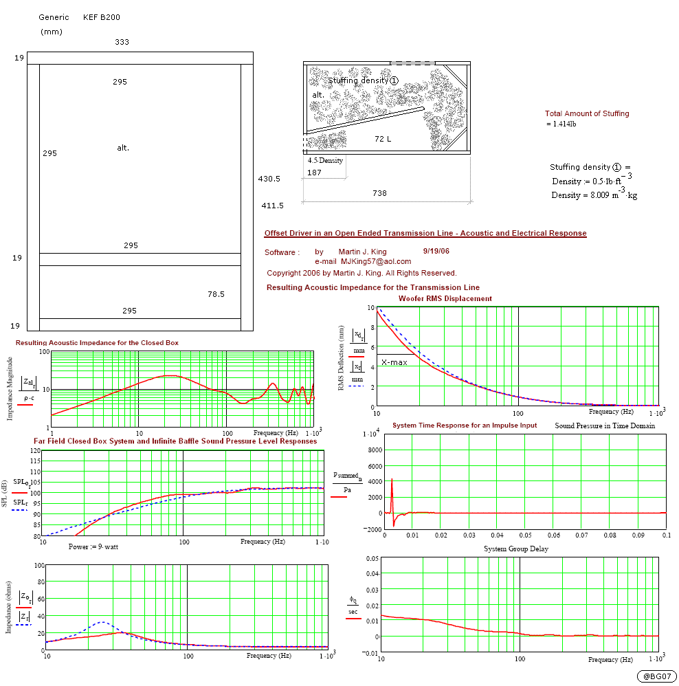

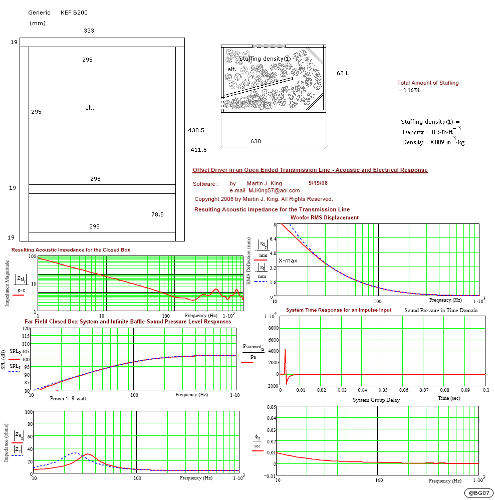

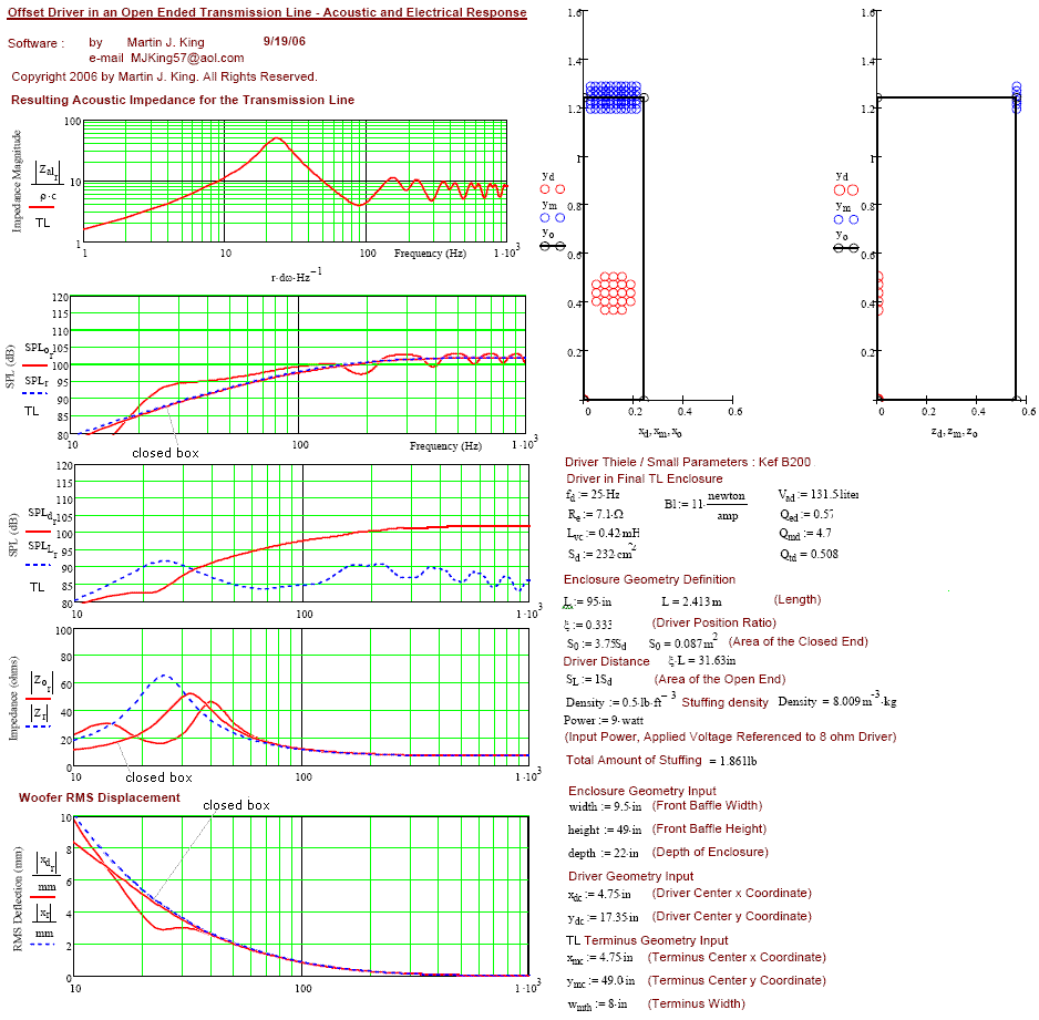

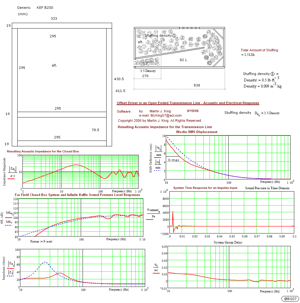

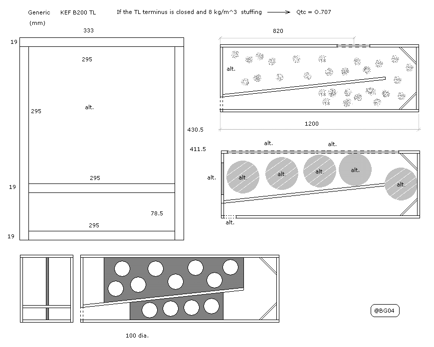

Agree and suggest that if you include the effect of box enlargement from the stuffing, its possible to use about 15% less, e.g. if Qtc = 0.707 is the goal for B200 then the volume should be about 142.6 L - 15% = 121.2L + bracing volume = 124 L.
I dug up a TL I have made near a dozen of (1970-1980) since B200 could be purchased.
It may be used as a closed box or TL and if used as a sub lower than about 120 Hz, you can place the driver/port almost anywhere on the baffle.
b
1(2)

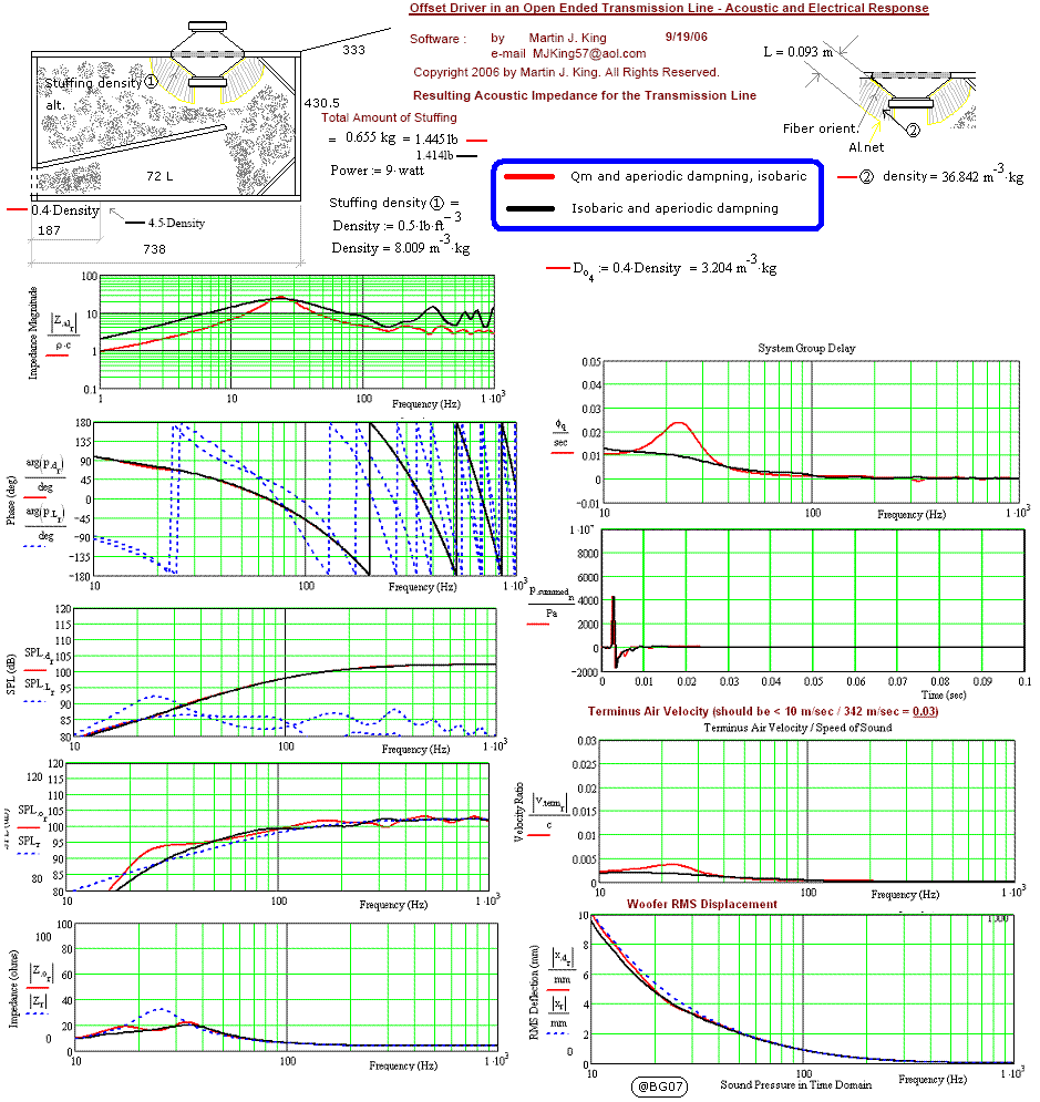

If one closed box is sufficient and since you have 2 drivers there is also the possibility to mount drivers in isobaric configuration (face to face) and half box volume requirements.
But one box and low displacement capabilities will limit sound pressure.
I was hoping that you had one the lower Q variants, yours is box volume demanding as pointed out already.
If size is tolerably, bjorno's TL would probably give the best overall results for your driver.
FYI: added Acoustic dampening to the aperiodic and isobaric B200 box.
Acoustic Qm dampening applied close to the basket of a driver is the best of all methods to for lowering the Qt of a driver in a box.
All other methods suffer from more efficiency and bandwidth loss when comparing (Richard Small).
b
1(1)
