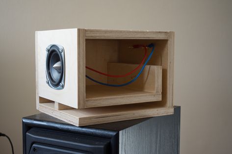

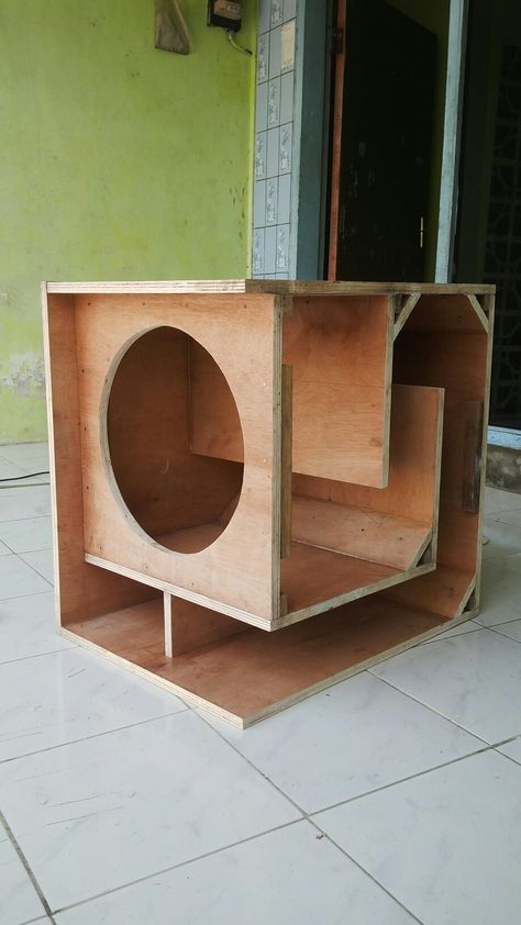

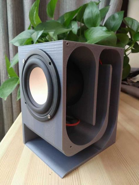

Thanks fo your suggestion. Its interesting and I will think about it. It would certainly be easier to design.
However, I have been looking at these designs and I thought that I could do something similar to them but the enclosure would be a sphere. Unfortunately few who shoot their project rarely puts in their acoustic results. What do you think of them as designs?
I also thought about buying black drainage hoses (4-5" diameter) to fill the interior of the sphere. Possible??
