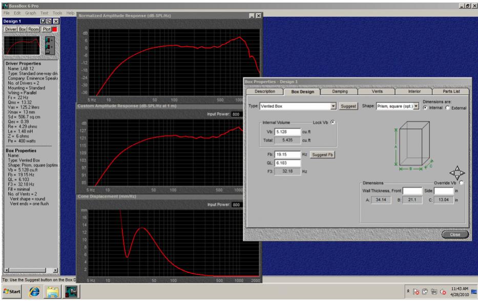

well I want to have home sub-woofer that has 12 inch and over 1200w at 4ohm load what could you suggest me to have or is there something could fit to be best in home use?
A pair of Eminence Lab 12 (6 ohm nominal) would be 3 ohm in parallel, handle 800 watts without exceeding Xmax.
The design may end up fairly flat in a corner or by a wall.
If you raise the Fb to 36 Hz, the F3 is 31 Hz and response very flat.

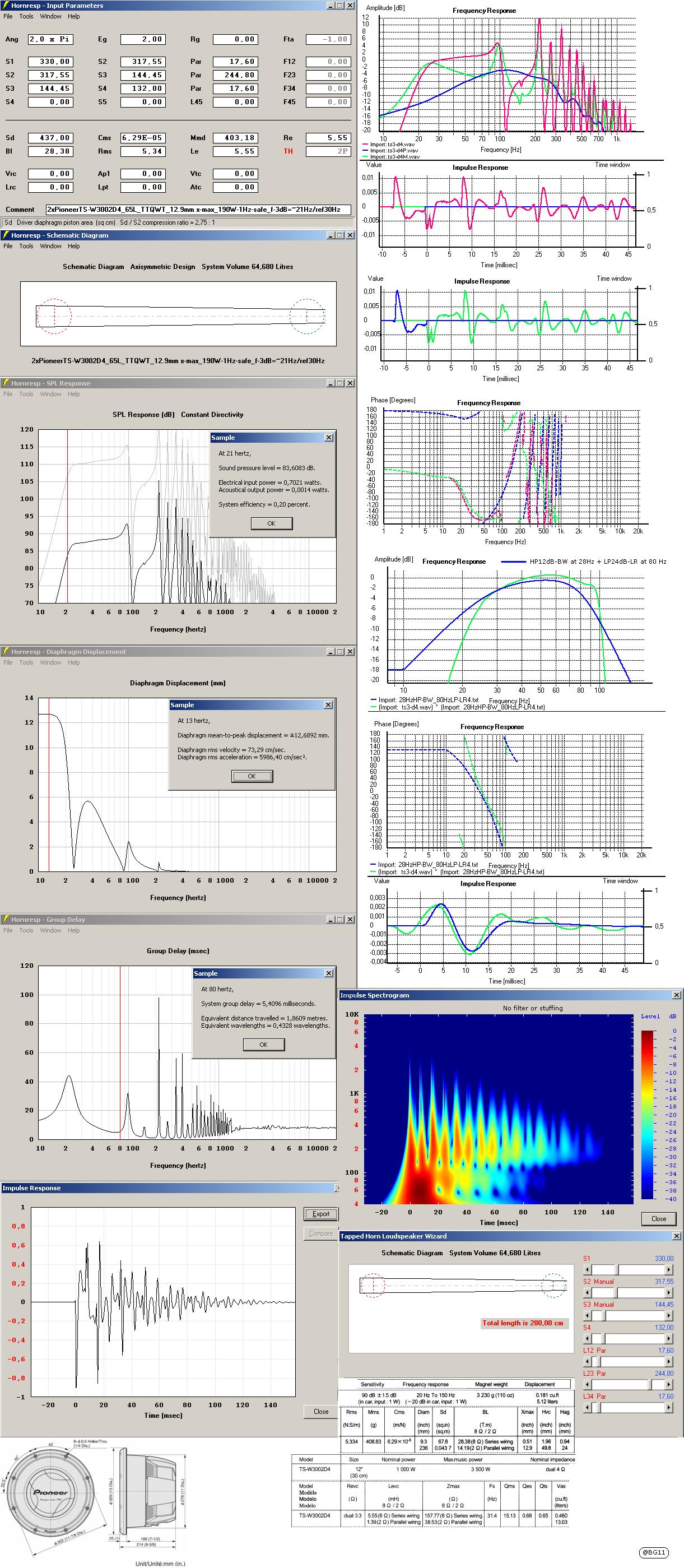

but I can't have Eminence Lab 12 because its not available here. could I use Pioneer TS-W3002D4 instead?
Hi, Using the Pioneer TS-W3002D4 car driver: Would IMO be a challenge to fold, but could if seriously worked(not screwing the shown CSA:s) out to be a very good T-TQWT performer if not driven to hard:

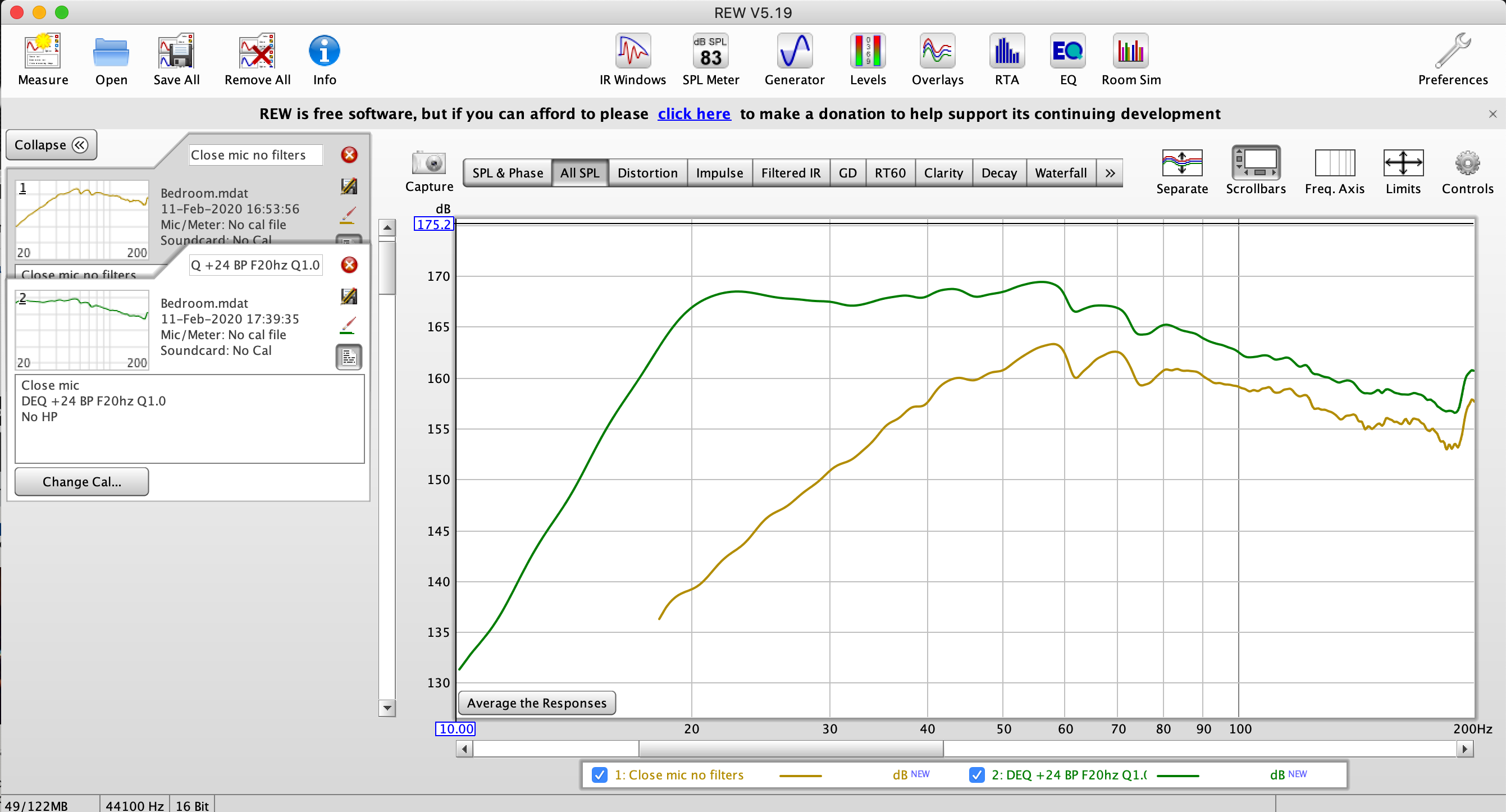

JBL CS1214 are very good value for money if you can find some. Here you can see real world graphs of close mic response of the sealed ones I have built (ignore SPL). They are spot on the modelling software results. I have a thread in another forum but I am not sure if I am allowed to link.
I have 8 of these which theoretically can surpass 2x Ultimax 18-22. If you are short on space these are great ported. These are also cheaper than wood so going multiple may be desired.
