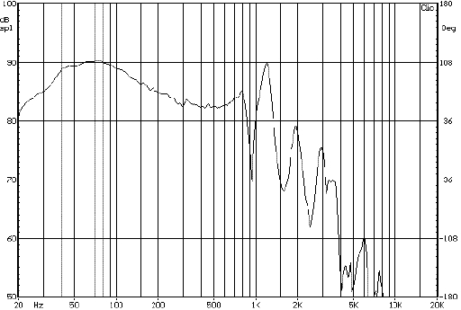

Also on the White Paper, Parts Express provides a chart of the Titanic 10 Mk II's free air, (unenclosed), response. Subwoofer crossovers routinely go up to perhaps 200 Hz. Not this one. It has a natural 6 dB/octave rolloff after 80 Hz. An interesting point is that if you wanted to hook this up on a passive crossover, (which I am sure you are not), all you would have to do would be to add a choke in series to get a 12 dB/octave filter. Anyway, I enclose the response graph. Boy, they really DID intend this thing only for subwoofer use!

For this reason, I like to go by "rules of thumb" and general judgment. For most 10 inchers, a 3 inch port works fine, for 15 inchers, go to a 4 inch port. The Titanic 10s move as much air as many a "long throw" 15 incher, however, so the larger port would be indicated. I figured the flared 3 inch port would approximate a 4 inch port, but I have no evidence this is so. Various audio reviews have stated that systems that use flared ports exhibit less port noise than you would expect from a port of a given size, I know that much. Thomas W, in his 6 cu ft enclosure for a Blueprint 1503-a driver with a 2 inch front-to-back excursion-said to use a flared 6 inch ports or unflared 8 inch port, which would tend to indicate an equivalence of sorts. So the flares must actually work.
