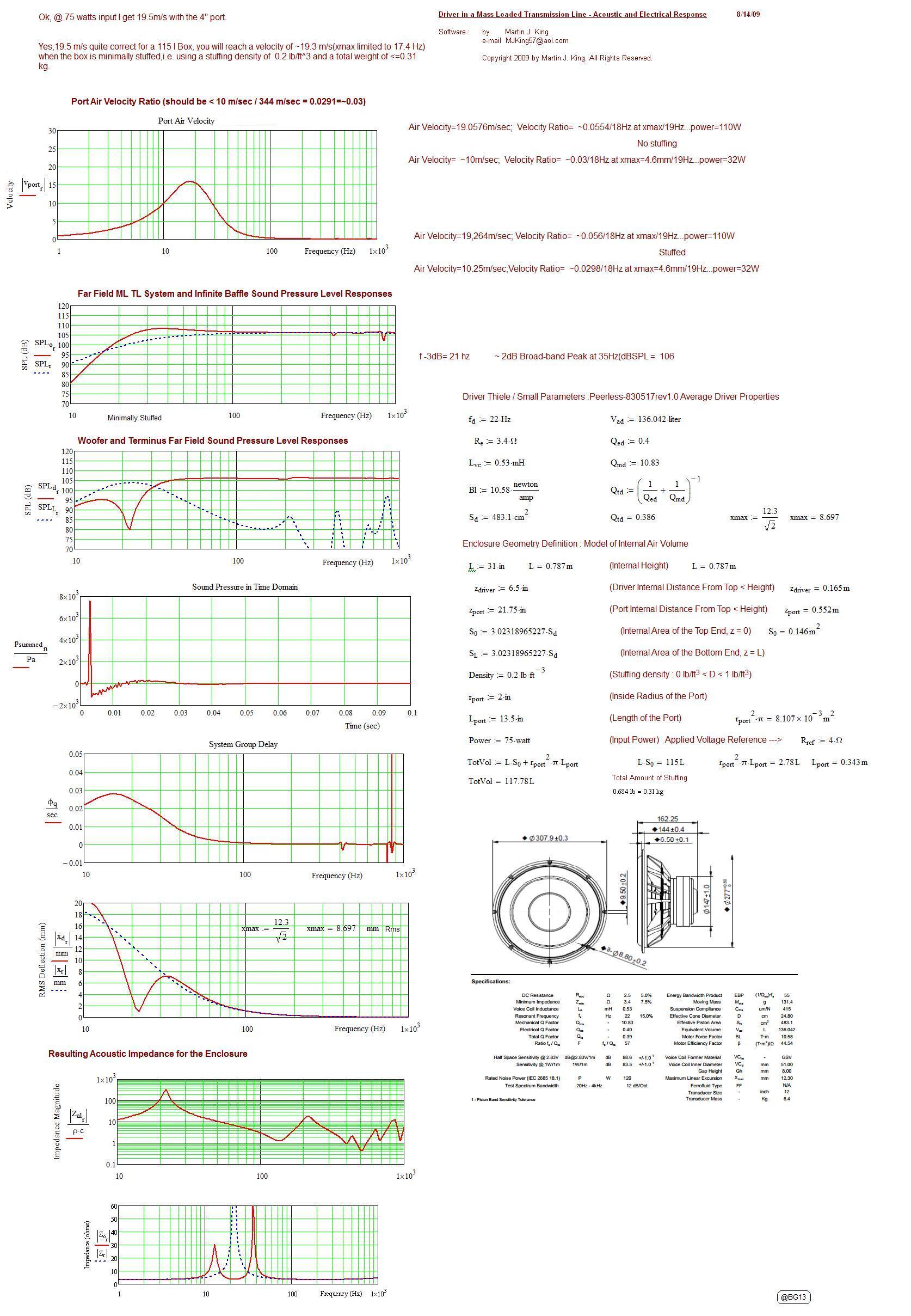

In theory, a ~115 L/22 Hz Fb alignment @ the ~175 W X-max limit @ ~ 32 Hz requires a 5" dia. vent. [min.] to get a 'close enough' 5% vent mach and dual 4" to get below it.
Flared vents help at the expense of needing to be longer, though won't lower it as much or need to be as long as a 5" dia.. Not many 'free lunches' in audio design.

GM confirms pretty much what I thought too by my simulations. (a 4.5 inch minimum dia port in theory) Thanks 🙂
Regarding WinISD, I have been playing around with the figures, but this is the first project I'm using it for, so I'm learning.
In my simulations the cone excursion is still controlled (at least above the tuning frequency) at 175w and the maximum port velocity at that same power level is 30m/s with a 4" port, 19m/s with 5" port and 13m/s with a 6" port.
The length of the 5" and 6" ports however are impractical anyway.
I've decided to get the 4" precision port from P/E and try that.
As mentioned, in practice it will probably be enough.
If not, I can always enlarge the hole later. 😀
Again thanks for all the help 🙂

Ok, @ 75 watts input I get 19.5m/s with the 4" port.

No,19.5 m/s is not correct for an 115 l Box, At 75W(Rms):
The Port velocity will reach 46 m/s and xmax limited to 17.4 Hz.
Max input Power is ~32W(Rms) for not to exceed a Rec. Max Velocity = 10 m/s) when tuning at ~22Hz and when the box is minimally stuffed, i.e. using a stuffing density of 0.2 lb/ft^3 and a total weight of <=0.31 kg.
Data collected using MJK program: f -3dB= 21 Hz; A ~ 2dB broad-band Peak occurs at 35Hz and at 2xPI (Sr) the dB-SPL is about 106/ 75W/4Ohm.

...No,19.5 m/s is not correct for an 115 l Box, At 75W(Rms):...The Port velocity will reach 46 m/s and xmax limited to 17.4 Hz.

Hi, MyPosted Air 🙁 Velocity =46 m/sec is totally wrong...~19.5 m/sec is correct and worth at least:

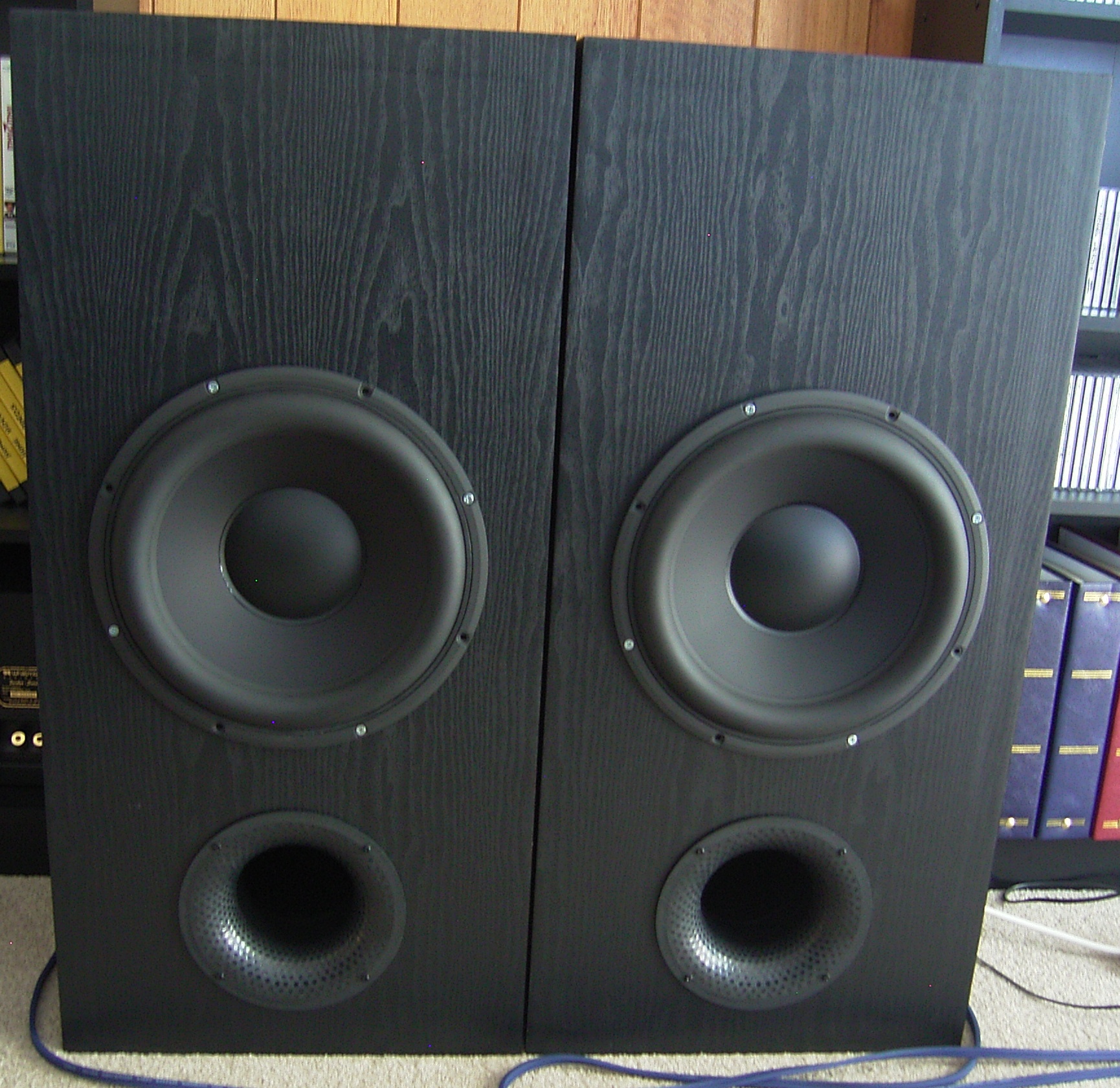

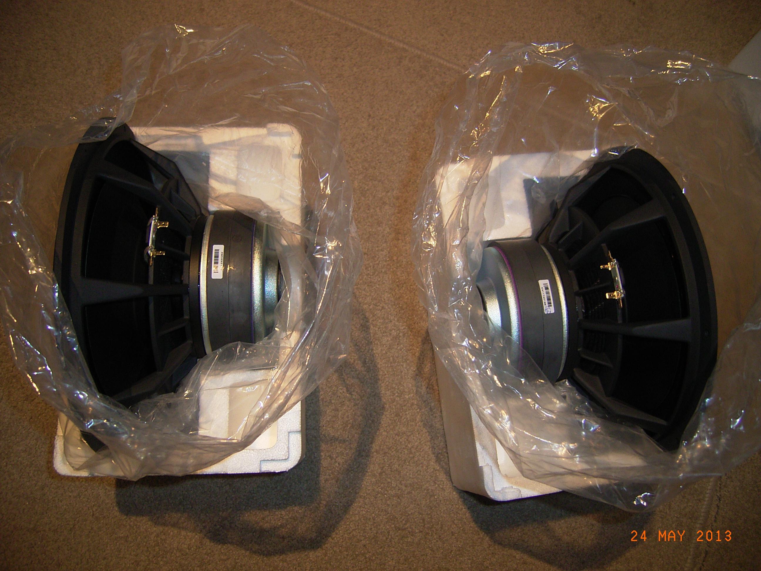

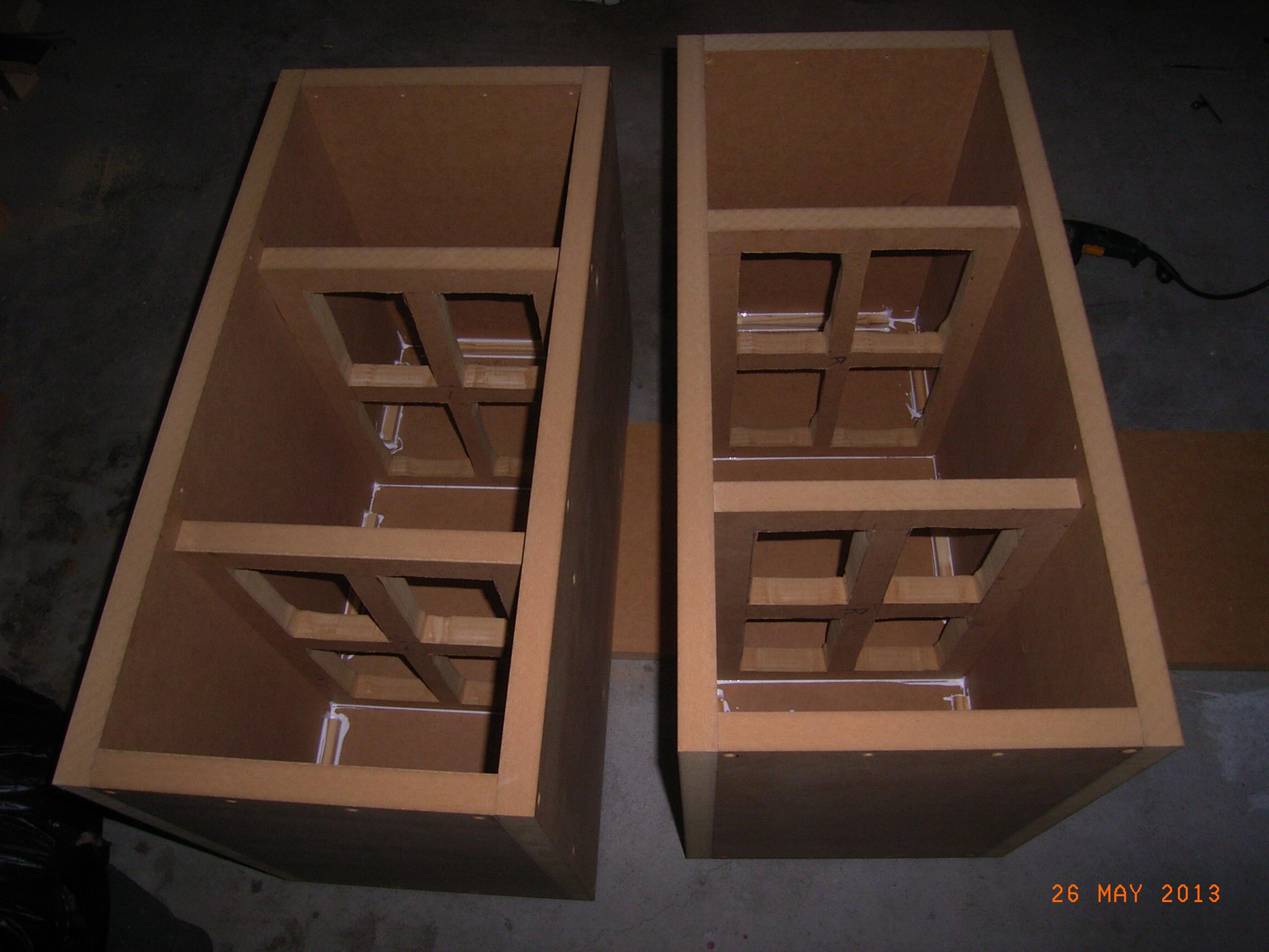

Only a few, I didn't take that many, but here's a summary of what I've done.🙂
That dimpled 4" flared port a la B&W looks great (and is needed here), heh-heh?!
Driver is not installed in the middle of the baffle, is it? It looks like from this perspective.
It looks great overall. Kudos. 🙂
Thanks 🙂
It does look like it from the photo, but its about 2.5cm offset towards the top.
FB is currently 21Hz with no insulation inside.
