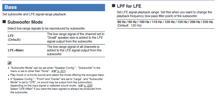

I can´t find a connector called "subwoofer signal out", only menu settings referring to it, and apparently speaker out from its internal power amp(s). can you please show it here?Yes I have a multimeter what do I measure and where?
Because normal procedure is to feed the sound source an audio tone, here you would play back:
https://www.mediacollege.com/audio/tone/files/100Hz_44100Hz_16bit_30sec.mp3 ,
set output to maximum possible and measure what signal level (in millivolts) you have there, available to drive the power amps.
From another posts I read 1.2V=1200mV RMS are needed to fully drive those amps, we are checking if you reach that or not.
Well ladies and gentlemen I got it. Lfe + Main made a huge difference. It works flawless. Thank you everyone for your help. I check the voltage on lfe alone and was not getting 1.2v changed it to lfe+main and now getting 1.2v. Not sure why but it sounds great. Thanks a million times over. I can plan a movie night this Friday for the kidos. Also I will be changing these rca out for rca to 1/4. These rca are old and not shielded.

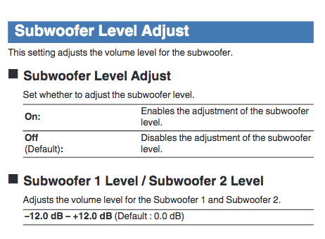

Long shot but might it be VU insteal of dB? 0 VU is -12dB (according to my Behringer DEQ2496's meters)...The level lights are -12, -6, 0, +6, +12 and clip, an unconventional labeling scheme, normally the last indicator light on an amplifier before clip should be "0dB".
Each increase of 6dB should be equivalent to increasing power by 4 times.
Assuming the amp can produce 375 watts per channel into 8ohms at clip, the indicator lights should indicate reaching these power levels:
-12 =1.46 watts
-6 =5.86 watts ("2 notches up")
0=23.435 watts
+6=93.75 watts
+12= 375 watts
At "-6" on the NIX-6000X4, your sub is about -18dB from what it could produce at full power. -10dB sounds half as loud, so what you are hearing is about 1/4 as loud as it would be if the amp was driven to it's potential.
The Marantz SR6011 is capable of only 1.2volt output, 3.8dBU.
I could not find any specifications on the NIX-6000X4 other than output.
It is possible the NIX-6000X4 amp may require a +12 dBU (about 3volts RMS) input for full power, which would require an additional pre-amp ("line booster") to achieve.
Run a 60 Hz sine wave into the SR6011, measure the sub output level at the end of the RCA cord with a voltmeter to determine if it is reaching it's full 1.2volt output before purchasing a pre-amp.
