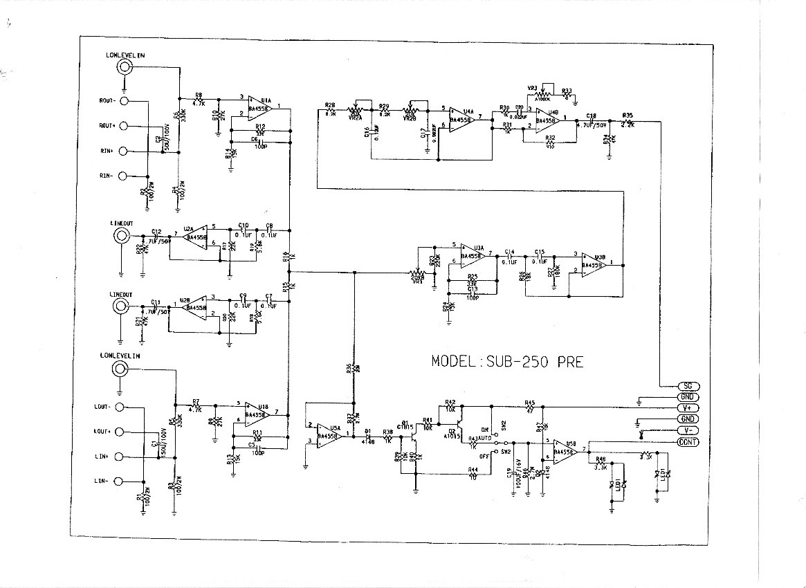

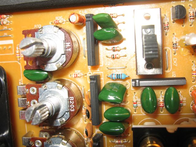

Hello
greetings anybody know the vaue of pot V3 in schematic as all 3
pots need replacement .Value of pot HT written on it.
warm regards
Andrew

ANyway, the resistance is stamped on the pot wafers on the center pot as that top wafer has legs down to the circuit board. As I look at the HT one, I see no legs for the circuit board. Since you plan to replace the pot, perhaps remove it from the board to see is a value is printed on the other side. I cannot see from here, but I assume the lower wafer has some legs to the board?
What is wrong with it that it needs replacement? Does that preclude measuring the part?
I can't quite read it but on your schematic it appears to me like it says 1000k, which is 1 meg. And A for audio taper.
