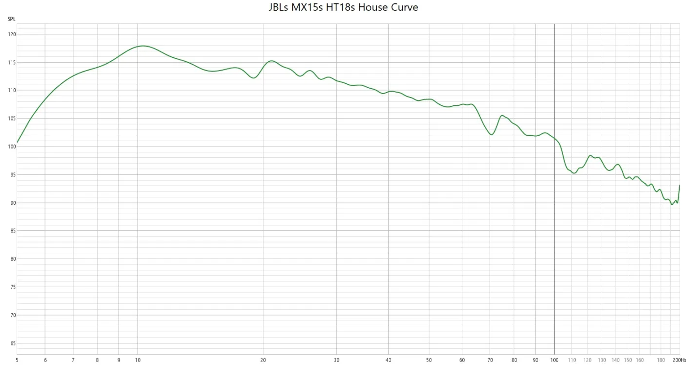

Going floor to ceiling won't increase the low frequency output compared to 2 wide by 3 tall in a 3' tall speaker enclosure.
