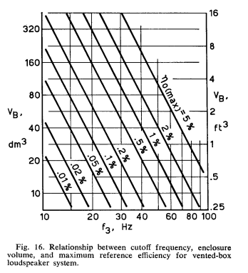

Yes, as BJ noted, when it's time to go low and/or loud there's 'no replacement for displacement'! ;) Physics, it's the LAW! :D
See attached below the vented, sealed box sizes Vs eff. [SPL] limits we're stuck with and conversions here to see how inefficient a 3 ft^3 [net] box is down low: Efficiency and sensitivity conversion - loudspeaker percent and dB per watt and meter loudspeaker efficiency versus sensitivity vs speaker sensitivity 1 watt = 2,83 volt box chart - sengpielaudio Sengpiel Berlin
Depends, I guess, i.e. better to have an outboard controller for the entire system than just an amp with limited DSP.
Yes, there's some drawbacks with driver, cab construction, amp costs being a major one for many DIYers, especially for HT when wanting to meet THX LFE reference down to 20 Hz and especially below it down to < ~10 Hz for movies with serious LFE content: The Ultimate List of BASS in Movies w/ Frequency Charts - AVS Forum | Home Theater Discussions And Reviews
Well, a bass system [LFE] is by definition 'slow' ;), it's the mid-bass - up system adding its harmonic structure that defines the LFE's 'speed'.
That said, the room's acoustics dominates down low, so if the LFE system isn't designed to blend with it you can wind up with 'boomy', 'slow', 'sloppy', etc., bass that can 'ring' well up into the mids where our hearing acuity is getting good enough to discern 'coloring', etc., of vocals, plucked strings, etc., so the lower a soundtrack goes, the more critical it is to get it right since the lower the frequency, the wider its BW, a point that until the advent of relatively inexpensive DSP, many folks mostly ignored even if they knew it due to not having an easy way to time & phase align subs to the mains.
